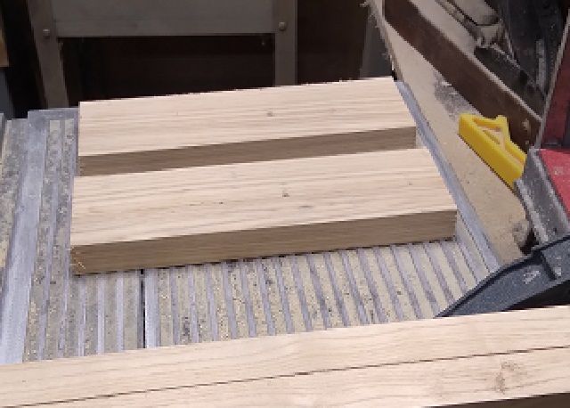

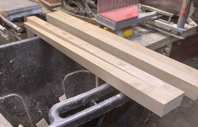

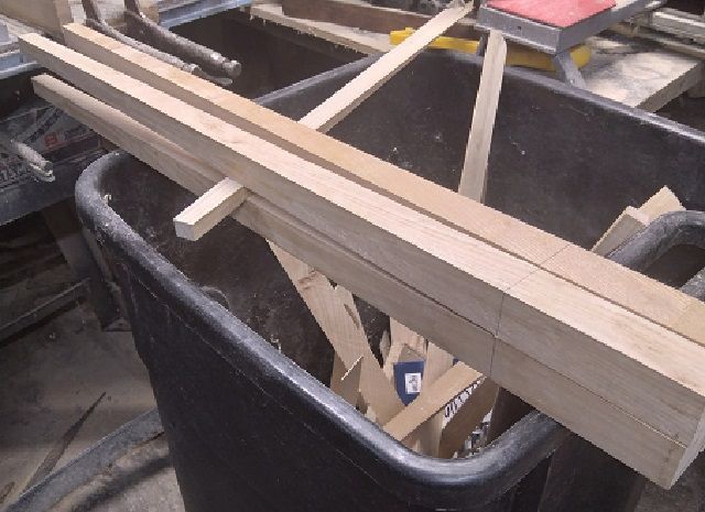

Blanks for Table legs...working around all the bad spots:JawDrop:
As I am not a "Fan" of live edges...I did get 6 blanks for the legs..need to cut 2 more..:ChinScratch:
And did a bit of glue up...:Cheer:
1st 2, and..
Blanks were ripped to 2" width..and at least 32" long...which left..:WonderScratch:
Enough blanks for a few short stretchers...we'll see...

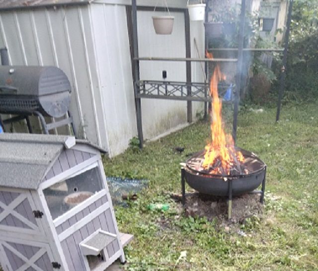

Over-full trash can was hauled from the shop, this evening..with half going here...EveningBurn7-13-2024.jpg.5287ebd05e4b77bff4c56f2047617f80.jpg
While the rest sit and waits..
Once the first batch burns down a bit....there is another can still in the shop...about a quarter full...that MIGHT be hauled up here, too...

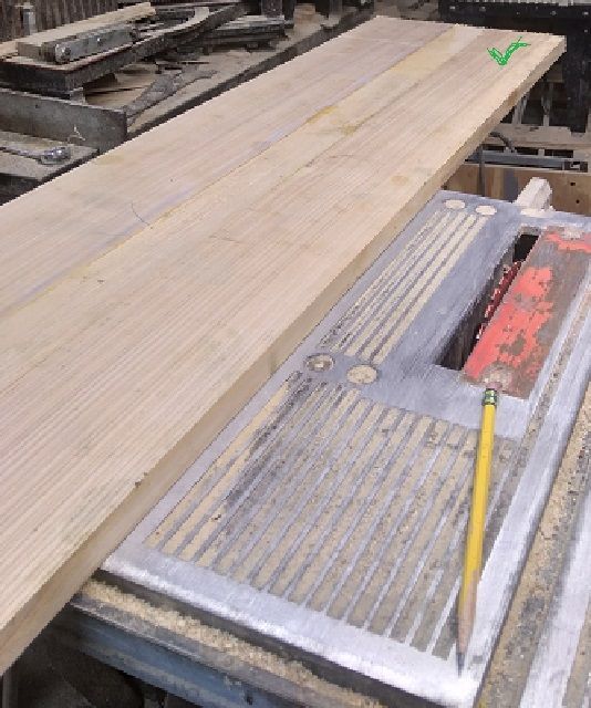

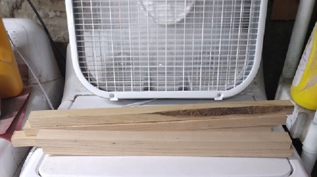

Planks #3 and #4 have arrived IN the shop...clothes are out of the dryer, and the hamper has been hauled/walkered upstairs...

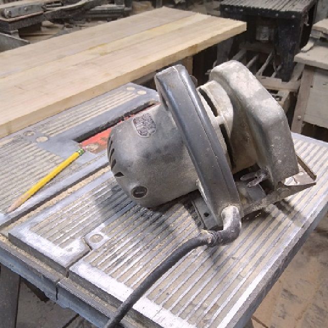

need my tablesaw back...tomorrow...

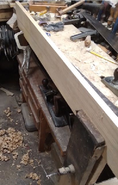

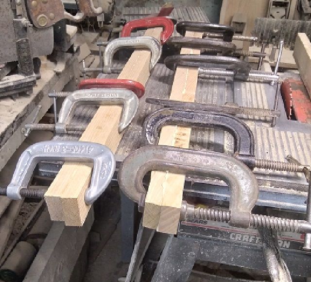

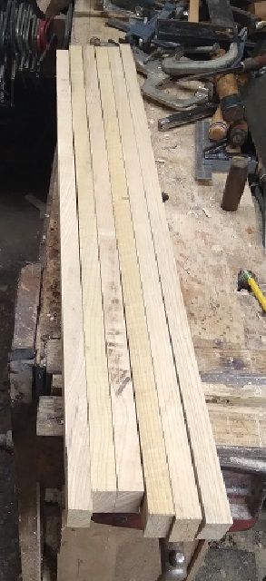

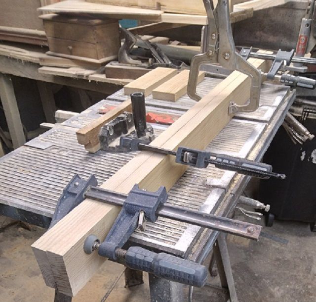

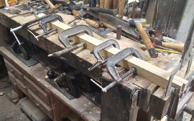

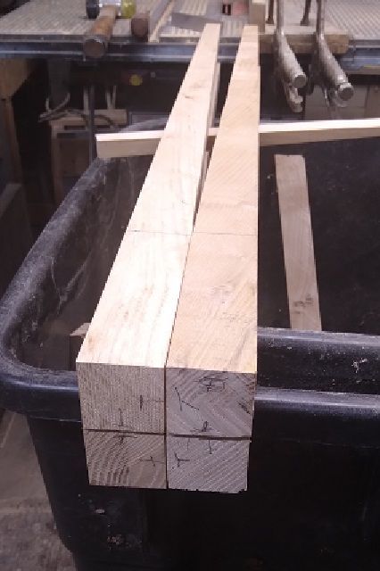

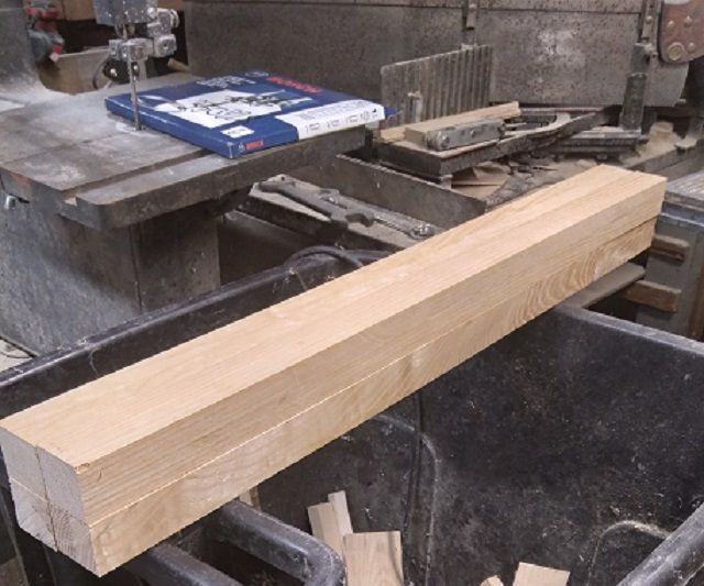

Well..legs have been in and out of the clamps..need to clean them up, and try to square them up..:WonderScratch:SofaTableBuild2legsgluedup.jpg.f3242793f35a31c0ea944ace47052677.jpg
Ends need cut square..and all to the same length..:ChinScratch:

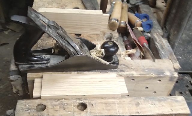

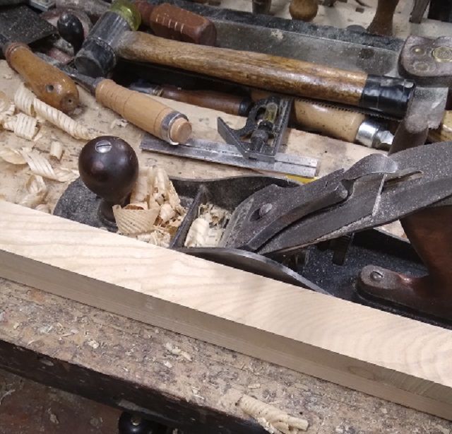

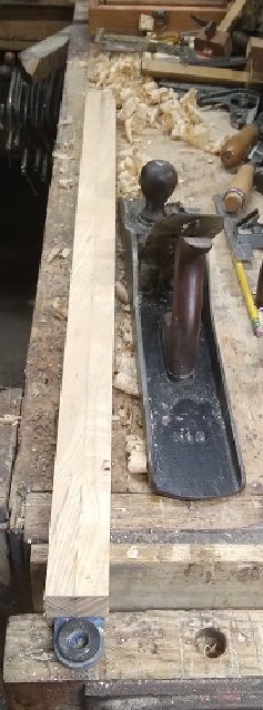

Then all 4 faces needed planed...:SaluteandRun:
Regardless of any "Difficult Grain"   :JawDrop:
Even the rough sawn faces were smoothed down..:Cheer:

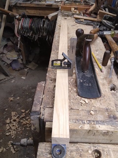

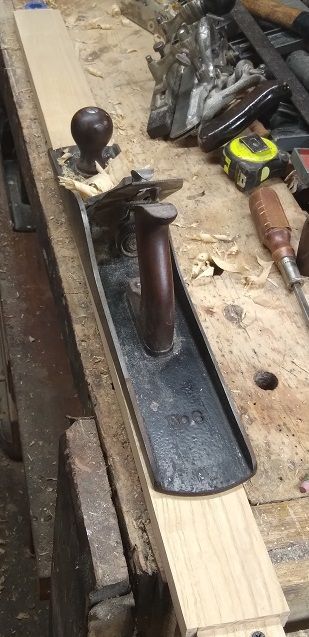

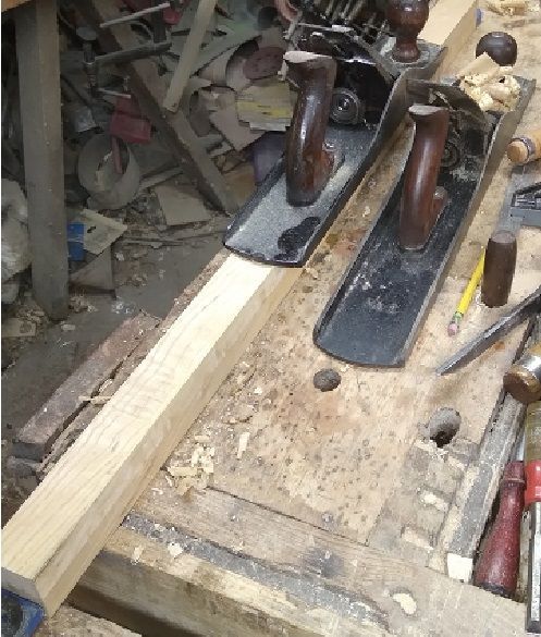

Plane is a Stanley No. 6c..from WW2 era...still has it's original iron, too..The No. 8c was a bit too HUGE, for this job..:JawDrop:
So..I went with the #6c...
Finally got all 4 legs done..:TwoThumbsUp:

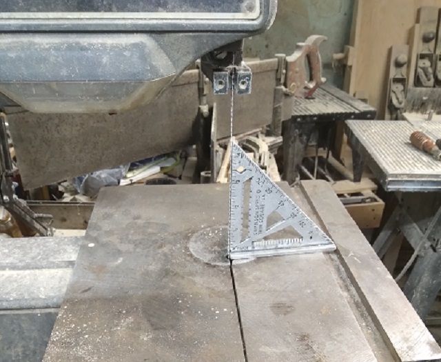

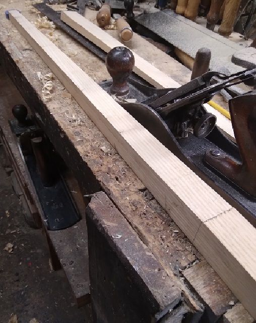

Needed a new Bandsaw blade..old one was getting way too DULL..so:SaluteandRun:
had to blow out the insides of the bandsaw,,set the table square to the blade..:TwoThumbsUp:
And make sure the Insert was NOW flush with the top of the table..because...once I mark a start/stop line at the "top" of the leg..:OldManSmiley:

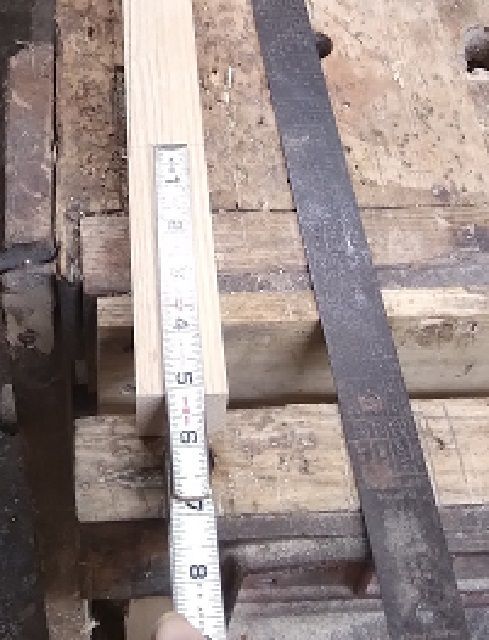

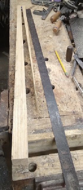

@ 5"..all the way around..then take that steel Yard Stick..:ChinScratch:
From the start line, lay out a taper..to leave a 3/4" foot at the other end..:OldManSmiley:
Try to leave the line, at least...rotate and repeat...and let a plane take over..:TwoThumbsUp:
Millers Falls No. 15, Type 3...same age as the No. 6c...Plane until all the saw marks are gone..:Cheer:
The No. 6c was a bit too long for this job...once both tapers are planed smooth..one more task..:SaluteandRun:

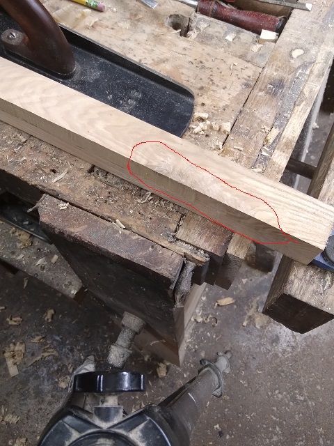

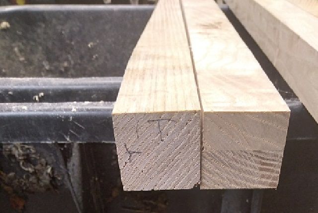

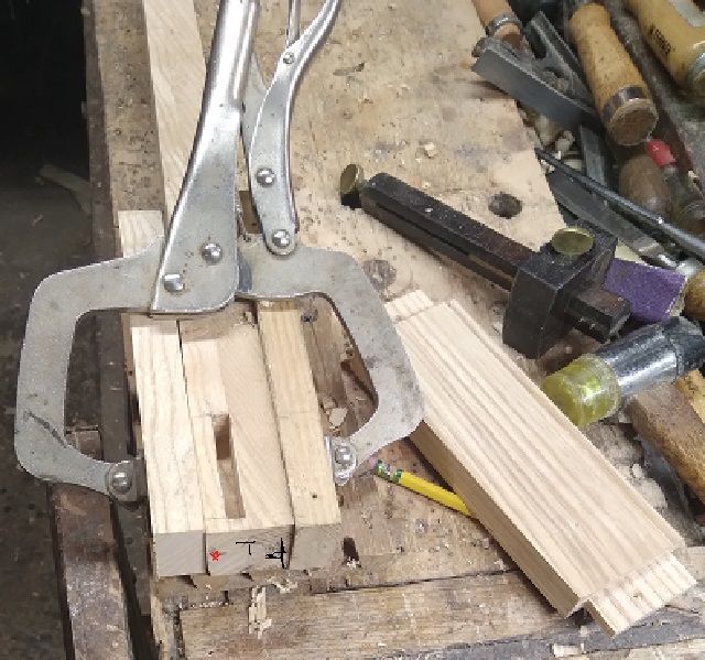

"T" is for Taper...as sometimes it gets hard to see which is and which isn't tapered..:ChinScratch:
One leg done..:TwoThumbsUp:
"Only" 3 more to do...
Stay tuned  :cowboy:

All 4 legs have been tapered and planed smooth:TwoThumbsUp:
Was undecided about one taper...:ChinScratch:
which is why there is an "extra" "T":WonderScratch:

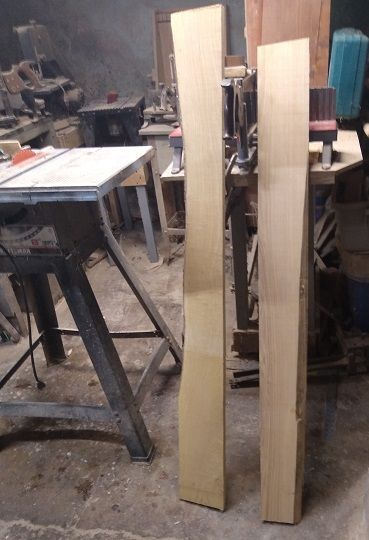

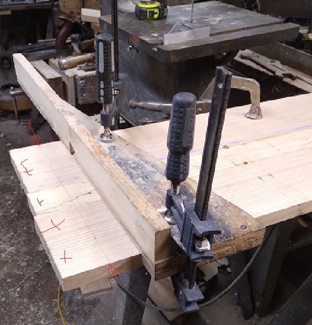

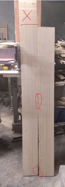

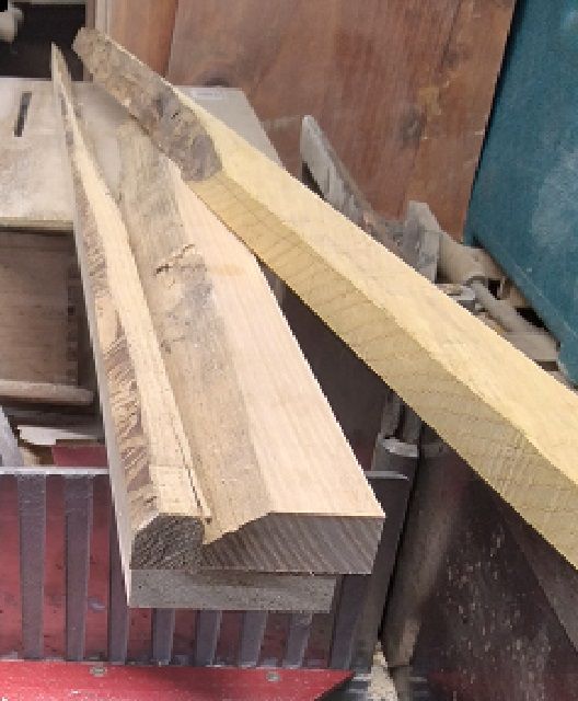

hauled these 2 planks to the shop..:SaluteandRun:
These 2 came from the same 10' long plank...that was cut down to fit in my car..apparently, there was an issue going through a planer..sniped end:ArguingSmileys:
And other issues...decided to get rid of the sniped end, and match the shorter plank...could not access the tablesaw...we have ways:ph34r:
At least the saw can cut straight..:TwoThumbsUp:
The square was going off the curved edge:BangingHead:
Test fit the 2 planks together..:Cheer:
Somewhere around 10" in width...and I need it to be 12"?  and, by the time I remove a few defects...:JawDrop:
And straighten out a few edges...I'm going to need about 3" of filler, between the 2..will have to sort through the stash of Ash..looking for grain that matches these 2...:ChinScratch:

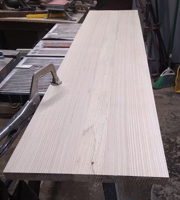

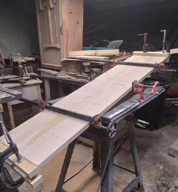

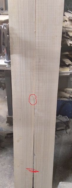

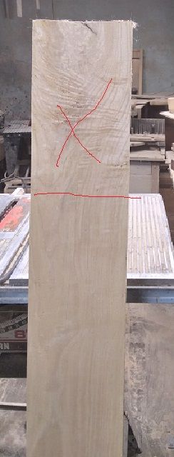

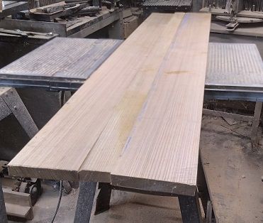

Found a match ( This batch of Ash all came from the same tree, BTW)...except...there is a split running right down the middle of the board...at an angle...left less than 3" at either end..Ripped out the middle, after I had jointed one edge...and kept the wider of the 2 "good" strips..:ChinScratch:

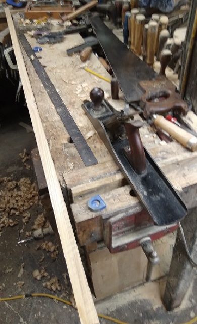

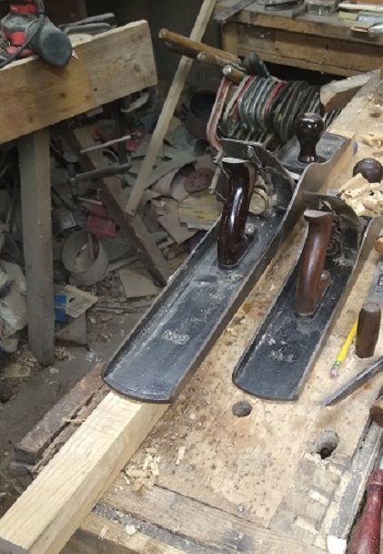

Then went to run the No. 8c jointer....only to find out..the "Stern" was sitting on the Dryer behind me, and lifting the toe enough that the plane could not get a good head of steam.:ArguingSmileys:..went back to the No. 6c..:TwoThumbsUp:
Goal being to get one edge straightened out..:ChinScratch:

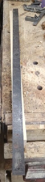

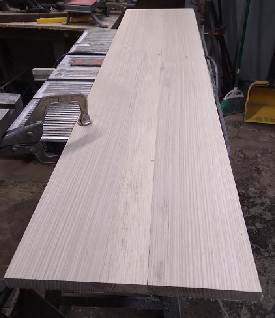

54" long runway..used that steel yard stick to find all the high AND low spots..test for gaps..:OldManSmiley:

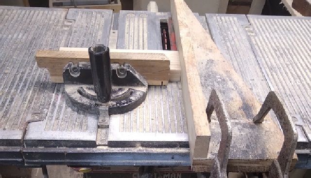

Once there wasn't any gaps, ran this one through the tablesaw, against the rip fence..trying to peel off as little as I could...repeat for the other wide plank..

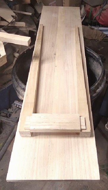

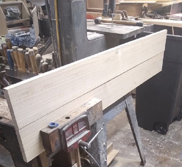

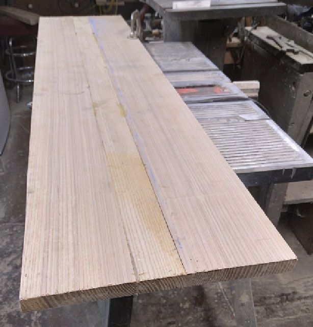

Dry fit a few times..:Cheer:

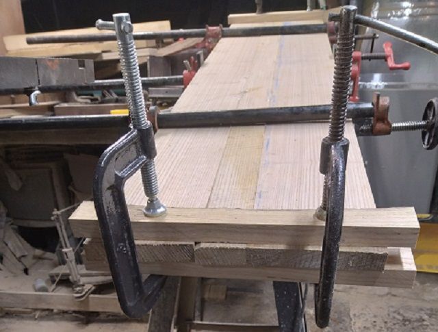

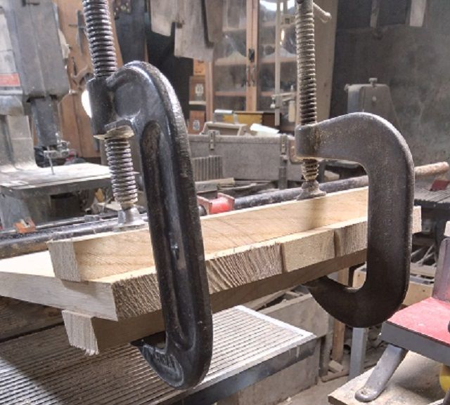

Until no gaps were found...then the clamps, glue and cauls showed up...had to rotate the mess a bit..:SaluteandRun:
one pipe clamp under, and 2 over...started with the center one, first...make sure things are flat..tighten the first clamp..then the same with the other 2...needed a hammer to "adjust"  a high spot...down on this end..so cauls were added to keep things flat..:OldManSmiley:
Down at the other end..no hammer needed, just cauls..:TwoThumbsUp:
once the pipe clamp was tightened down...:OldManSmiley:
Will let this sit a day or 3...at least I can ( Barely) stand it up and off in a corner, somewhere...:SaluteandRun:
Right now, that panel measures 3/4" x 11-1/2" x 53-1/2"...will trim the edges down to around 48-50" length..will have to live with the width..was hoping for 12".:rolleyes:
At least, once I get the tablesaw back, I can size the aprons and the stretchers....and start building the base for this top..those cauls? 2 of the better looking ones will get used as stretchers and the other 2 will become corner braces...:ChinScratch:
Stay tuned  :cowboy:

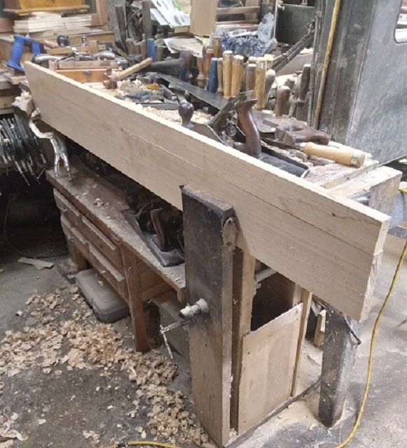

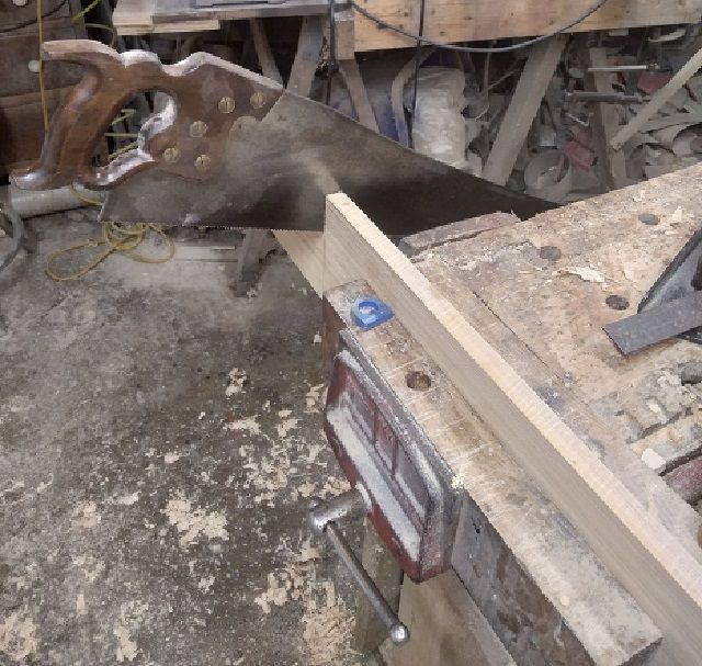

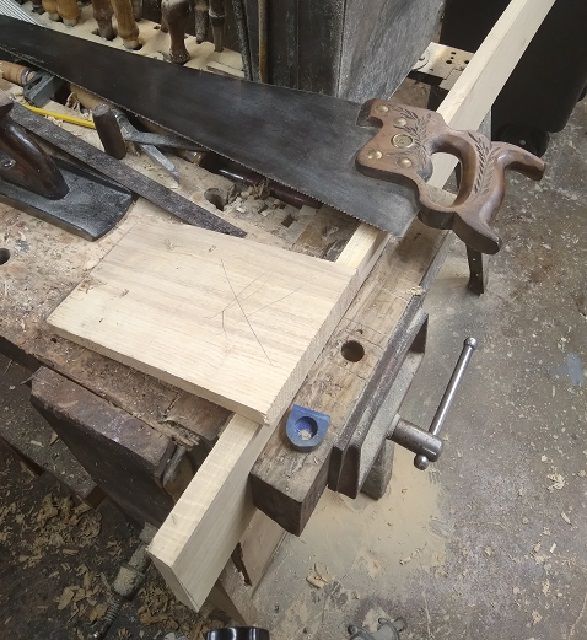

Ok..up date time..clamps are off..one end trimmed square..:ChinScratch:
Using a Vintage saw, of course..:rolleyes:
Measure down 50", reset the saw guide..:OldManSmiley:
And trim this end square...then rotate 90 degrees...and sand and level the Show Face..:SaluteandRun:

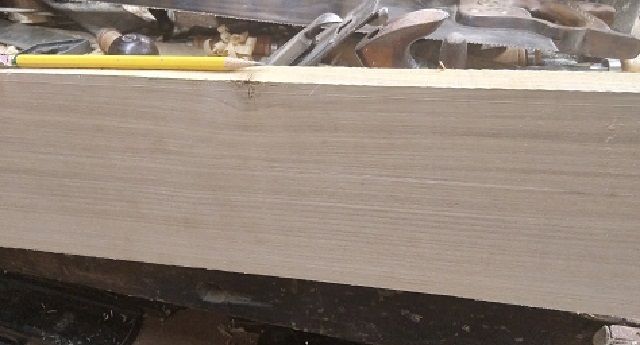

Not too hateful?:ChinScratch:
Flip this over to find...:BugEyeSmiley:
So...sand and smooth this too..:TwoThumbsUp:

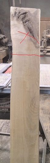

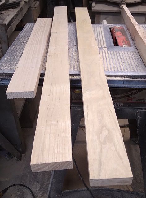

Same view as before...hauled a plank to the shop...as I needed 2 long apron blanks..:SaluteandRun:
If'n you think this end was ugly..wait one...:DevilLaughing:
Handsome, isn't it?:JawDrop:
Cut the 2 bad ends off..then found a center point between the good edge, and the wainy edge..and did a bit of ripping..:SaluteandRun:
I also ripped the blank for the end aprons to the same width...:OldManSmiley:
The 2 long ones wanted to curl a bit, we have ways..:ph34r:
Clamp to flatten out the bows..the 2 shorties?:WonderScratch:
were cross cut for length, as these 2 will be on the ends..:TwoThumbsUp:

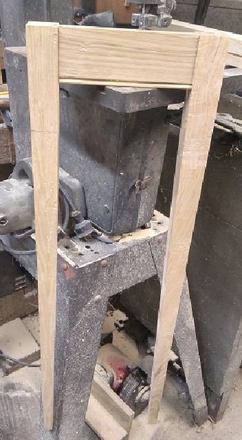

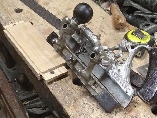

Wanted to get some Tenons milled...so..set up the tenon maker..:SaluteandRun:
Working on the short aprons , first...check the fit..:SaluteandRun:
Short Aprons needed flattened a bit..:OldManSmiley:
That should do the trick..then decided to run a bead..:ChinScratch:
Then repeat for the Long Aprons...which also needed planed smooth..:Cheer:

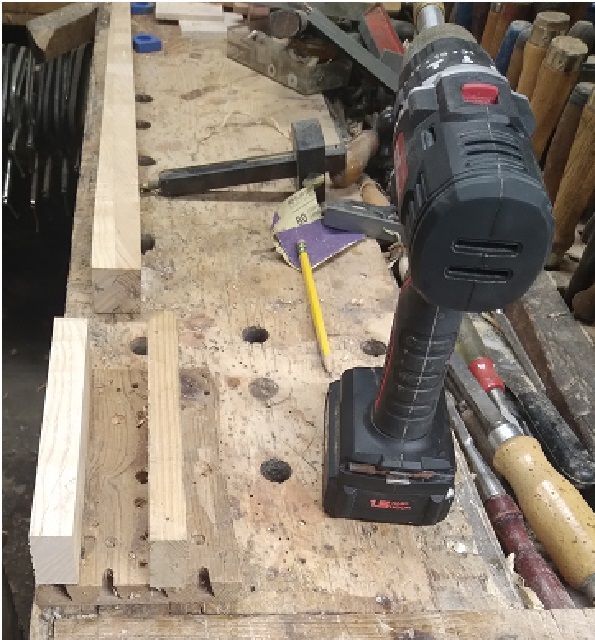

Yes, I drilled a hole into the tenons, to hold parts to the bench while I was running beads...once the tenon is IN the mortise....only the glue will see that hole..:ph34r:
Once again, the long aprons wanted to curl...back into the clamps again:MachineGun:

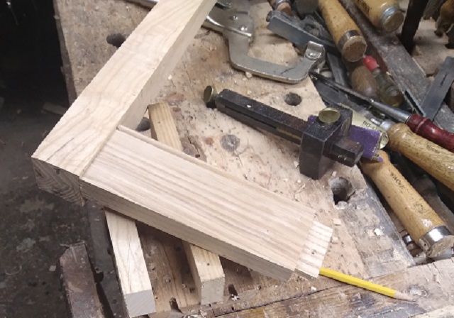

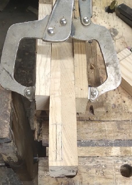

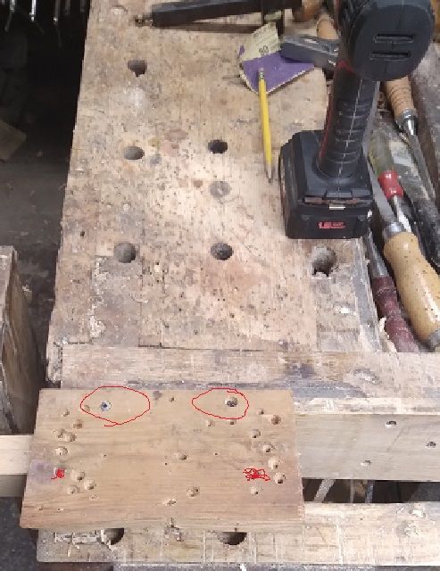

Tenons need Mortises to call home..:WonderScratch:.Mortise Jig needed reset...from the 3/4" width to the 1-1/2" width of the legs...one of the jaws was split..decided since I had to move one jaw, anyway....figured I would replace the split jaw, as well..:OldManSmiley:
This time, I'll pre-drill and counter-sink.   Clamp the jig, the leg, and a new jaw into the bench vise..2 screws to attach the new jaw..:ChinScratch:
Flip over and install right on top of the bench's leg...( No Bounce Zone:DevilLaughing:)...
with a few screws, counter-sunk as well. ( once this job is done, and BEFORE the next..I intend to replace the base)
Slide the leg into the jig..:Cheer:
Do the lay out work...Stanley No. 77 Mortise Gauge helped out..no, the mortise is not supposed to be centered...
Slide the leg back into the jig, and get ready to chop..:SaluteandRun:
Hammer and chisels...Narex 6mm...Aldi's Wide...and dig down to 3/4" deep..:Cheer:
Wide chisel to pare the side walls, until the tenon fits..dry fit needed a mallet, BTW..:ChinScratch:
Repeat for a second leg..and then a dry fit of both legs...:SaluteandRun:
No glue (yet) and no clamps...2 mortises done, only 6 more to do..:rolleyes:
