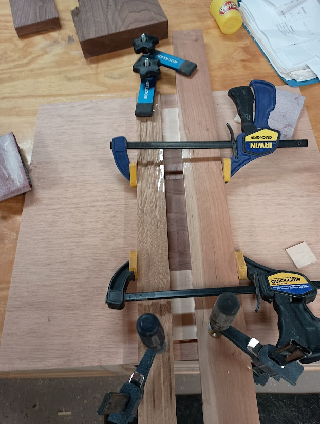

June 4, 20242 yr Author Popular Post comment_336693 Decided to proceed as follows -- laying up vertical lines, one column at a time, from the center out. Report

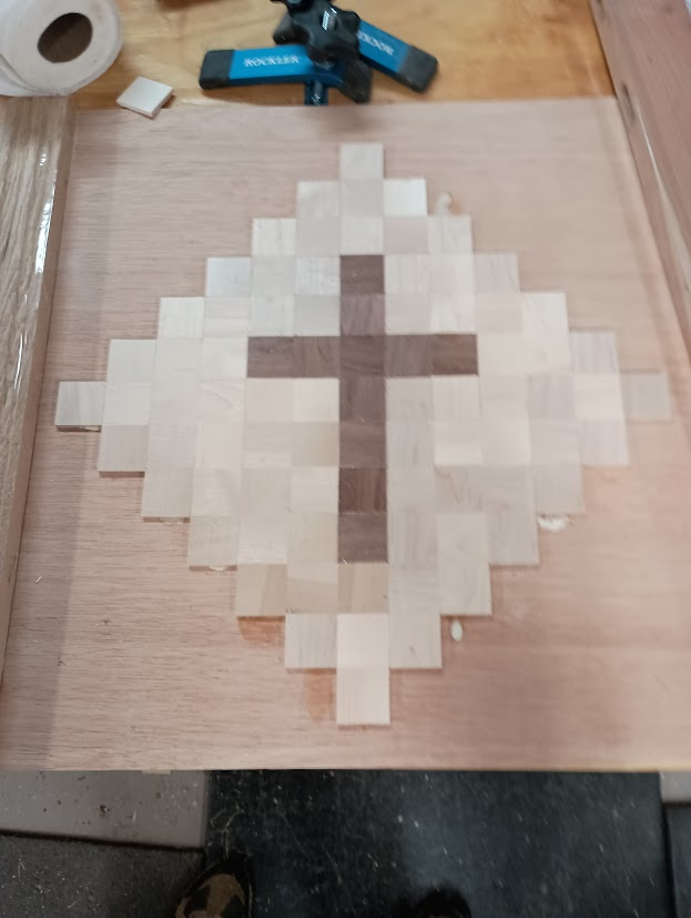

June 4, 20242 yr Author Popular Post comment_336702 First one done. Will sand, trim the border, and finish when the glue is dry. Report
June 4, 20242 yr Author Popular Post comment_336714 1 hour ago, DAB said: very nice, very straight lines!!! yay. Yeah, I have my 10,000 hours in I got the second one glued up before dinner. One more to go, and I have enough tiles cut that I can do a square framed one.. Edited June 4, 20242 yr by kmealy Report

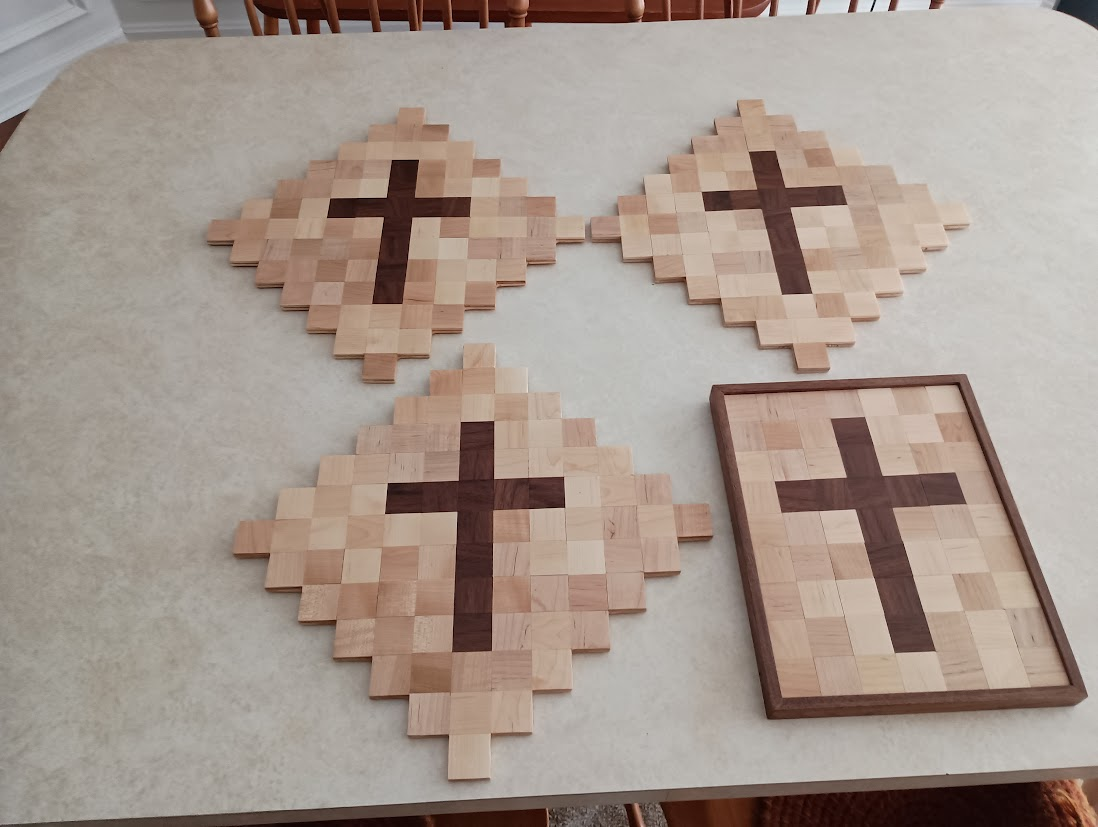

June 18, 20242 yr Author Popular Post comment_337490 Got them done, finish applied and sawtooth hangers on. The rectangular one was made from "leftover" squares, but my wife says she likes it best. Light squares are maple and dark are walnut that was salvaged from a church door. 1.25" square pieces. Adjacent squares have alternating grain direction and maple squares just drawn randomly from the pile. Someone asked if I was going to "frame" the larger ones. Umm, no. Edited June 18, 20242 yr by kmealy Report
