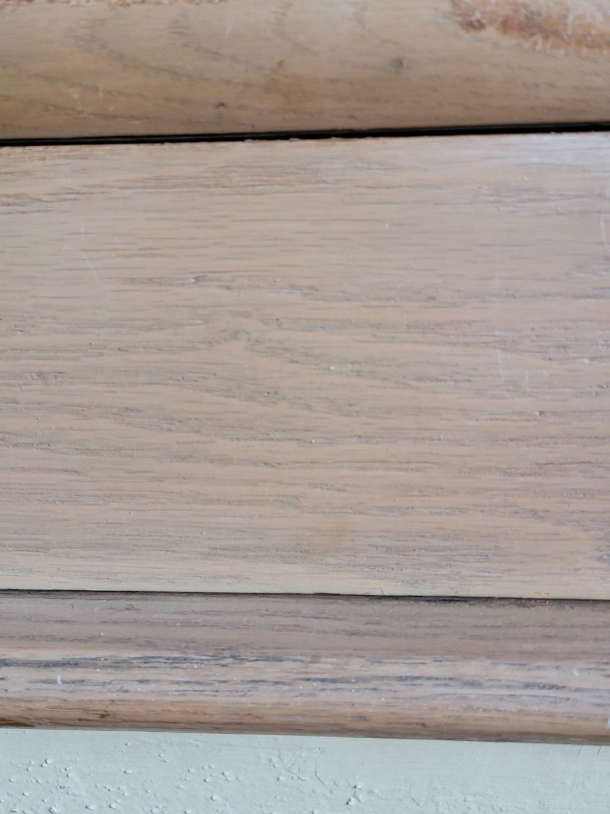

how can I remove water stains from 1950's blonde wooden window sills?
Hey guys, this is followup on a previous post. I have these 70 year old window frames in my house that have bad water stains on them from all the years of condensation. I'd like to refinish these but need to get this off first. I tried ocalic acid, vinegar, light sanding. Nothing so far is working so I thought it would be wise to ask the experts. Any advice would be appreciated.

I see people recommend oxalic acid, aka OA,(or Barkeeper's Friend, 5% OA) as a general purpose bleach a lot.  It's my understanding that it's (only) useful for stains with iron and tannin (an acid in the wood) or UV exposure.  But whatever.  There are three primary wood bleaches, OA is only one of them.
https://www.antiquerestorers.com/Articles/jeff/using_wood_bleach.htm
As an addendum:   I have only used it a few times, but you might consider a grain filler once the stains are out.  It looks like the earlywood has left deep impressions.  A grain filler will help level them.
Thanks for the info kmealy! Very helpful. You are correct about the wood having groves. Almost looks raked in some places. These sills are 71 years old and need some tlc. I'll look into the grain filler. Never heard of that before. Sounds like a great idea. Thanks again!
Kmealy what would be a good grain filler to use? There's so many to choose from. Thanks.

Like I (may have) said, I have not used grain fillers a lot.  I got some when I went to a refinishing class, but I think I've only used it twice.  It was a proprietary product from Guardsman, then a subsidiary of Valspar, and Valspar has since been acquired by Sherwin Williams.
Do not use wood putties like plastic wood -- they are meant for something else.
Depending on your local sources, Mohawk and Old Masters generally make good products.  But follow my rule: When using a new product  or procedure, run trial tests on scrap before committing to your project.
Be aware that they come in different colors so decide what you want highlighting the open grain relative to your stain (if any).  They also come in water- and oil-based versions.
https://www.rockler.com/learn/using-wood-grain-filler
https://www.finewoodworking.com/project-guides/finishing/make-your-own-grain-fillers
As an aside, I would  not use the ubiquitous polyurethane on the top coat.

Thanks guys. This is interesting. Now the harder part, how to I match that old milky looking blonde finish? Anyone know how they did that back in the 1950's? I've tried but doesn't match up very well. Is there a trick to this? Kind of looks like shellac maybe? But where did that milky look come from?
Thanks.
Another of my finishing rules: Don't let a customer describe a color to you using words.  Got photos?
Yes. There's the one above, at the begining but it's not very good. Here's a much better one.
This house was built the year i was born 1953 so I suspect that's when all this milky looking blonde wood was installed. I've been trying to match it for years but have never come very close to that look. Have you any idea how they did this?
Thanks for your help!
Here's my lame attempt to match this wood. Mine is the bottom one. I'm using trim I removed and replaced with new stuff (the exact same style I got from a lumber yard in Ohio).
As you can see it's not even close. I mixed some minwax latte stain with water based poly. Just not doing the job. Any advice would be apprecaited.
