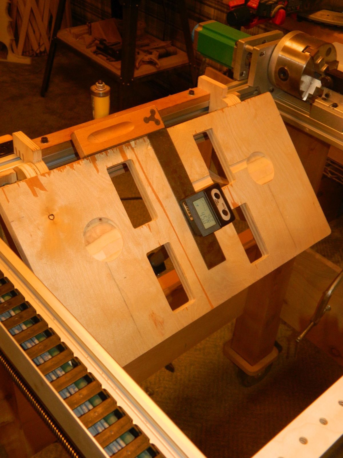

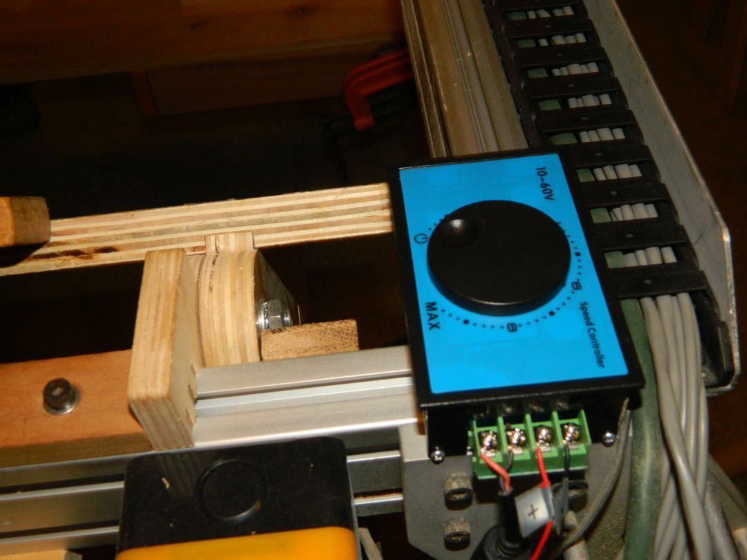

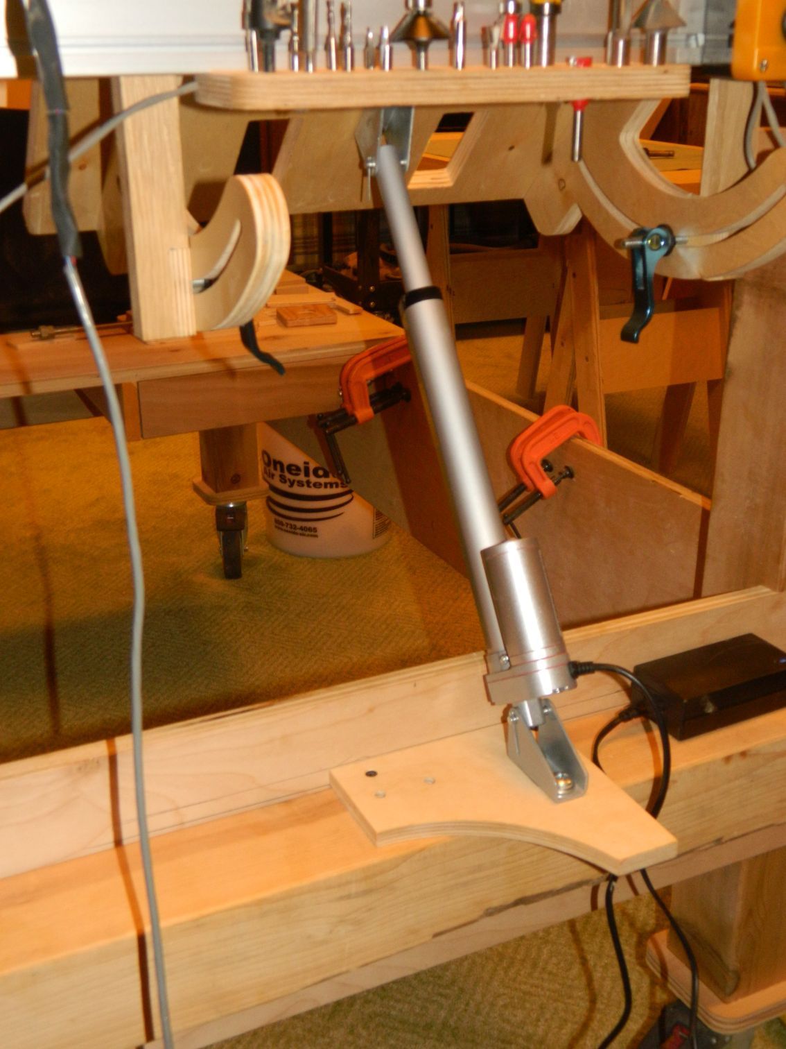

August 6, 20233 yr Popular Post comment_318855 Finally got the linear actuator mounted on my CNC to motorize the setting of the angle on my adjustable clamping fixture. Had to wait for a speed controller which arrived Saturday. Works pretty well. I use a digital angle gauge magnetically stuck to a tri-square blade to tell me when I'm at the angle I want. The speed control lets me move the fixture fairly quickly to get close to my desired angle, and also slow down the movement to sneak up on it. Now that I know it works I'm thinking about a beefier version of my fixture, perhaps out of aluminum plate. There is some flex in this plywood version. Not a crisis, but a slight persisting flaw that I know is there and will nag me until I improve the design. 4D Report
August 6, 20233 yr comment_318873 I did notice a chunk of aluminum plate last time I was searching for something in my garage. Salvaged from an old HP pen plotter I took apart. I think I may have the tools needed to cut a 19"x 10" rectangle out of it. There should be enough of it to make the other parts as well. Notice in the last photo that I joined the top cherry cross bar to the plywood side brackets with finger joints. That works pretty well with wood as wood glue keeps them together. I can cut the same joinery in aluminum, but wonder if you can sweat solder aluminum finger joints together. Not that I can't drill/tap/bolt the parts together, but more to experiment. 4D Nope. Just checked and the pieces are 3/8" thick, riddle with holes, some tapped and some not. Not enough area to cut a 19" x10" rectangle from. Amazon can likely sell me a 12" x 24" piece of 1/2" 6061 aluminum plate though. Edited August 6, 20233 yr by 4DThinker Report
