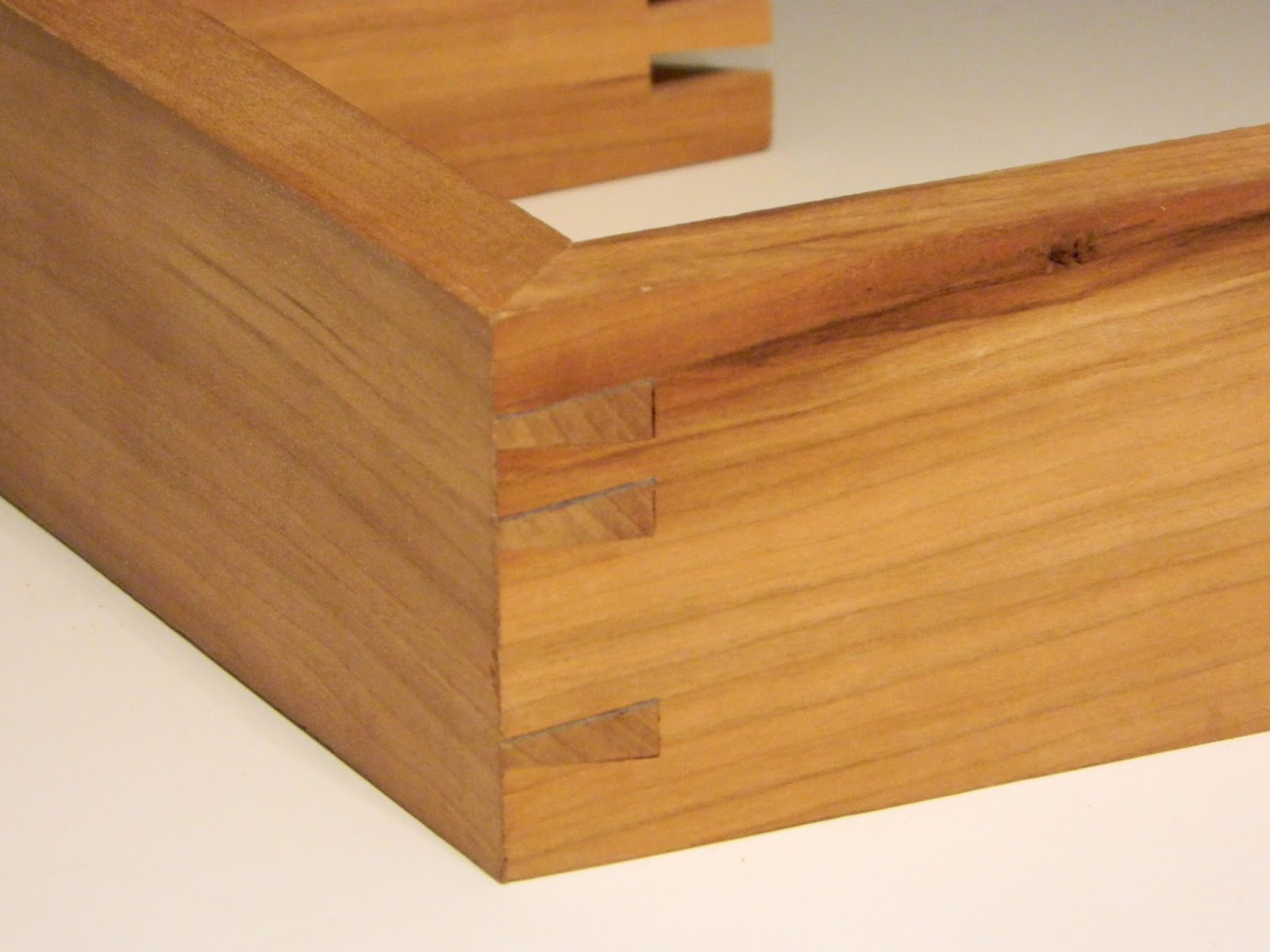

Hand cut dovetails, no matter the variation, were a rare occurrence among the student furniture design projects over the last 40+ years.  Of course rarely did a student arrive with any woodworking experience before they started the furniture design course sequence I helped teach.  When a student showed an interest in cutting their own dovetails I'd refer them to a fellow professor who did pursue and preferred such handwork over machine produced joinery.  The advice he provided was "practice, then practice some more", along with showing the student the tools and techniques to use.
As the CNC specialist I would occasionally offer a CNC furniture elective to anyone in the college that was interested.  Usually it would fill up with Architecture students and occasionally an engineering or art/sculpture department student.   My class would start with showing them how to create toolpaths for and cut simple joinery samples.  Half laps, M&Ts, miters, etc.. Their final project would be a piece of furniture of their choosing and within their budget, but all the joinery (at minimum) would have to be cut using the CNC.  One semester, for the final furniture project in that class a student brought me a photo of  desk top with half blind mitered dovetails on the desk side edges.  "Can we cut these using the CNC?".
My initial research on the web concluded that perhaps one half of the joint could be done using a router table, but the other half would need to be hand cut.  I told the student during a Friday class that it was unlikely that the CNC could be use for both halves and he should start thinking about another option for his project corners.
Then I slept on it.  Monday morning I knew how I could cut that joint on the CNC with the help of my angled clamping jig.  Sample shown below.  Student was delighted and his project turned out great. image.png.1d428a363cfe3f9c4b53c37dce480357.png
