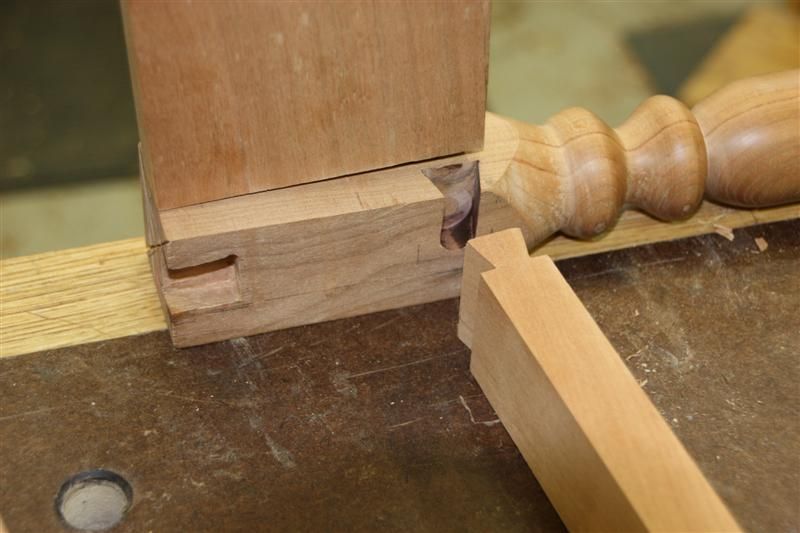

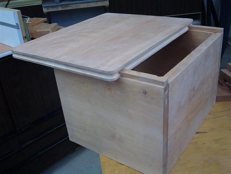

November 15, 20224 yr comment_302300 I use dovetail grooves on drawer fronts, It will never break. Also have used it on a side table top. It also is good to join legs to stretchers. This side table has no screws except to add base leg unit. Not really hard to do but needs a lots of tests to fit properly so keep those scraps the same size as final lumber to be used. Report
