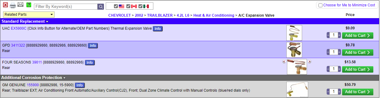

August 21, 20224 yr Popular Post comment_297132 11 hours ago, Grandpadave52 said: Finally got back to messing with it. Low side shows about normal operation, high side normal for ambient temp, clutch cycles on/off ~ 7 seconds intervals. I can hear and feel low pressure switch cycling in/out. Low side lines never get cool let alone cold at or beyond the accumulator. If it was an old R-12 system with an expansion valve, I'd guess it bad?? Few of things to look into. 1. Did you change AC compressor relay? #44 in fuse box under hood. Contacts can be bad in relay causing same problem. 2. To test you can bypass relay and directly apply power to system. Does this eliminate cycling? 3. Fan clutch is electronic, connector is on driver's side of fan shroud. It is common for connector or wires to be damaged. You either have manual HVAC or Automatic HVAC. A manual system is directly controlled by ECM, an Automatic HVAC has an additional HVAC Control Module that also gets a say in the matter. If you want wire schematics, I can send them just need to know which system. That is for possible electrical issue. The system could have a restriction, just about anywhere. Including orifice tube in backwards or plugged condensor and or lines. Report
August 21, 20224 yr Author Popular Post comment_297134 11 hours ago, Grandpadave52 said: If it was an old R-12 system with an expansion valve, I'd guess it bad?? That's about all you've got left Dave. BTW, R-134 systems do have one. , I'm sure you know who's site this is. Report

August 22, 20224 yr comment_297159 11 hours ago, Gunny said: Few of things to look into. 1. Did you change AC compressor relay? #44 in fuse box under hood. Contacts can be bad in relay causing same problem. 2. To test you can bypass relay and directly apply power to system. Does this eliminate cycling? I swapped the relay with a known good one still cycles; initially by-passed when I was troubleshooting the old clutch non-engagement 3. Fan clutch is electronic, connector is on driver's side of fan shroud. It is common for connector or wires to be damaged. New fan clutch; You either have manual HVAC or Automatic HVAC. A manual system is directly controlled by ECM, an Automatic HVAC has an additional HVAC Control Module that also gets a say in the matter. its automatic, dual controlsIf you want wire schematics, I can send them just need to know which system. That is for possible electrical issue. The system could have a restriction, just about anywhere. Including orifice tube in backwards I pondered that but 98.2% sure I installed it correctly...the old one was dirty/ stained but not plugged nor any metal contaminates or plugged condensor and or lines. hindsight is 20/20 but should have at least tried to blow air through it or perhaps flushed but with no physical evidence of contamination, I didn't...I'm hoping I removed all plastic plugs I put in where ever I broke a line Thanks for the help Gunny. I hate to admit defeat on this one, but think I just need to step away. I've got too many other projects that need attention and the kid just wants her car back. Good news is, everything else I did seems fine. Runs/idles much better after cleaning throttle body, new plugs, air filter, cleaning MAF sensor, replace camshaft position sensor (it was leaking oil from connector body). It had a new water pump, drive belt & alternator on it; I replaced tension idler assembly, other idler, radiator (20+ years old; seeped at top tank when cold), thermostat, new hoses, antifreeze, radiator cap, fan clutch cooling fan & shroud ( most of that SHOULD have been replaced when water pump failed but it wasn't). It occasionally was throwing a P1484 code which indicated a cooling fan issue. That's what started me on the journey. The more I removed, the more I found. Needs a new fuel filter yet but has to be a lift to remove that stupid poly skid panel underneath. I'll have the shop do that too. Report
August 22, 20224 yr comment_297160 11 hours ago, Larry Buskirk said: That's about all you've got left Dave. BTW, R-134 systems do have one. , I'm sure you know who's site this is. Yeah I saw that too Larry. After some digging around and research those are only used on models with actual independent rear AC which have separate evaporator unit. Hers has rear controls, but not rear A/C. Plenty cornfusing.. And yes, know the site all too well. Got lots of those free "classic car" magnets. In fact will be ordering parts for my truck this coming week. Report
