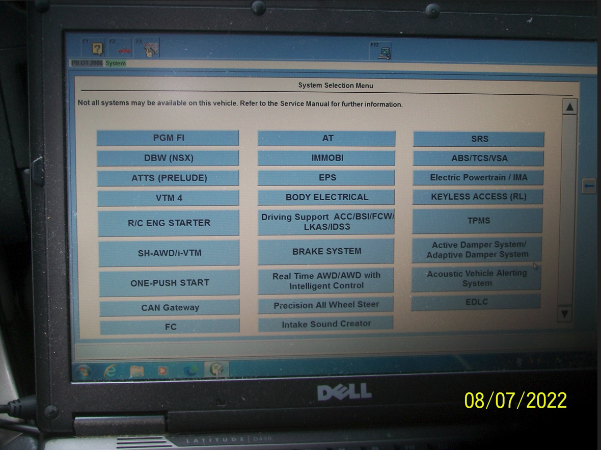

August 7, 20224 yr Author Popular Post comment_296161 Decided to finally clear the VSA, and SRS warning lights on the Pilot. Had two VSA codes 61-1 (Battery Voltage Failure) and 84-1 (Sensor Logic Failure) Had to do the VSA Sensor Neutral Position Memorization procedure to clear the 84-1 code. Also had two SRS (Air Bags) codes 81-71 (ODS Unit Does Not Calibrate), and 85-61 (No Signal From ODS Unit) Had to initialize the ODS Unit, along with recalibrating the SWS (Seat Weight Sensor), and passengers seat back OPDS sensors. Both lights now out. Dealer wanted $200.00 just to hook it up to their diagnostic equipment + hourly rate. $200.00 + hourly rate? ... Took me about a half to three quarters of an hour to figure out the software, and do the job. That HDS/HIM (Honda Diagnostic System/ Honda Interface Module) unit I rebuilt did the same thing, and was basically FREE! Well almost free, I spent $40.00 for two batteries for the laptop. Report
