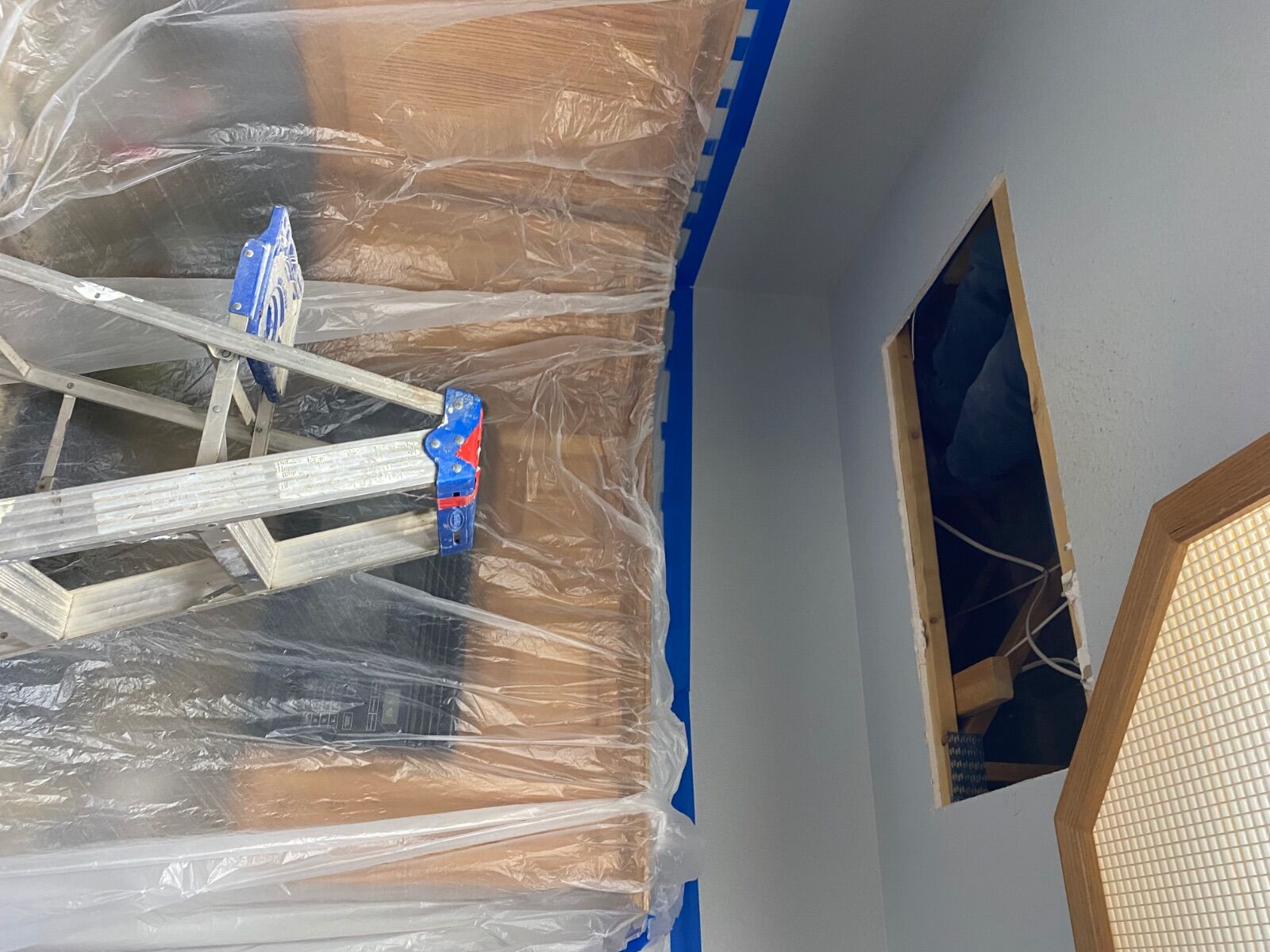

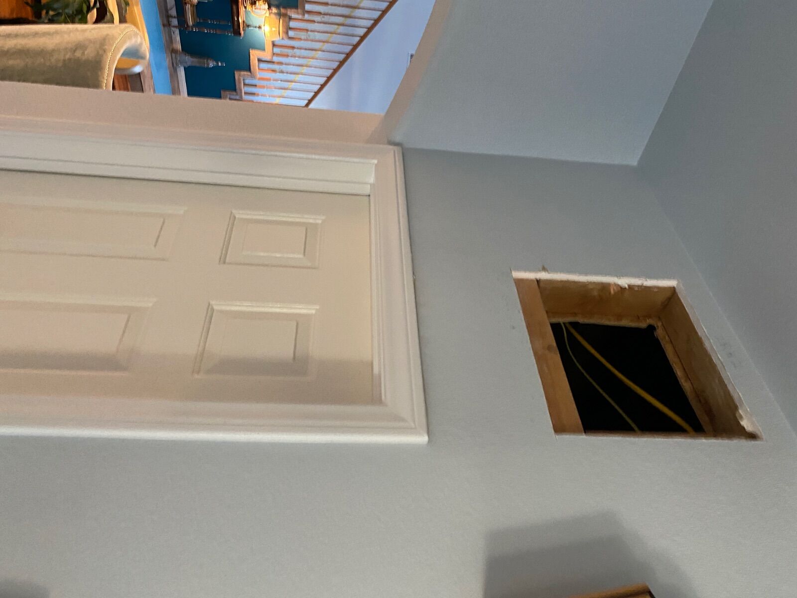

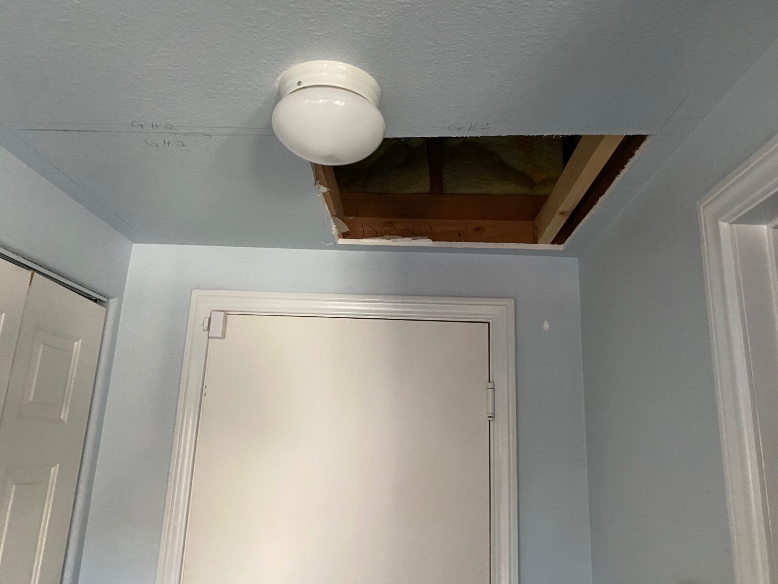

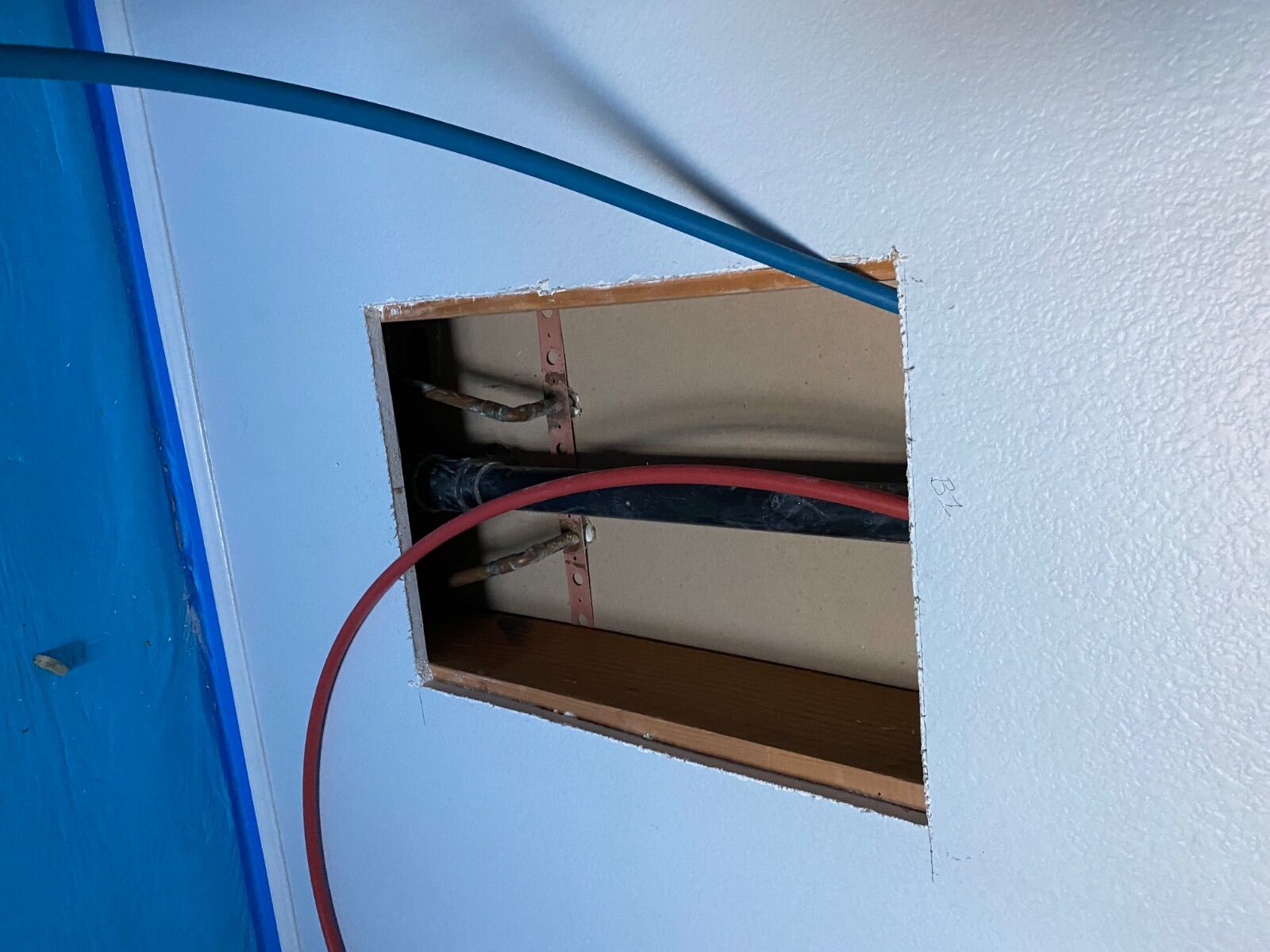

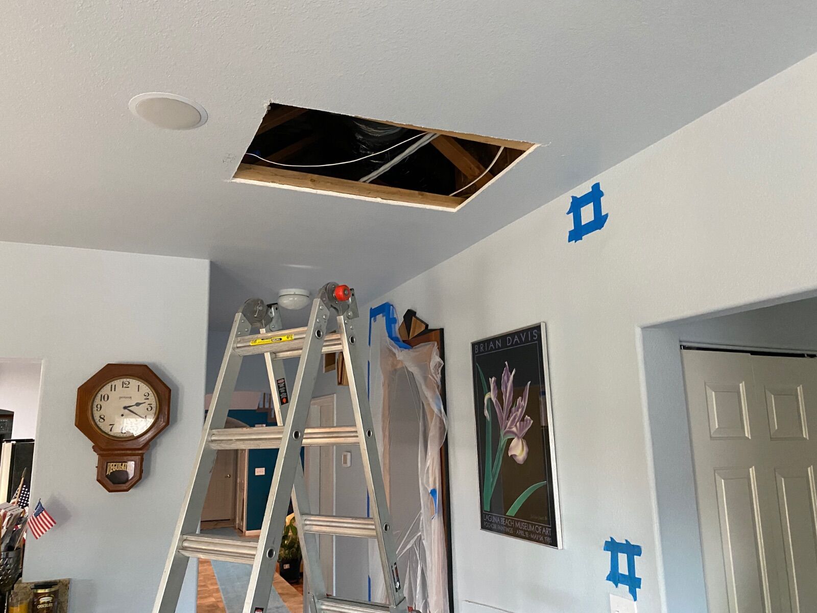

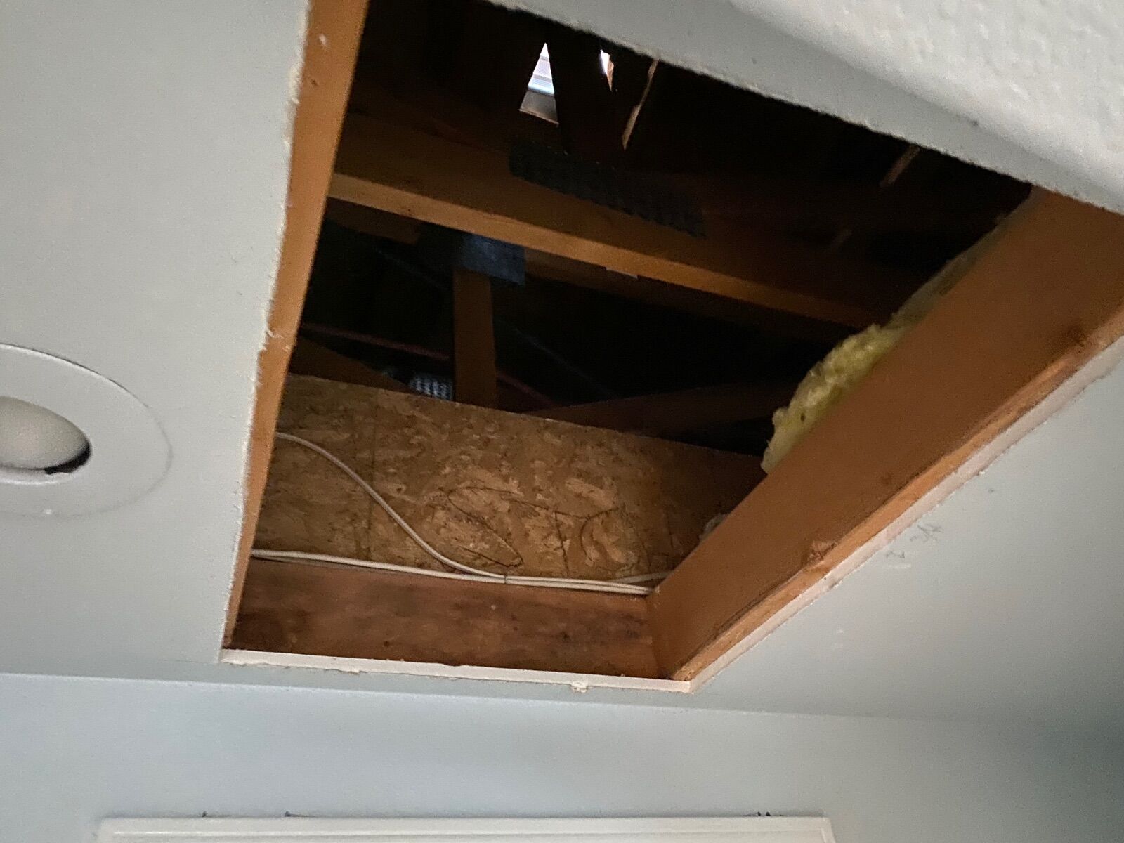

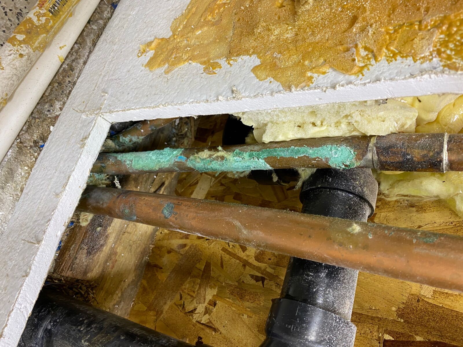

So our slab leak has turned into a total repiping of the house. Every pipe, every valve, the works. The house looks like Swiss cheese with holes everywhere in the drywall and stucco. We called them out to just fix the leak under the slab but as we delved into the place we found multiple places where the copper was corroding very badly and it’s amazing we only had the one leak. After scraping off the corrosion the pits in the pipe were pretty deep. I’ve been doing houses for many years and I have never seen anything like this. Once it’s done we will hopefully be good past my life expectancy. The crew is doing a very nice job and managing to keep at least one circuit functional every day so we have a shower and toilet.

Had a plumber here to fix a leak this summer. He showed me a fitting and a piece of pipe that he replaced.  The pitting was unbelievable.  He said I should consider re-piping the home sometime in the near future. The copper would be replaced with plastic piping. Is that what you're replacing your piping with ?
Yes it is all Pex tubing.

My best guess of the cause is sloppy use of flux. There was a flux on the market of a name I can’t remember that was pulled off the market back in the late 80’s due to it being caustic. But even regular flux if used too liberally and not wiped off can cause this. This is one of those surprises I hate to find but at this point all we can do is fix it and move on.

 That's quite the task you have going on Paul, I hope it's short lived. When your plumbing project is completed Paul if I could suggest that you check the grounds in your receptacles, you can use a simple plug-in tester. If there was a previous electrical issue that an electrician solved by picking up a ground from the copper pipe that problem may reappear. Phone companies were notorious for this practice.
I considered the grounding as an issue but the corrosion was specifically at every soldered joint and running down the the pipe a few inches. As far as any problem down the line there won’t be any issues as the entire system is now plastic. They found the feed from the well and brought it up into the house so the whole house is all new. It’s going pretty well at this point. They put in a temporary service to the upstairs master bathroom and one bathroom downstairs so we have a bathroom on each floor while all this is going on.

:ChinScratch: I could say a few things about that, but what I see is someone used an acid-based flux when they did the job. :CoveringEyes:
Have also seen this type of corrosion caused by using one of those water softeners that use salt with well water that has nitrite contamination from farm fertilizer runoff. The combinations of salts/minerals can become quite caustic to pipes.
The "Battle of The Boiler" was caused by that very reason. We ended up replacing all of the traps (Both Float & Thermostatic and Steam Trap Valves along with close to 100' of piping) due to that. It's actually caustic enough to eat away the Stainless-Steel discs in the thermostatic valves and traps.
