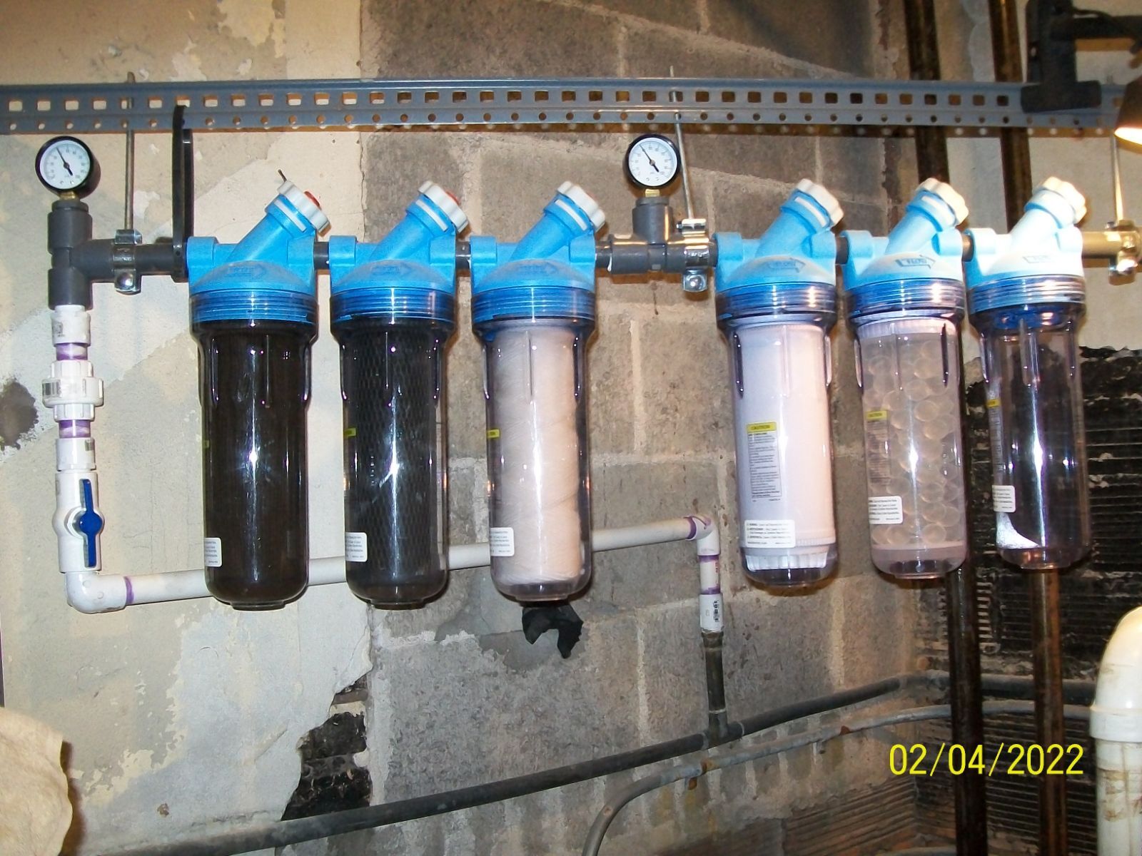

February 18, 20224 yr Popular Post comment_284475 Friday again folks. Here "Two Weeks From Anywhere" we're playing the waiting for parts game with "The Battle of The Boiler" We've got parts coming from coast to coast and from border to border. You know you've called the wrong place when they respond " You want a what for what?" And then when you give them a part number they ask "How old is this system?" And then when you tell them about 65 years old they respond "Oh that old you've got to be kidding." Hopefully only one more part to find. What's on your weekend agenda? Report

February 18, 20224 yr Popular Post comment_284504 5 hours ago, Larry Buskirk said: "The Battle of The Boiler" Mine has been going out for five years. Kept swapping in fresh thermocouples. Finally this year, nada. No one would tell me the Hoeywell equivalent gas valve, so I guessed, and it was a perfect fit. Even down to the factory stabilizing bracket. The only other problem, it's been leaking for 15 years ... so I add water every month or so. Just cut my dad a piece of veneered masonite to 17" x 9½", sanded the edges, hit it with my go-to. Diluted spirit varnish. Here's to keeping it between the lines. Report
February 18, 20224 yr Author Popular Post comment_284509 2 hours ago, Dovetail said: Mine has been going out for five years. Kept swapping in fresh thermocouples. Finally this year, nada. No one would tell me the Hoeywell equivalent gas valve, so I guessed, and it was a perfect fit. Even down to the factory stabilizing bracket. The only other problem, it's been leaking for 15 years ... so I add water every month or so. Is your system recirculated hot water or steam? Have to love those Honeywell part number cross reference charts. This is a 780,000 BTU 15 P.S.I. steam boiler system with auto water make-up. This system had one of those Culligan type water softeners that uses salt. You can probably imagine the mess that caused when salt got into the system. So far we've replaced the condensate return tank, roughly 50' of 1 1/2" and 2" condensate return piping and three out of five float & thermostatic steam traps and three out of six thermostatic steam valves. I'll be rebuilding the pneumatically controlled supply valves when the rebuild kits get here. Also built a new filter system using whole house water filter cannisters with softening/conditioning/descaling cartridges. Water quality readings are much improved. You wouldn't believe the crap coming out of the system now. Almost all of the thermostatic valves are corroded away. It takes some searching but we've been finding N.O.S. obsolete/discontinued F&T's for less $ than we can get the rebuild kits for. Will be replacing the remaining two F&T steam traps Monday when the store is closed. They came today. $75.00 for the 1" $95.00 for the 1 1/4" $35.00 shipping from east coast. Mepco last listed the rebuild kits for the old Dunham Bush F&T traps at $329.00 each. (If you can find them obsolete/discontinued) Been replacing them with Sterling/Sterlco F&T's that can be upgraded with the better Barnes & Jones thermostatic valves. (Found six of those for $10.00 each list price $129.00) The Sterling/Sterlco F&T's are basically the same trap as the B&J's with a different cover and the cheaper bellows type thermostatic valves. Other than the cover/thermostatic valves they appear to be identical to the B&J units. Wouldn't surprise me if B&J didn't build them for Sterling/Sterlco. As to the thermostatic steam valves we're going with the top of the line B&J ST series that have built in strainers. Getting those for 1/4-1/3 of list price depending upon if 1/2" or 3/4". Edited February 18, 20224 yr by Larry Buskirk Report
February 19, 20224 yr Popular Post comment_284517 2 hours ago, Larry Buskirk said: 780,000 BTU 15 P.S.I. steam boiler system Geez! I’ve worked on a few as large. Decades ago. Before electronic controls. All basic 120v or 24VAC, easy to troubleshoot. Typical residential steam boiler might be 175kbtu and run at half a pound pressure. I think … Mine is water. Report

February 19, 20224 yr Popular Post comment_284530 13 hours ago, Larry Buskirk said: This is a 780,000 BTU 15 P.S.I. steam boiler system with auto water make-up. I'm glad I'm not paying the fuel bill for that. whew! Report
February 19, 20224 yr Author Popular Post comment_284534 11 hours ago, Dovetail said: Geez! I’ve worked on a few as large. Decades ago. Before electronic controls. All basic 120v or 24VAC, easy to troubleshoot. Typical residential steam boiler might be 175kbtu and run at half a pound pressure. I think … Mine is water. One pipe system with a Bell & Gossett pump? We had a few in the plant that were over 3,000,000 B.T.U. 125 P.S.I. systems. A couple of them you could walk inside the fire brick lined boilers. No such luck on the controls they're pneumatic, and no schematic. As a former co-worker stated, "Oh yeah you're working on that TOY boiler." 28 minutes ago, Fred W. Hargis Jr said: I'm glad I'm not paying the fuel bill for that. whew! Neighbor decided it was time to do something when the gas bill went over $1500.00 a month and he was getting very little heat. He about fell over when he was quoted prices from heating companies to repair the system. Estimates were in the $12K-15K range. We've now got the building maintaining 65° even with the still leaky traps. We're still getting some pressurized steam venting from the condensate return tank. Replacing the last two F&T's and steam valves should take care of that. Report
