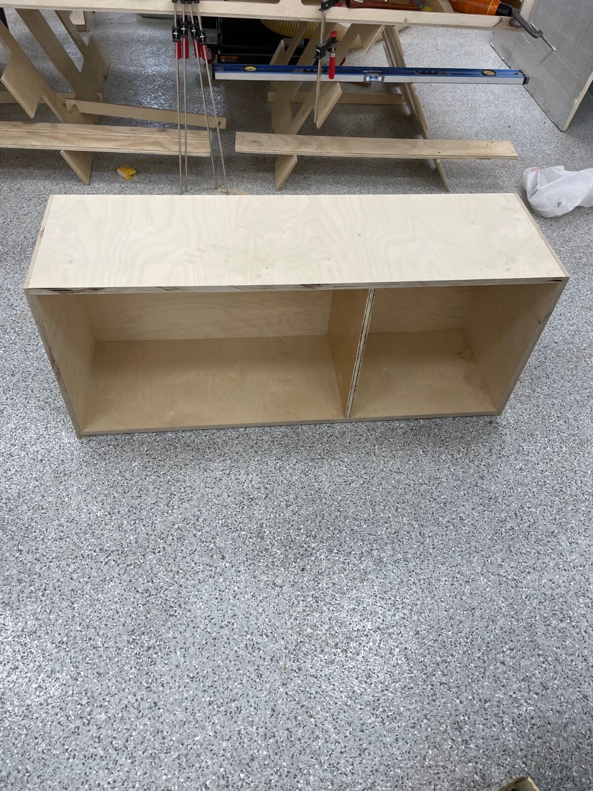

This is the first installment in building an undercabinet for the shopsmith to get some weight on it for stability purposes and to have a place to store some of the myriad accessories needed.  Hopefully this will be useful to someone.
I went with a 2 large drawer setup under the head stock and I am not certain yet on the drawers for the right hand side, I have some ideas that I am going to play with over the next couple days to see what is going to work best.
Obligatory pictures follow….

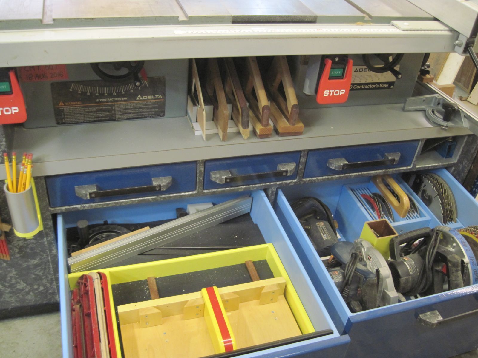

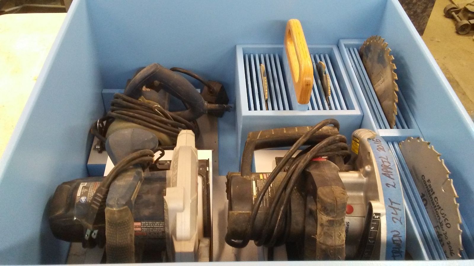

A suggestion before you get to far along.  Carefully consider what you want to store in this, even if it slows project down until you have a solid plan.  In designing my twin tablesaw lower cabinet this took alot of time to lay out.
These pictures are for example purpose of use of space in a drawer.

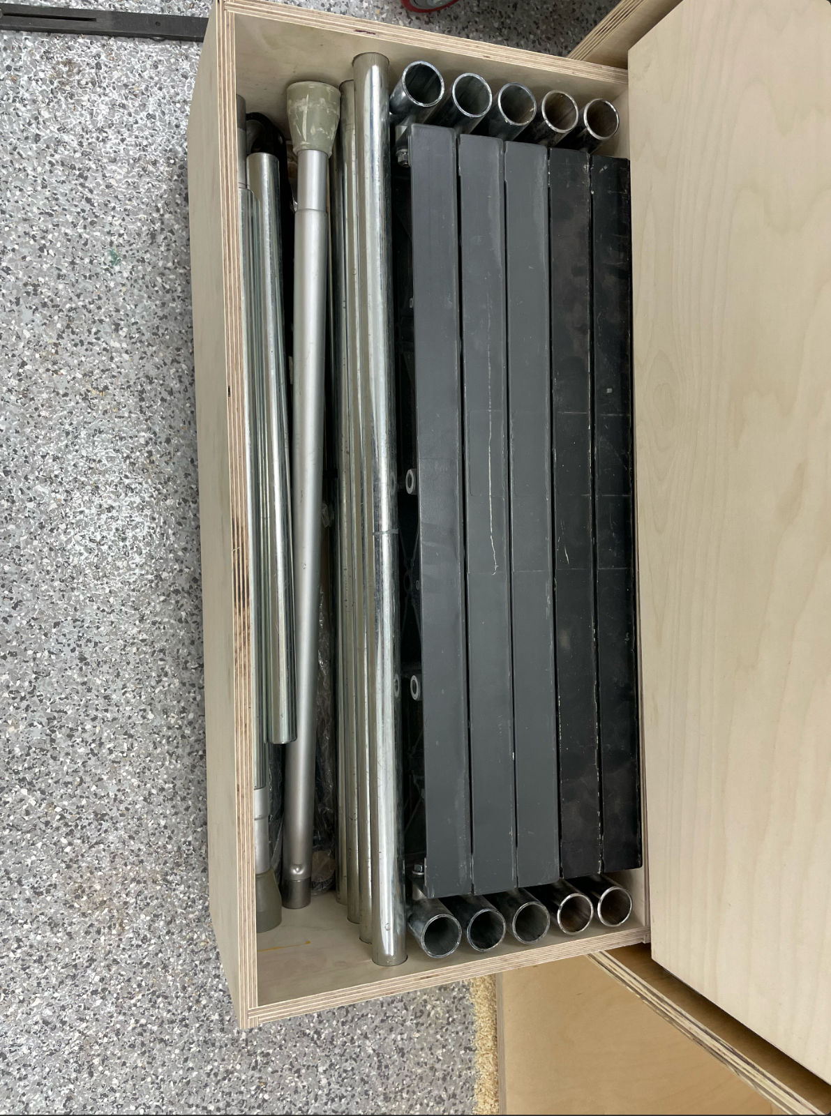

Auxiliary tables, support bars, brackets, support legs.  It adds a non-trivial amount of weight to the machine and just with this, the vibration dampening is apparent.
Still working on sorting out the second drawer and planning the right side to maximize utilization.

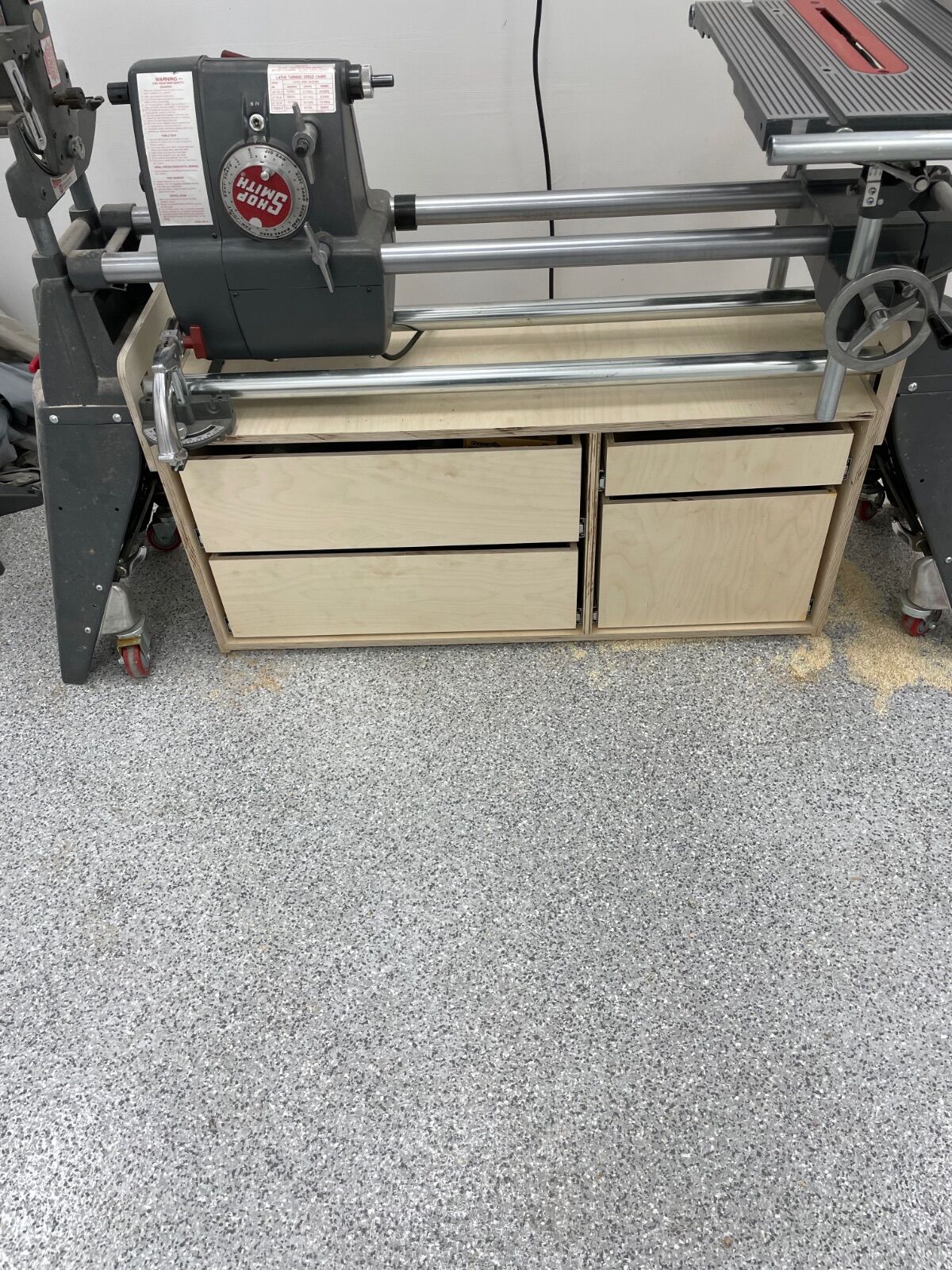

Got the rest of the drawers finished up today, mounted and everything stuffed into them with a fair amount of storage space left over (for more accessories), Still need to do drawer faces to finish them off properly, but so far things have come together nicely.
I am still working on a chisel storage solution but that is almost designed out and I will get that built in the next day or so.
Progress pictures…
My, you've been busy this year.;)Looking good. Great deal of storage gained. Well done.

Looks like a great addition to the SS Static!
Adding the weight to the machine really improves its performance. That’s coming out nicely !
Paul
Looks like a good improvement over the typical shelf (AKA shin-banger) that you see.  Though I'm wondering if a little toe kick space will be handy, depending on what tools you are using.  Looks like there is room to lift it up though, if you decide that in the future.
I need to build one of these. I also understand with added weight of the cabinet and contents, the smith sounds smoother? Some rattling from the base and such are eliminated?
I would think contents would rattle some unless something like Kaisen foam is used.   I heard many years ago that bags of sand work really well in absorbing vibrations.
Unless you have skis for feet, I don’t see any problem there.  I have to stand back far enough to clear the table carriage adjustment wheel anyway when using the lathe which leaves plenty of room for my feet.   I debated raising the cabinet and / or making it two inches taller but this is what I am going with for now and it doesn’t seem to be an issue.  I wanted as much weight as possible as low as possible and preferably on the head stock side which factored into the overall design.
The contents don’t seem to rattle at all and the overall operation of the SS seems much smoother. No rattling from the base and operating vibration is significantly reduced.  If I find that things move around I will build some drawer organizers / retainers to keep things in place but that doesn’t look like an issue currently.
