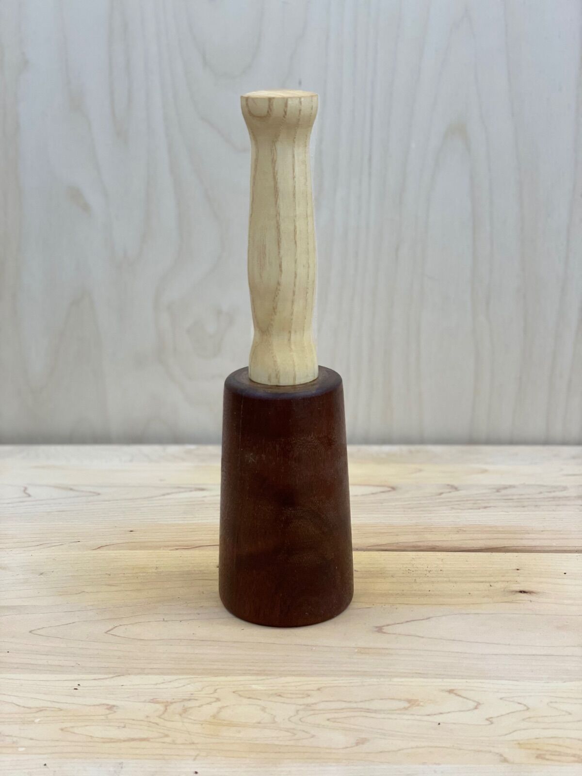

December 24, 20214 yr Popular Post comment_279054 Well I did another thing today… After some great advice on making blanks, I did. I wound up with a 3 1/4 x 3 1/4 x 12” Ipe blank this morning and decided it was just the thing for making carving mallet heads. That was a bad decision. This stuff is terrible to work with. It is hard, it is dusty, it is messy, and I am not using carbide or even HSS chisels for turning. Lets just say that I have gotten a lot of practice at sharpening those things today. On the good side, I learned how to properly turn a tenon which is a pretty useful skill. I learned what not to use on end grain, roughing gouge I am looking at you. How to properly use a parting chisel. How to bore a hole using a tailcap chuck. I learned that the wife has a reaction to Ipe dust so she is not allowed back into the shop until I can get that cleaned up tomorrow. I also learned that my respirator works well and that my little ghetto air scrubbers are actually really good at grabbing Ipe dust out of the air. Anyway the end result is a tapered mallet head center bored 3” for a 1” diameter handle which will NOT be Ipe. On a side note, I had to sharpen the bit twice to bore that hole and it still took over half an hour. It still needs to be sanded but I will wait until I get the handle on it and to a final smoothing and sand the whole thing at once. In retrospect, I should have left it on the tenon until I was done with the handle and then done the final smoothing/shaping but it won’t hurt to have a turning point marked if I ever have to smooth out the face for some reason. What do you guys to with used tenons? It almost looks like it could be glued to something and reused if you wanted to. Is that a bad idea? Report

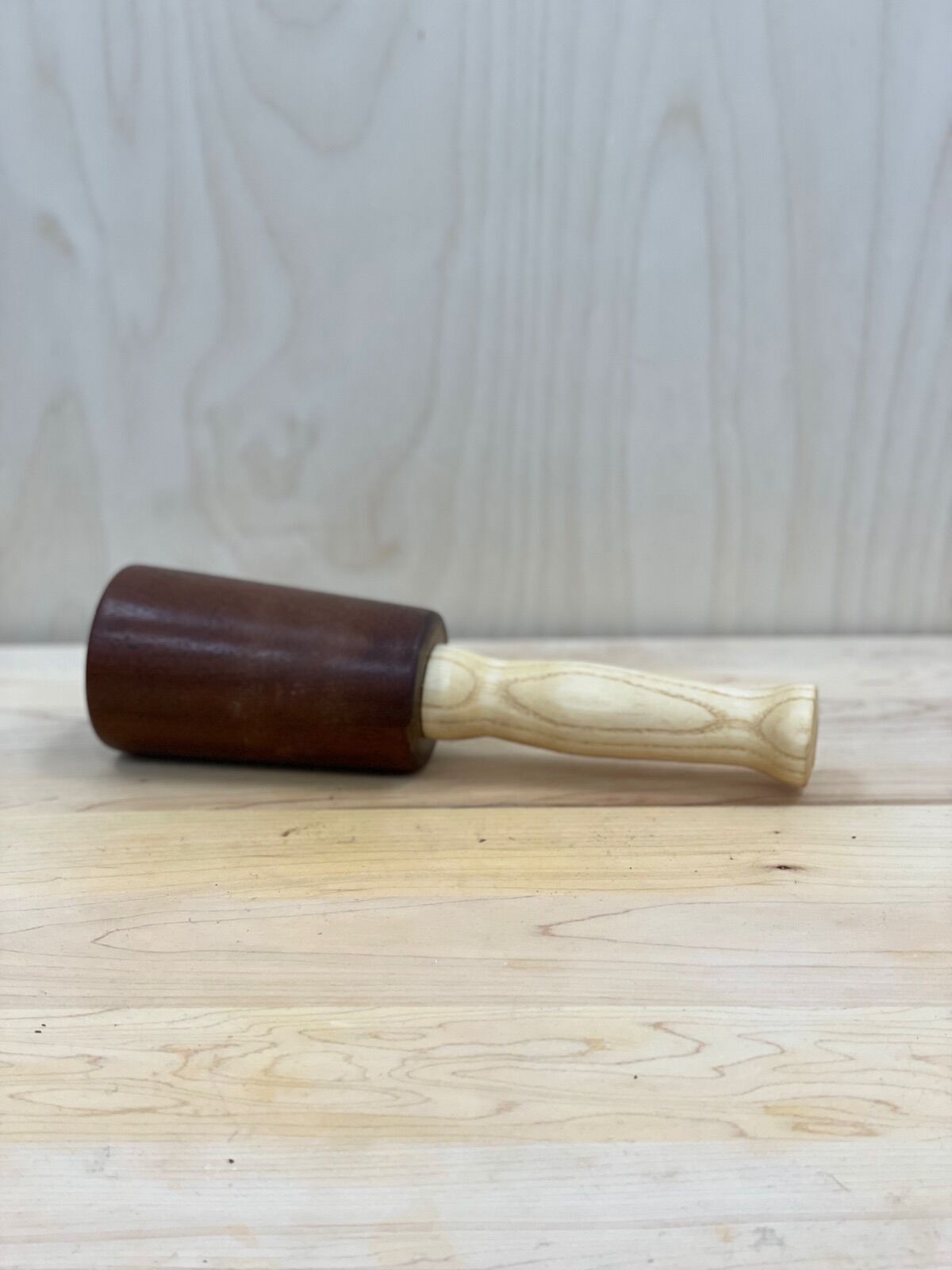

December 25, 20214 yr Author Popular Post comment_279212 Well it has been an interesting ride. After a lot of figuring out what I did wrong and how to not do that next time, I have a final product. This is a turned carving mallet with an Ipe head and Ash handle. It is hard and heavier than it has a right to be. There are definitely some imperfections and I learned a lot through this process. While I am nowhere near being good at this, I suppose I might rate as sort of competent and I am pleased with the end result. Report

December 26, 20214 yr comment_279230 It looks very good as if you done this many times before. Report
December 26, 20214 yr comment_279234 You should be proud! Not only well proportioned but beautiful as well! The contrast between the ash and ipe is gorgeous! Report
December 26, 20214 yr comment_279247 Looks great. keep in mind it is a learning curve that last a lifetime. We didn't start life running marathons. Somewhere crawling was involved. Report
