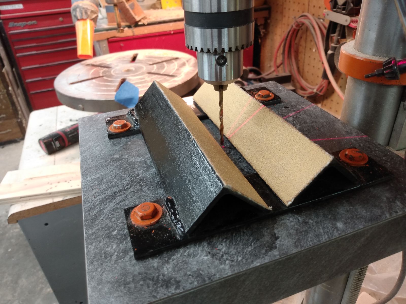

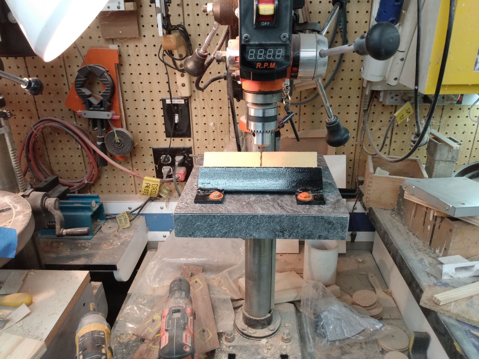

Finished early tonight on my latest project. A jig for the Drill press for drilling cylindrical objects. Had one for the old DP but it was custom made to fit that smaller DP plate. Used same V groove just new base that fits my WEN 12 in DP. Valuable tool to have in our arsenal. Made from 3/4 MDF and wrapped with 1/2 pine. Top and sides are Formica scraps from previous project. Keeps any oil / paint / other mess from ruining the MDF. Fits nicely, very snug fit to the plate. Checked when done by using laser pointer and then drilled a hole through a piece of 3/4 PVC. Spot on, very pleased. Off to finishing room top seal the bottom with some Arm R Seal. Be ready for use in a few days. Next is a new holder for it, old one was too small. Always something huh?
OOOOOO aaaah, Fancy. I just cannot justify a fancy jig for something I will use may once in 5 years. I just took a piece of 2x6 cedar which I had wasted time milling out from a log in my yard , cut a v in it and let it go. I made that one about 3 feet long for stool legs about 12 years ago. It has been used maybe once since. Oh well guess I have maybe 10 other jigs hanging in the shops I will probably never use again.
