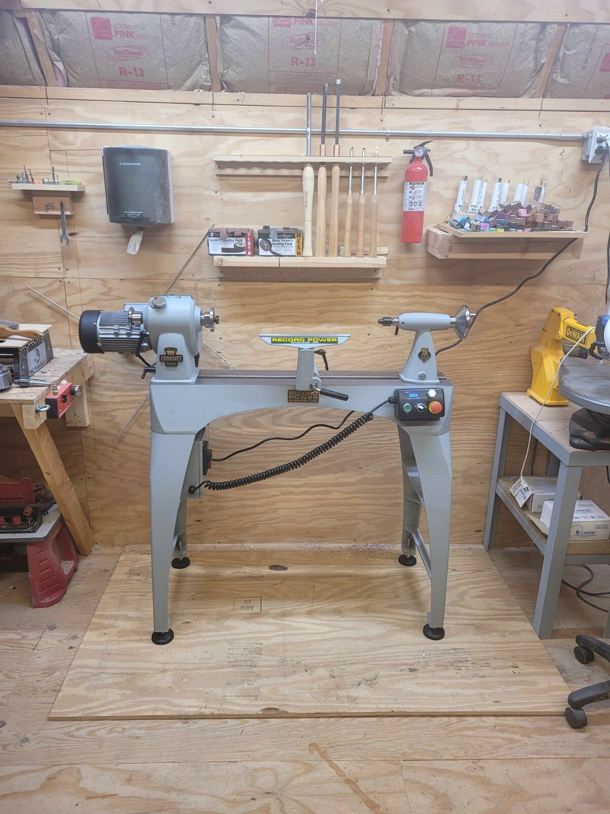

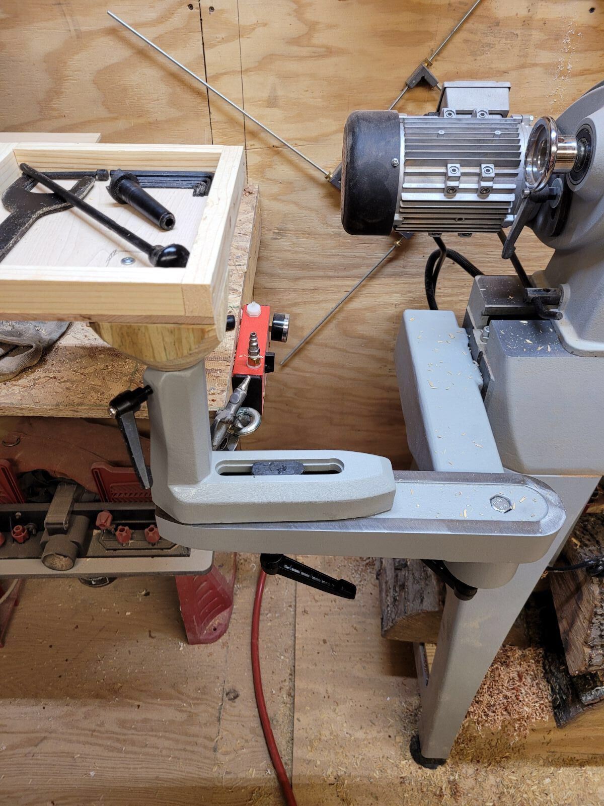

I went with the Record Power Coronet Envoy. I have only had it for two or three weeks and really like it. It will turn 16” over the bed, 39” outboard and a 24” spindle. You can buy a bed extension and turn a 42” spindle. What sold me was being able to pivot the head to make it easier to turn the inside of a bowl and the pendant controller. The lathe cost me $1999 plus $75 delivery. The outrigger to be able to turn 39” outboard was $179.
