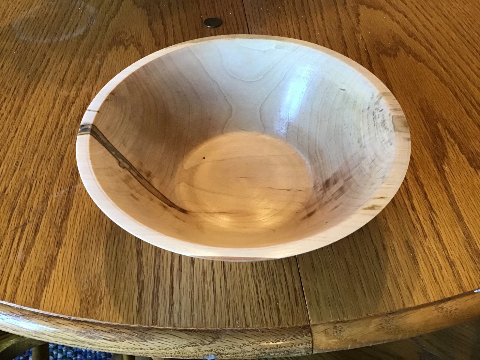

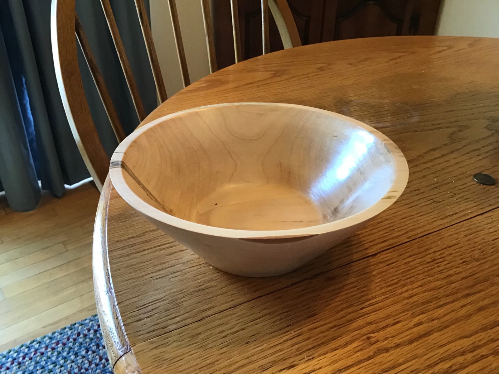

March 4, 20215 yr Author Popular Post comment_259607 2 hours ago, John Morris said: Sure do look like a high quality machine, I love it. Thanks. I have seen quite a few of this brand in YouTube videos I watch. I was a little worried at first but this had all of the features I was looking for. Everybody on YouTube seemed to like them so I went for it. I am very happy so far. Fit and finish is very nice. The headstock, banjo and tail stock all lock up very tight with little effort. Plenty of power with the 2 HP motor and it is very quiet. The rotating headstock can be locked in any position. That makes turning the inside of bowls a lot easier for me. I made this bowl today. Report
March 4, 20215 yr Author comment_259608 On 3/2/2021 at 4:52 PM, HandyDan said: When using a scraper the flat top of the tool needs to be pointed down hill to prevent a catch. The further over the tool rest the tool is the more likely a catch. Starting at 5:10 Sam shows proper presentation of the tool for bowl turning. Thanks Dan. That video helped a lot. I made a bowl today and used the round carbide on the inside to smooth it out. I raised the rest above center and angled the tool more and everything went smooth. Never came close to a catch. Report
