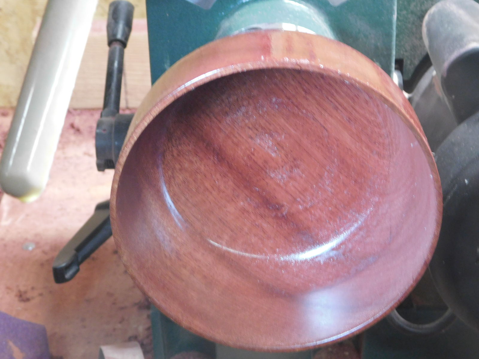

In the end the bowl did come out quite nicely....  here is the video of the whole thing...

Beautiful work sir....   well done.

The second purple heart bowl turned out pretty good too.  Made this one just a bit wider almost wasted ZERO material except for a bit of the rounding and hollowing.  Its pretty close to 6 inches maybe a little less.
