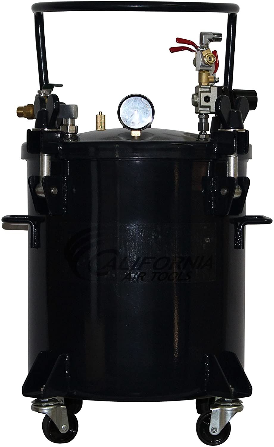

Well I just made the decision.... I just bought myself an early Christmas gift for myself.  It needed to be done not couldnt hold off on it any longer.  Seeing finances could change at any given time with what's going on I went ahead and bought my pressure pot.  I DID NOT buy a cheap harbor freight pot.  I went with the California Air Tools casting pot.  The one that was specifically made for casting.  I think that will be the much better option than the harbor freight pot and it will be worth it in the long run having something safe.  That's the update.  I did order it from amazon so it should HOPEFULLY be here Sunday with shipping how it is especially with the Holiday season in full swing.  Thanks for all the advice on this.

Got my new pressure pot today.  For something that's small and hollow it is quite heavy...  How ever its pretty well set up minus the air intake I've still got to put that on.  But in the end well worth the money I think.  Just gotta figure out how I'm going to make a mold for a blank.  What I may do is get a bunch of cheap plastic containers and use those for now.

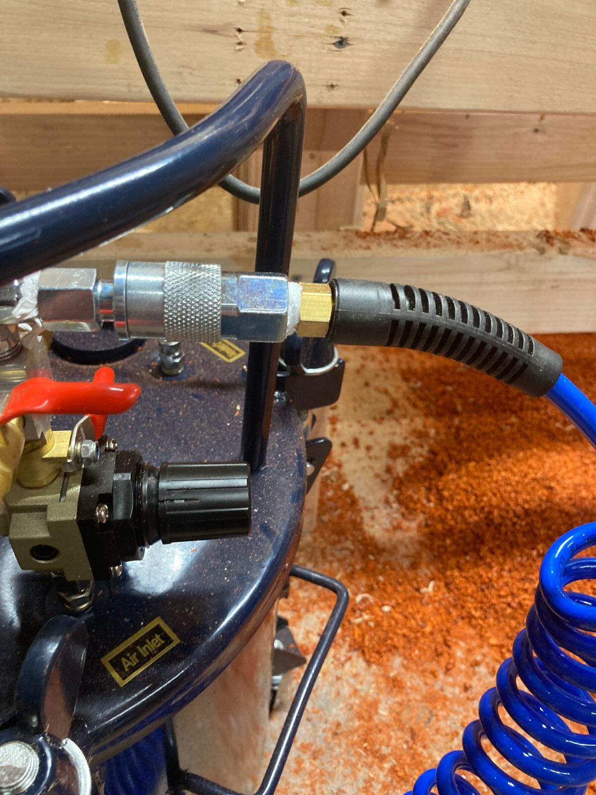

Once I got the right fittings for the pressure pot I got it set up.  I ran a small test run of air through the pot seemed to work out alright I didn't steep it too long just to make sure I got the fittings on correctly and properly done.  How ever I only took the air compressor up to about 50 psi just enough to get a test run in on the pressure pot.  I got the air line hooked up into the pot once I figured out which way to dial in the knobs and the ball valves everything was good to go.  Just gotta remember to let the air out gently when using for resin for the first time along with letting air in slowly.  Either way seems easy enough to manage with out any help.
So far things are looking up.  My air compressor can get the pressure that I need for the resin I didn't put the pot past its pressure pop off valve at all.  I've got it around I think 35 PSI at the moment on the first test run.  NO resin in the pot as of yet testing out how well it holds with pressure.   So once I finish up binge watching a couple episodes of my show on netflix I'll see if it still holds the same pressure.  Then I think I'll make a mold not sure if I want to do a small mold to test and do like say Christmas ornament sized mold which is probably what will happen for the first run.  either way things are looking promising.  When I filled it the first time I noticed a leak coming from the gasket sealing ring on the bottom of the lid made an adjustment and now it seems to be holding air quite well.  How ever we shall check and see if that's the case in about an hour or so.  Not sure if I'll need much more pressure than that honestly.
