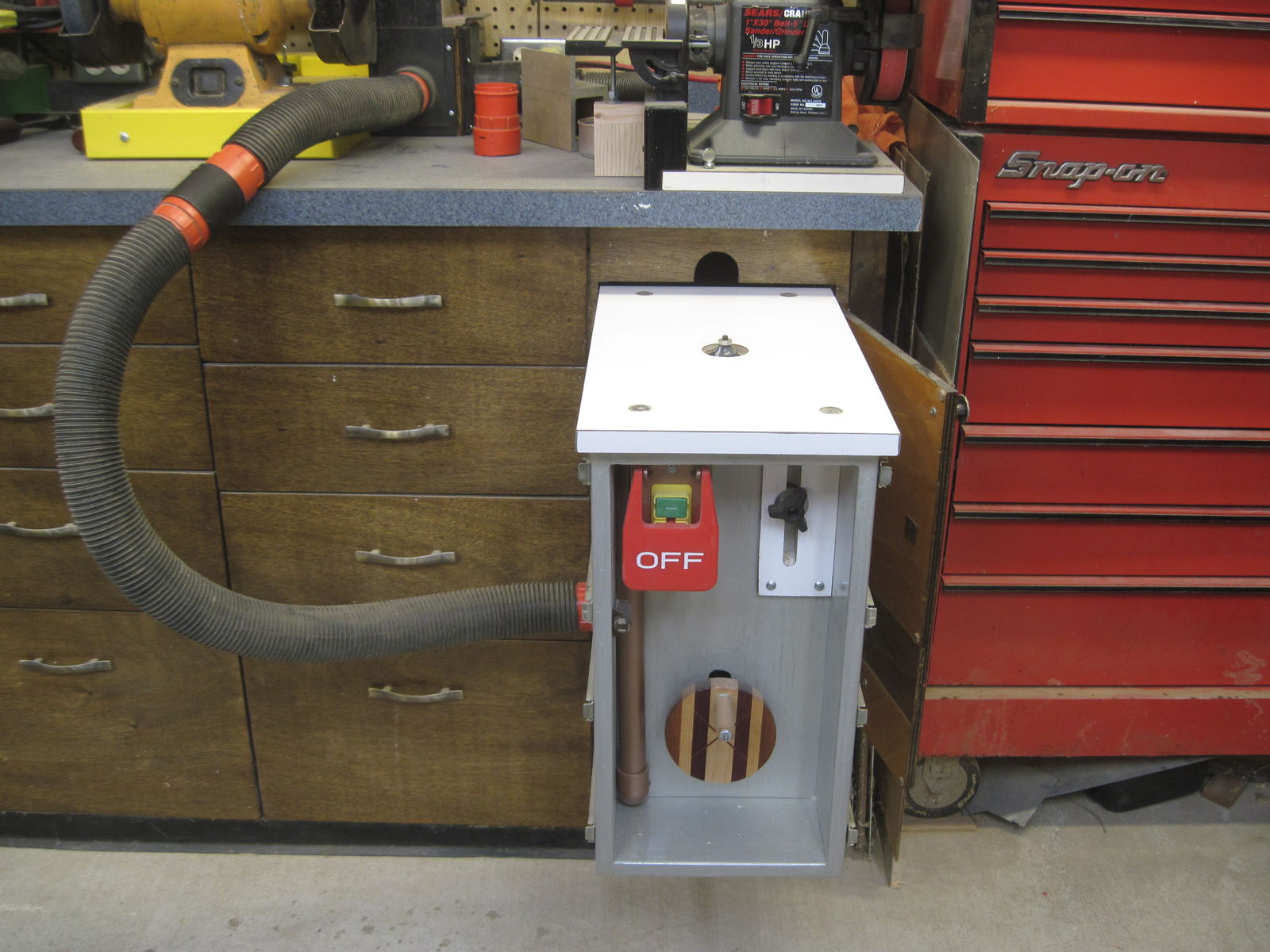

July 22, 20206 yr comment_236156 My wife accuses me of having a router fetish since I have 7 total but here’s my router table setup. Under the table top I have a Bosch 1617 ESV. I bought the top from MLCS and built the cabinet under it. I bought a second plate and took it to a friend’s machine shop and opened up the top hole to accommodate a raised panel door cutter. The Bosch is a shade underpowered for the 3 1/2” RP cutter but if you don’t get crazy deep cuts it works well. The lower cabinet has 6 drawers and double door storage underneath for all of my routers. Report
