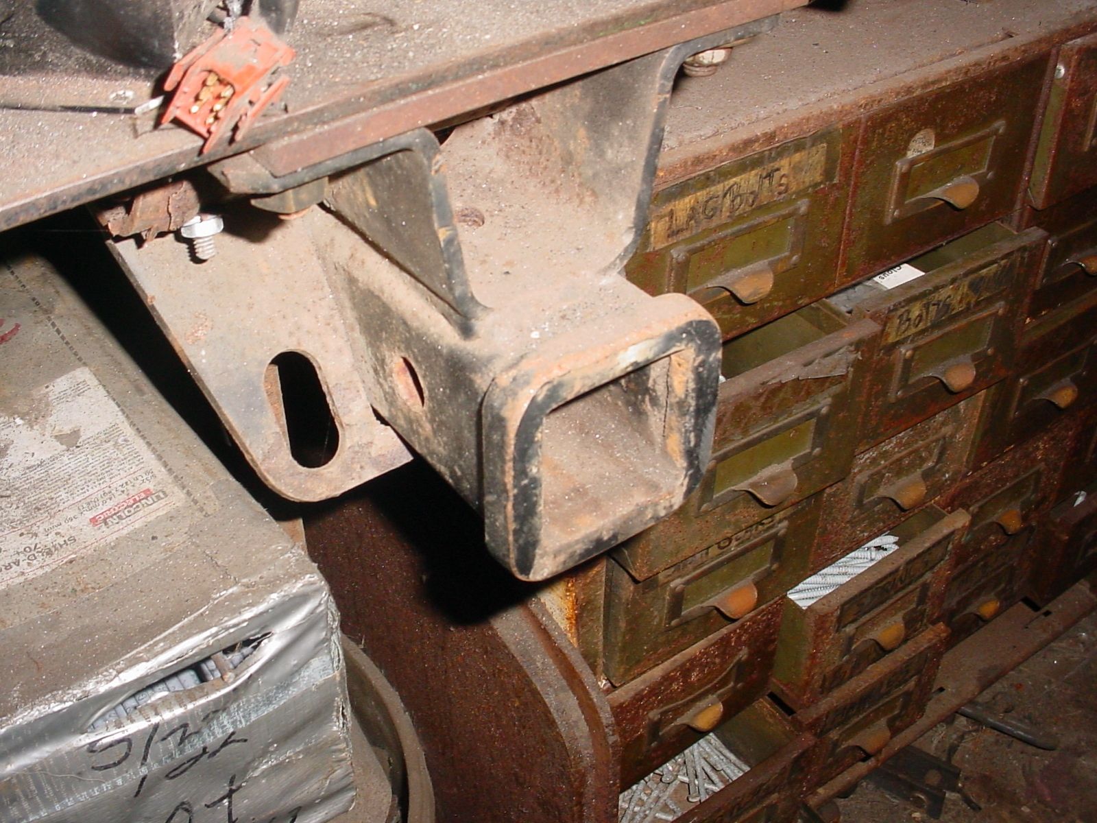

I'm a vise collector... I have class 3 hitches mounted on all my benches. I put all different tools on the hitch including vises...
