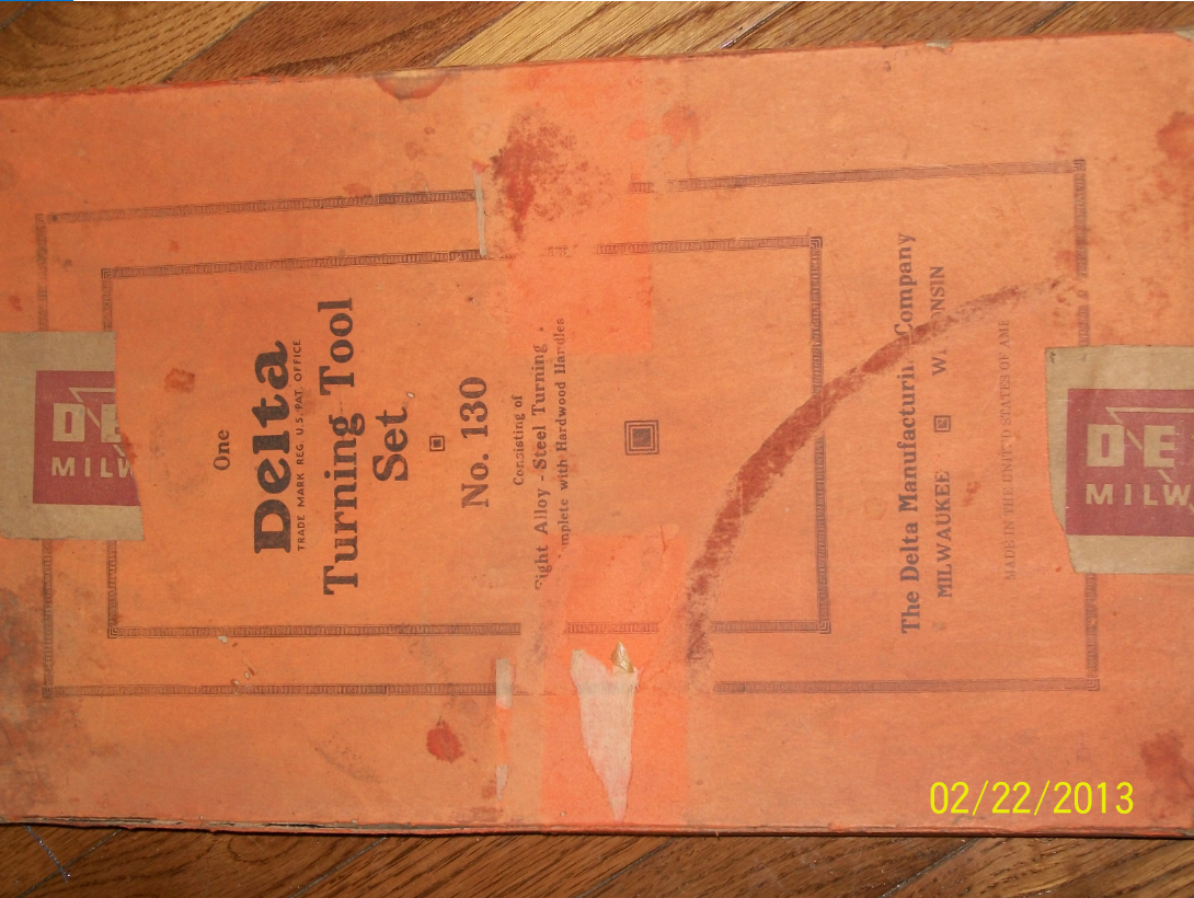

July 4, 20206 yr Popular Post comment_234197 2 hours ago, AndrewB said: @Larry Buskirk I've got a set of HSS chisels, how ever for me carbide has been a lot easier to work with rather than having to constantly sharpen tools on a regular basis. I've got three out of the four carbide tipped chisels that Delta offered during the early 40's along with the complete set of HSS that were given to me by a former co-worker that didn't like the way they felt when using them. I was by his place with another former co-worker and saw the box on a shelf above his lathe, and commented wow where did you find the old Delta chisels? He replied want them? They're yours, I don't like the way they feel. I don't argue with getting freebies, especially when they're collectables. I've seen the same sets go on eBay for over $100.00. Report

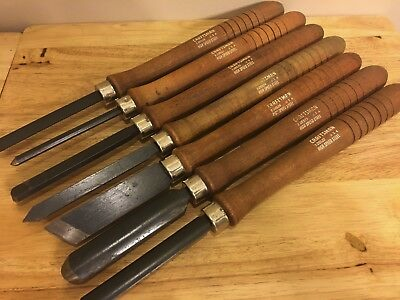

July 4, 20206 yr Popular Post comment_234276 Larry and Steve, it must be what we get comfortable with. I have this old Craftsman set and use them most often even though I have the Easy Wood Tools and an extensive set of Sorby tools. Report
