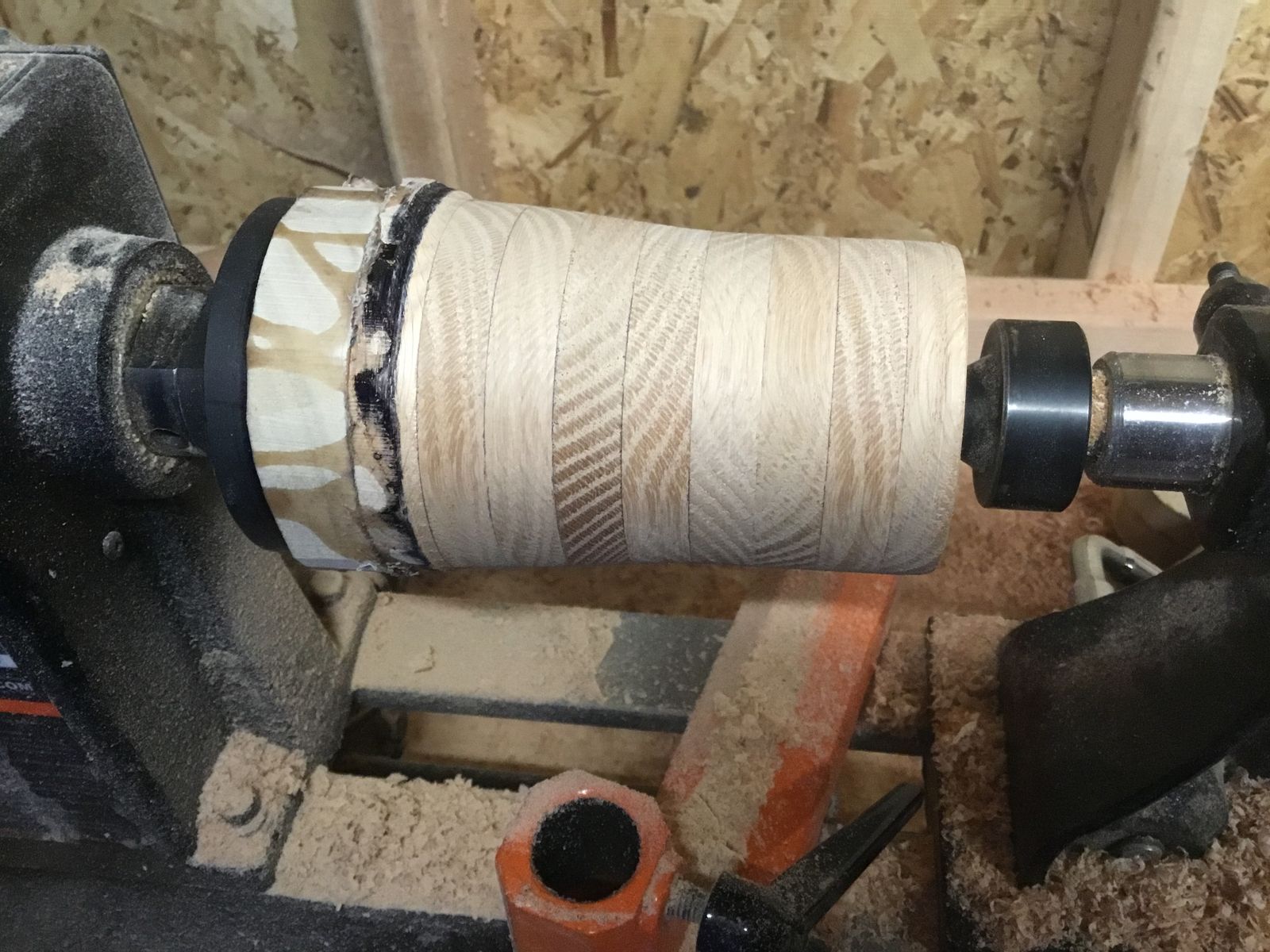

June 16, 20206 yr comment_232398 As my bowl project is temporarily on hold, I started up a new project this morning looking like it’s going to be a cup. Well now that everything is roughed out to the shape I want, both projects are on hold until I get my new chuck on Thursday. Either way a double bonus my lathe extension bed arrived today haven’t even un boxed it yet. The question on finishing is once I get to that point in order to make them both usable what time of finish would be safe to use with out getting some crazy type of poison from a finish. Recommendations are always welcome. So I have a couple days to debate on what I do and how I finish things off. But I would like to be able to use both items. Edited June 16, 20206 yr by AndrewB Report
June 16, 20206 yr comment_232400 Congrats on the lathe extension and the yet to arrive chuck. Looking forward to seeing them both in operation. As for the finish, it somewhat depends on what you are going to put in them. For non-liquids I usually go for mineral oil and beeswax. If you want a film finish, water based or oil based finishes (poly) are food safe when dry. If you plan on using liquids in the turning, I you're going to need either an epoxy type finish- like bar top finish or maybe a casting resin like Alumilite. Report
June 16, 20206 yr Author comment_232401 Okay I'll have to do some research on both of them. I'm not too familiar with Resin stuff all though I've been watchin a lot of videos on resin turning as well. Maybe one day I'll get into resin but at the moment that probably wont happen. The cup yes more than likely Id like to use it for liquid. Now is it like a wax paste resin that you rub into the wood after the stain goes into it is that how the finish works or am I wrong on that one. Report

June 17, 20206 yr comment_232425 @lew on finish "dry" in this case cured may be better. Until the finish cures it is possible to release VOC . Even at that food use I would wait at least 2 weeks. Report
June 17, 20206 yr comment_232426 Thanks @Gerald for the clarification. I should be more careful with my terminology Report
