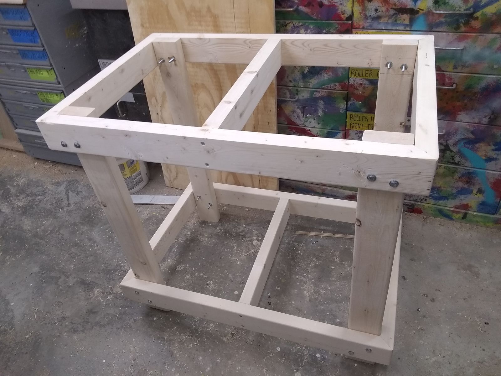

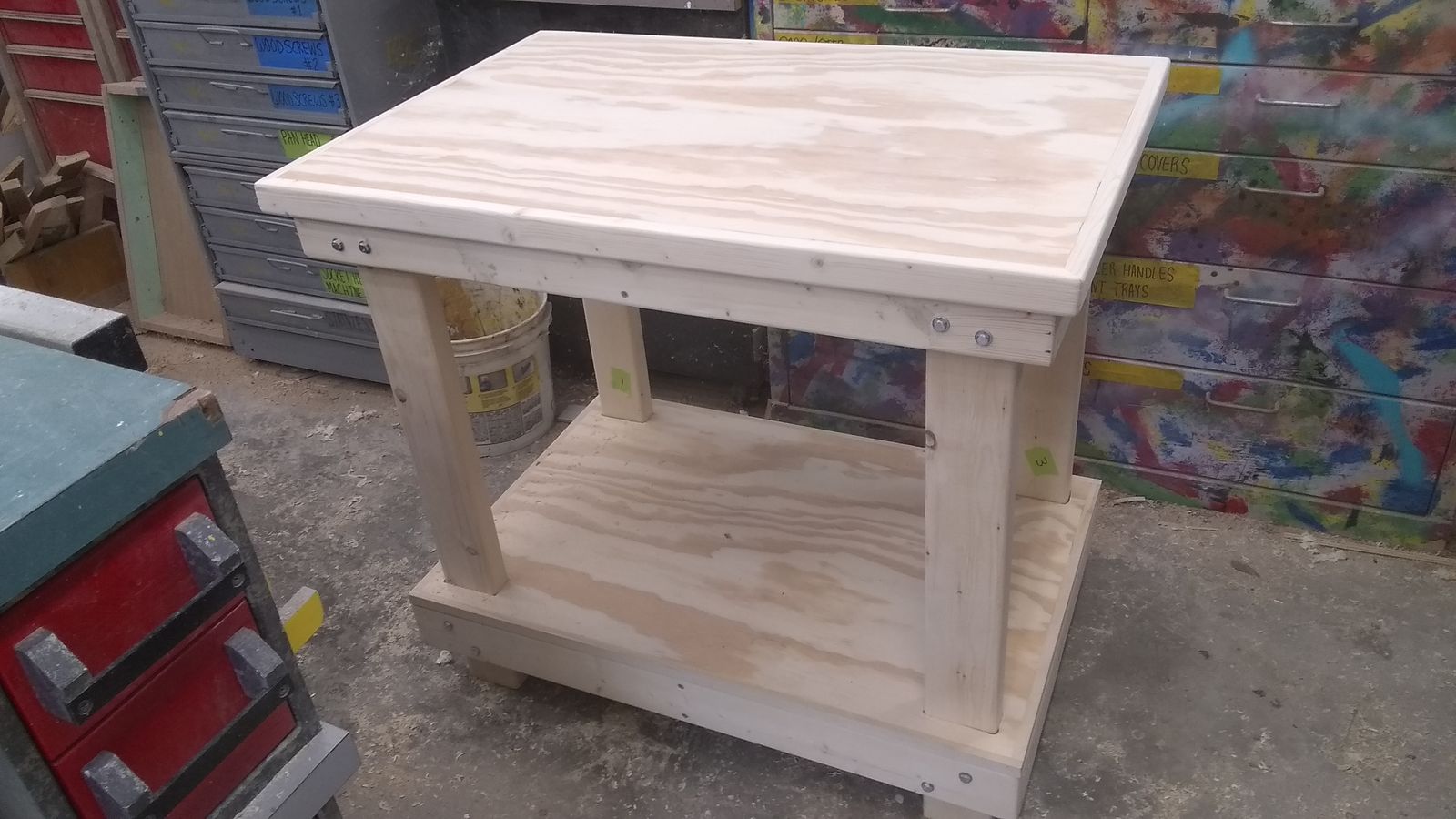

June 15, 20206 yr Popular Post comment_232231 Now that I have a 10x12 empty room to use for finishing work I decided to build a small bench to do the finishing on, and then put in a drying rack. Not wanting to take up alot of space I went with 24 inches x 36 inches for footprint and 32 inches high. No wheels, I can always revisit this if I want later. The frame is easily several times heavier than needed but I have a tendency to overbuild or over load a bench so more is better in this regard. Progress so far is a completed frame, sanded and ready for some finish. The top and shelf are currently getting edge banding with some pine that will take a couple of days to get all glued and sanded down then finished as well. Borrowing a idea from @lew and will add a removeable lazy susan 24 inches by 24 inches. Tried a mock up out doing last project and liked how that worked out. Report
June 15, 20206 yr Popular Post comment_232233 I notice you use bolts instead of screws. Do you have an oversupply? Are you using glue on these joints or planning for future disassembly? I like to use screw and glue to make a very strong joint unless it is a jig or something temporary. Report
June 15, 20206 yr Popular Post comment_232235 I’d like to rebuild mine and make the top a torsion type top. Over the years the plywood has bowed. That makes it difficult to get square/plumb/flat assemblies. Only thing I worry about is the increased weight and being able to move it by myself. Report
June 15, 20206 yr Author Popular Post comment_232236 2 minutes ago, Gerald said: Do you have an oversupply? Yes, got a case of 4 inch long 1/4 x 20 bolts from a van I cleaned out. And another almost full case of nutserts 1/4 x 20. Will take back apart for finish work then reassemble. Being that I always seem to come up with some change I rarely use glue on such work. Now the edge banding will be biscuits and glue. No nails or screws. 4 minutes ago, lew said: I’d like to rebuild mine and make the top a torsion type top. How far apart are the cross braces? On this one I am 16 1/2 inches between braces and 20 1/2 inches front to back. Maybe I should add two more and make the distance even less? Plenty of 2x4's left easy enough to add. I thought about gluing up a bunch of 2x4's and then use a hand plane for a solid flat top. The pins in my right wrist and arm asked me what was I thinking? Then to drive home the point started vibrating in revolt. Report

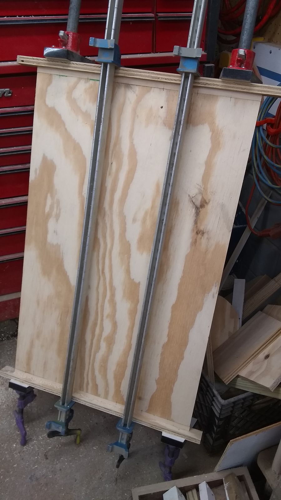

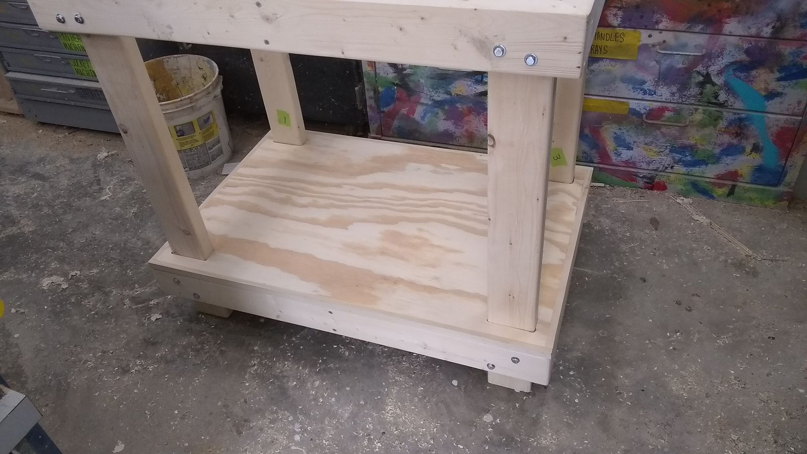

June 17, 20206 yr Author Popular Post comment_232504 Spent last two nights gluing edge banding to the top and bottom. That done I planed the edges and tops flat, rounded over all the sharp edges and light sanding of all parts. Bottom had 4 cut outs to be made for the legs. Top was easier to do, just test fit and it was done. Took a picture, marked the legs and such so I know what goes where and then started staining everything. Be a few nights before this gets put back together. Top and bottom will be screwed in from the underside, already predrilled pocket holes for this. Report
