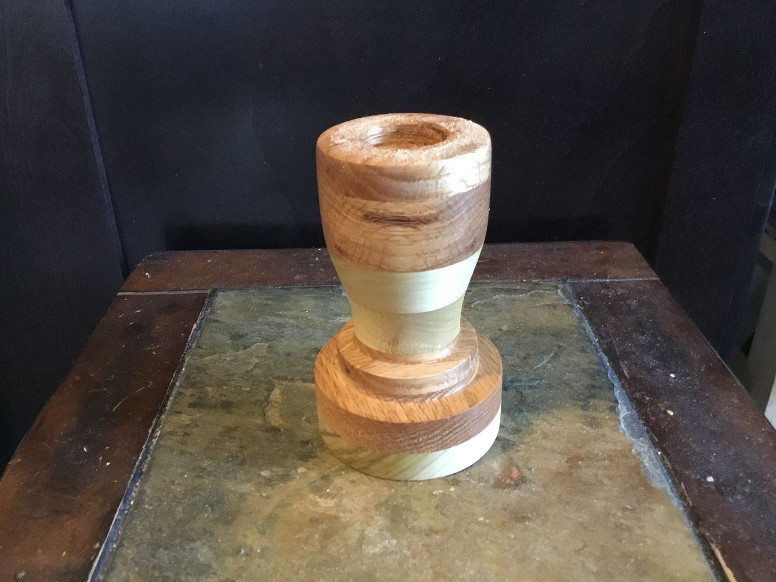

June 7, 20206 yr comment_231470 Lookin' Good! It's not always easy getting a nice turn when you have woods of diffenent species/densities Report

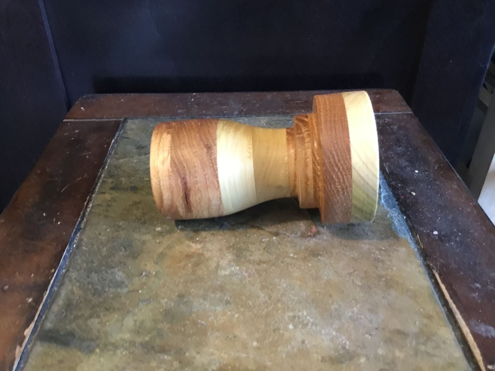

June 7, 20206 yr Author comment_231475 @lew That was a big challenge. I wanted Oak and Walnut to give a contrast of a layered look which I got. How ever when I started cutting into the oak I noticed that the chisel would more or less want to grab and make some pretty strange sounds like it was sounding dull, even though I was using the carbide tools. But it still worked out okay I think. I'm still trying to source a decent place where I can either order exotic wood species and of course the regulars like walnut cherry and such. If I could find boards big enough or order multiples of 36 inches that would be do able. Just gotta find a good source. I haven't found many stores around here that carries a lot of the exoctic woods. The stock that I have I basically purchased from home depot in the lumber section with the 2 by 4s and what not. Same section. So in other words deck planks. How ever I've still got a lot to learn with this. Still eyeballing on getting a bench top table saw as well. Report

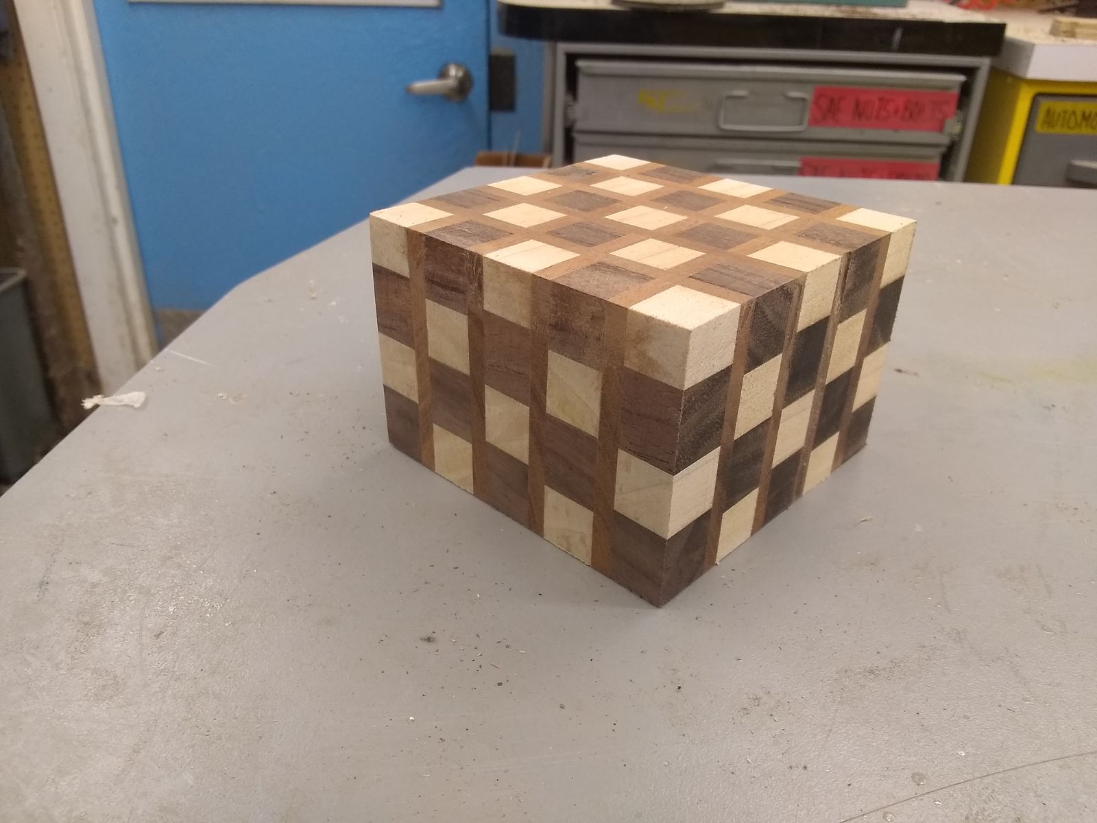

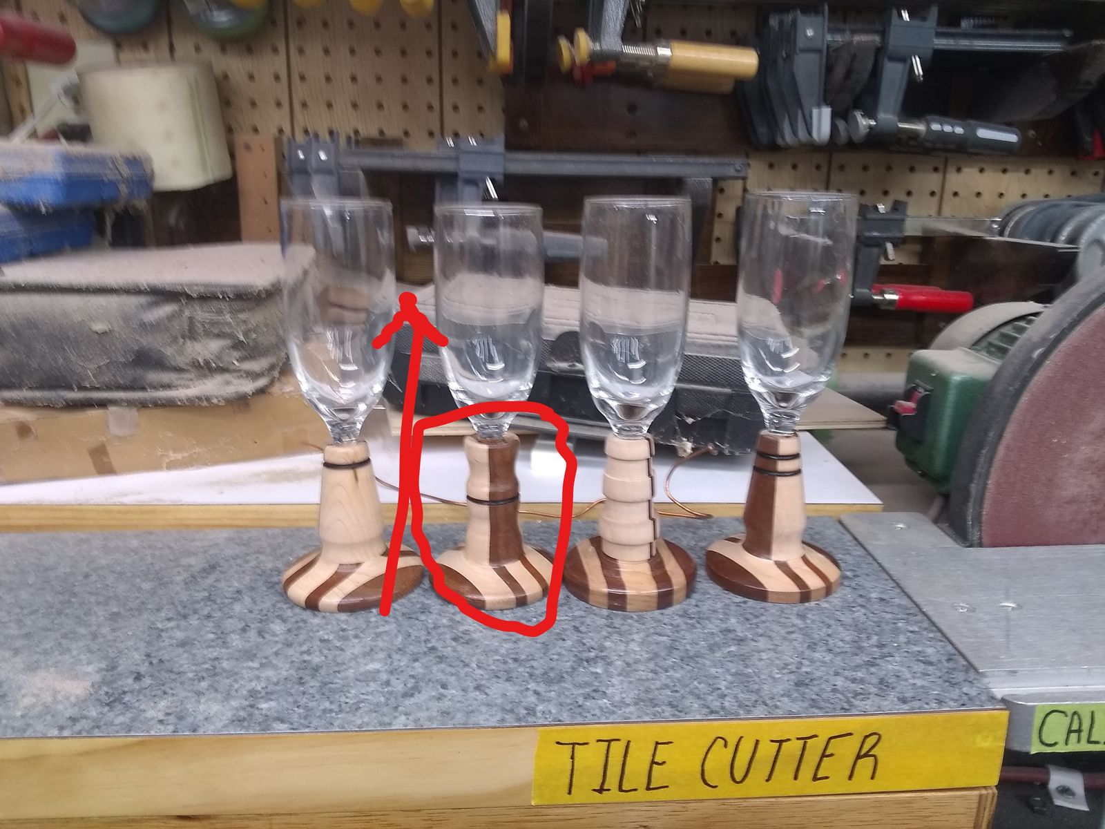

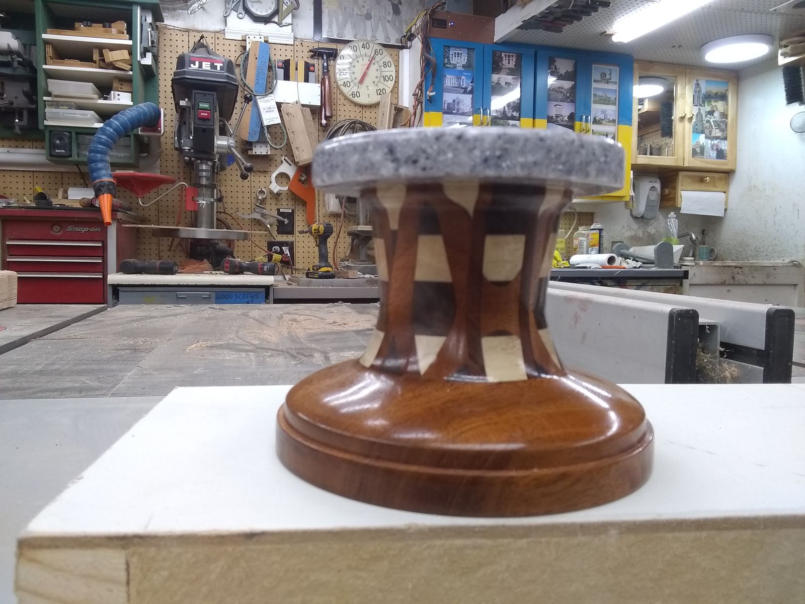

June 7, 20206 yr Popular Post comment_231479 23 minutes ago, AndrewB said: I noticed that the chisel would more or less want to grab and make some pretty strange sounds You should have also been able to feel the difference in the hardness of the different woods as you moved your chisel across the piece. If you were to have a diagonal piece thrown in you would feel a slight hump as the chisel hits that section. You also have a great deal of endgrain to cut with your wood blank glued up like this. Not a criticism, merely a observation and helpful hint. Try gluing your pieces so they orient like this picture. I can be all the same species or two different ones like in the picture. Much easier to cut and shape, especially in the beginning. A solid piece is always nice but I rarely have such and prefer laminates myself. Below is NOT a challenge, merely a demo piece for you to see. Started with gluing small 3/4 strips together into a board then cutting piece of same board to length and gluing again. This was all created with scrap pieces of various hardwoods I had in stock. After being turned here is what it looks like. The base is 3 pieces of mahogany glued up together. No large solid pieces used. Just some scrap strips. Report
June 7, 20206 yr Author comment_231483 Yes I did feel that transitioning into the oak wood. Which I have an abundant of at the moment.contemplating on attempting a small vase with the stock I have left. Report

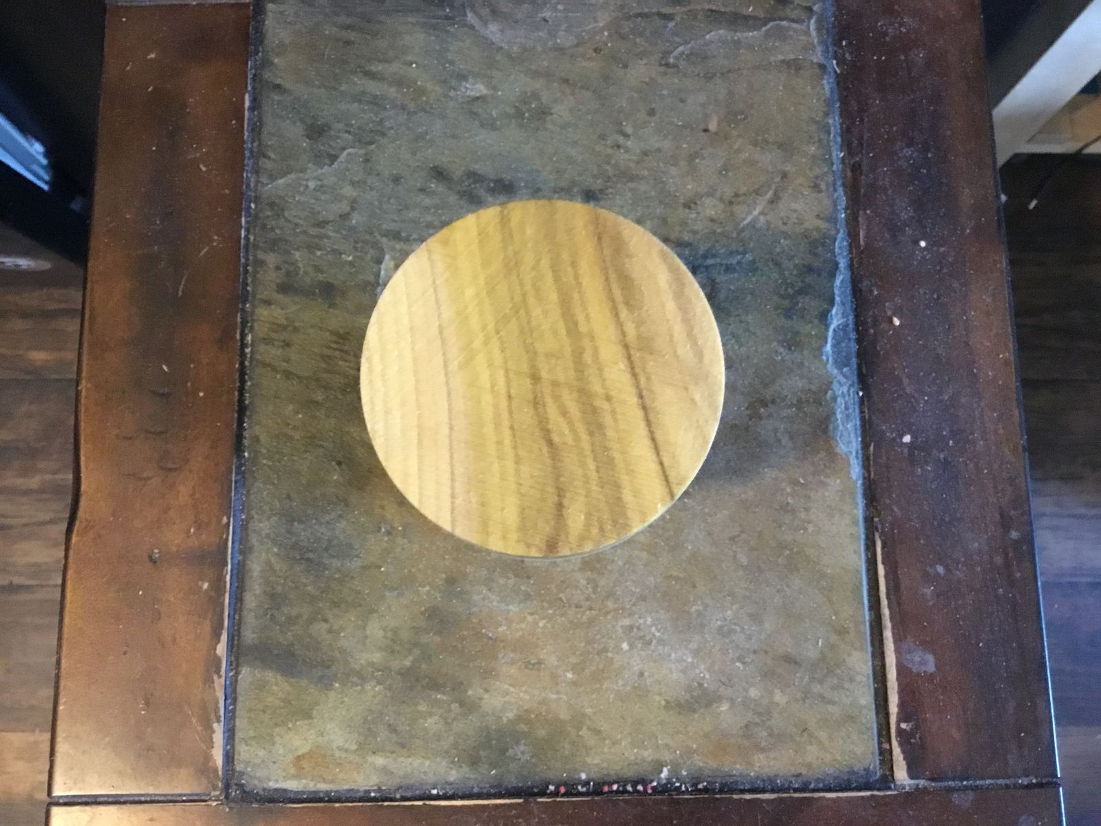

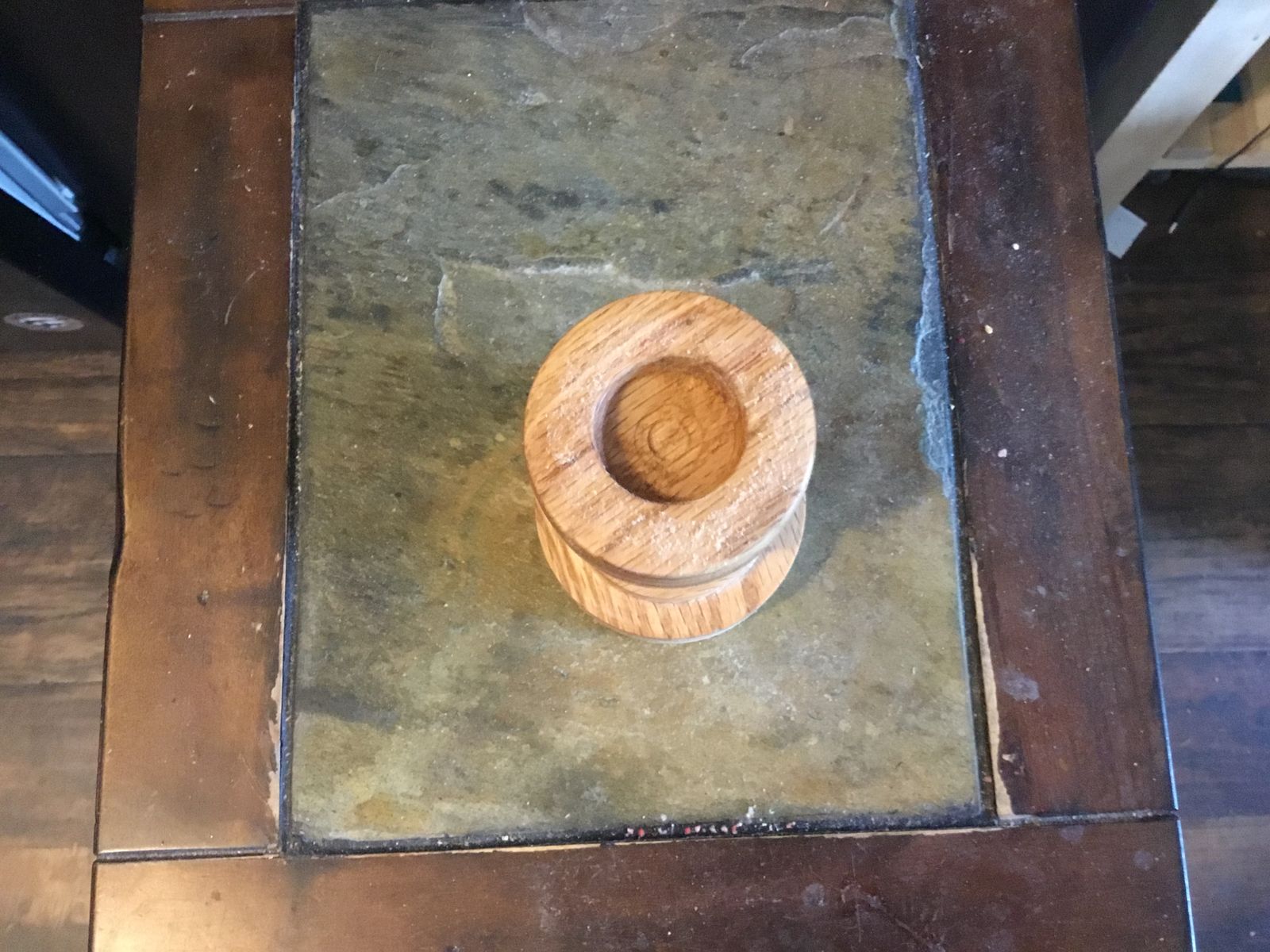

June 7, 20206 yr Author comment_231492 Just cut the finished piece off the lathe, when the bottom dries I'll slap a couple shots in here of it. Another successful piece. Report

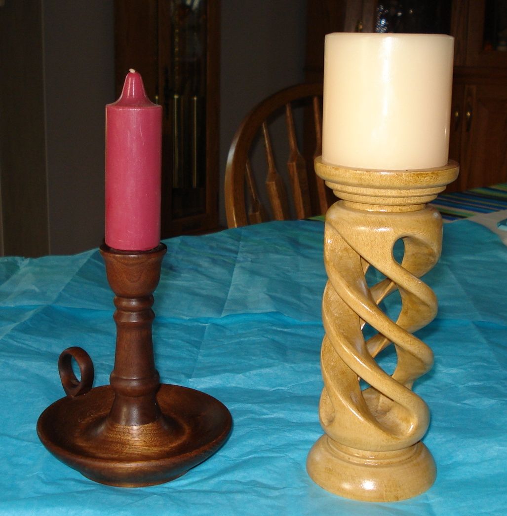

June 8, 20206 yr comment_231503 Andrew you are making progress. Carbide is not all created equivalent. Some types stay sharp longer than others and that may be what you are feeling. Cutting dry oak is not fun with any tool, so just bear with it and keep trying. Lets look at the styles you are using. Look at some other designs in bowls and similar turnings and you will see a common bond.......no flat spots. I could show this better but here goes. Take a pencil and hold it parallel to the length of the piece and rock it forward and back. If there is a flat the pencil will hesitate on the flat. Round overs and other round line turnings give a flow to your work that you will enjoy . So now you can practice this one . The point is to build upon each item to enhance your turning . Report
