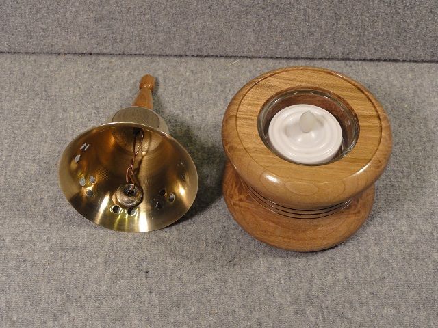

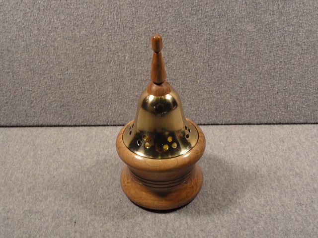

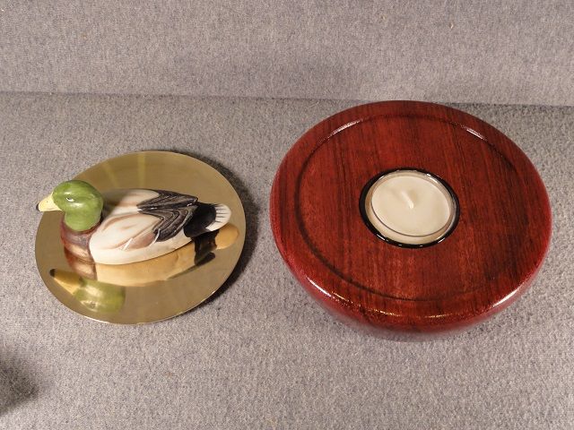

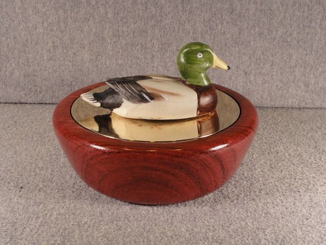

June 8, 20206 yr comment_231579 I like to use the tea light candles. You can buy the glass liners and make the holder big enough to fit. The battery candles fit too. Here is a couple I enhanced with a bell top for one and another with a duck which I call "On Golden Pond. Report
