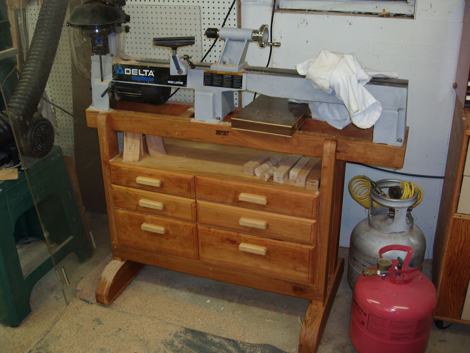

  • I built a stand for my Midi, first lathe, with extension. It worked well . Had sand in the bottom box for weight. As to height. Measure the height at your elbow bent and that should be spindle height. Measure on lathe the distance from lathe center to bottom of base, now subtract that from the spindle height and that is he top of the stand.P1271604.JPG.00beb37740ce75056235e0780c7849d5.JPG
