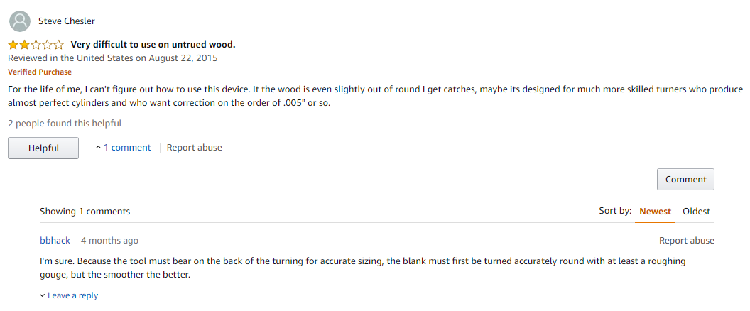

Has anyone ever had good results with this type of sizing tool. It's supposed to make duplicate tenons/parting cuts and I keep getting tearouts/catches when I try to remove the tool. By the way, without the spacing arm, this parting tool(1/4") cuts like a dream.L1010548.JPG.95fa12c61809e647830b0b366ef0d1d6.JPG

Never used this tool so I'm just spitballing here. Could it be that the tool is for setting the final diameter? Do you get close to the desired dimension and then use it for the final turning when turning several tenons of the same size?

I tried to use it for the final dimensions but it would always catch and chip the wood. I guess practice makes perfect. Thanks for the very fine links......... You da man!!!
I re-looked at the video and some of the images. It almost looks like the point of the parting tool (or bedan) is slightly above center on the work piece. I wonder if that makes any difference? Maybe you have already tried that.

Lew, I've tried this tool in all positions and couldn't get a good cut. For me, the hardest part was removing the tool once the tenon was cut. I have the Sorbey sizing tool (3/8") and purchased the one, pictured above, online for less that $10.00, including shipping, and the parting tool shown is the best of my 4 parting tools that I own.

Getting here a little late. The video is a bedan so not a lot of relation to a parting tool. Sizing with a tool like this probably requires getting moderately close first. I would approach like a peeling cut instead of a regular parting cut. I think that is the reason for the drop down protrusion. The drop down would engage the far side first and then use your ABC's .
     1. Anchor the tool to the tool rest
     2. Rub the bevel on the work piece
     3. Cut, but on this try to do it gently. If you push in to fast and hard that is where the catch comes in.
