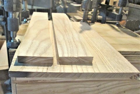

Well, that should be enough tags. :SaluteandRun:All that resaw work, to get some use out of leftover Ash....:ChinScratch:.

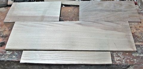

Gave me a few decent boards, about 5/16" thick...after a good planing, to get things smooth...Laid out a few parts :ChinScratch: that the Single Brain Cell Sketch Up could come up with a "plan":WonderScratch:
Figure these can be drawer parts...:WonderScratch:
2 parts for a lid, 2 parts for the ends of the case, and 1 part for the back...B)

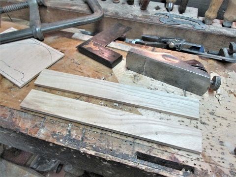

Will need to joint a few edges....these two for the lid..later.   Right now the ends need worked on..:WonderScratch:
Also, need to cut the back piece to match that skinny piece out in front...as for the 2 ends?:ChinScratch:
Yeah, these two. :ChinScratch:  Both edges got jointed, so these match.  As for length, there was a problemsky....:ArguingSmileys:
Shorter of these 2  was not square, on either end..and the longer one need to then match.:BangingHead:   Also needed to trim the "Back" to match the front piece for length.....you would not think it would take so long to saw through 5/16" of Ash....:OldManSmiley:

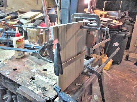

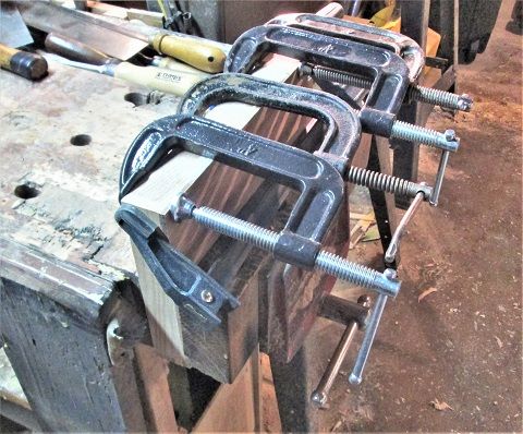

3 clamps ( over, under, over pattern) a caul at the top and a c clamp...vise holds things still while I clamped it up....had to flip it end for end...and caul was added.   the vise now acts as a caul.  will let this set a day, or so....need to lay out some finger joints, and make sure they hide the grooves on the inside...trying to decide on a bottom for the case....might just be some 1/2" plywood, with a Ash  edge....maybe even a molding, in Ash.    2 drawers need built, using finger joints, and a nailed on bottom, hidden by the front of the drawer....need to find 2 drawer fronts, that will fit.  :ChinScratch:

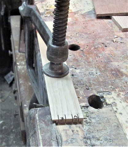

Marked a lot of lines, sawed a lot of lines....needed a way to protect the top of the bench..
Then I can set the blank on the "Chopping Block"..:JawDrop:
Clamp these both to  the bench...and chop about 1/2 way through...
Then flip the blank over..

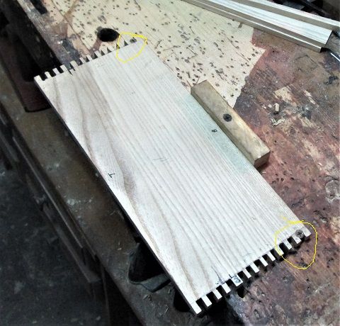

And complete the chops....then use these to lay out for one of the sides, saw, chop, flip, chop..and then a dry fit...:ChinScratch:
One back corner is done.  Will do the same for the other back corner, trying to get them to match...we'll see.  :ph34r:

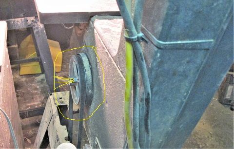

Ok, Tuesday is here...tried about 2 hours in the shop..had to fix the bandsaw right off the bat..
Seems that pulley was throwing the belt.  Pulley had migrated inside that "cup".   Allen wrench and a big screwdriver to move the pulley back out,  also, now I barely hear the saw run...quiet as a mouse.

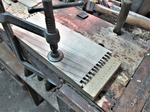

And chopped...Then issues with the matching fingers.....had to re-cut...ends will be 5/16" smaller, is all.  Dry fit?

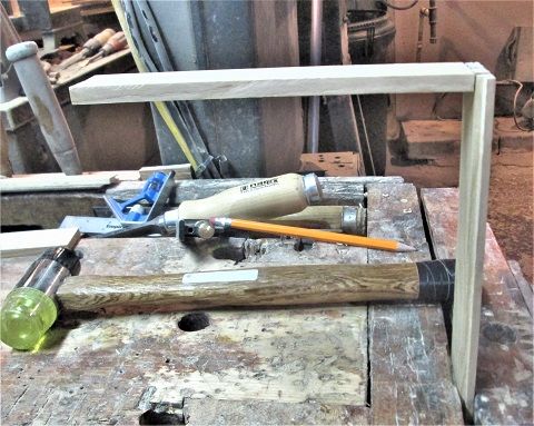

Back is almost done....needed to lay out the front parts..

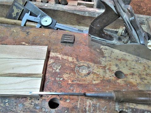

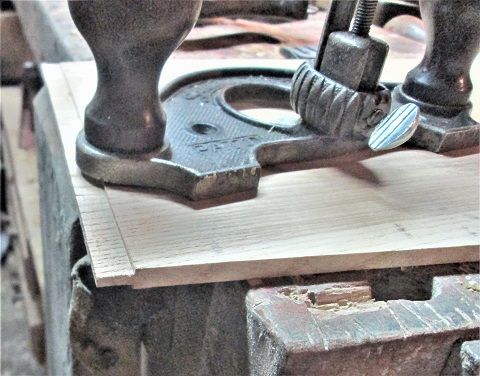

Set up the Stanley 45..
One groove across the back
Depth of cut was a bit fussy.   Reset a hair, do the two ends.   Their grooves are for the drawer divider to sit in.

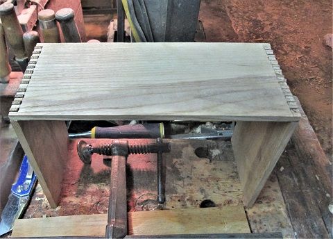

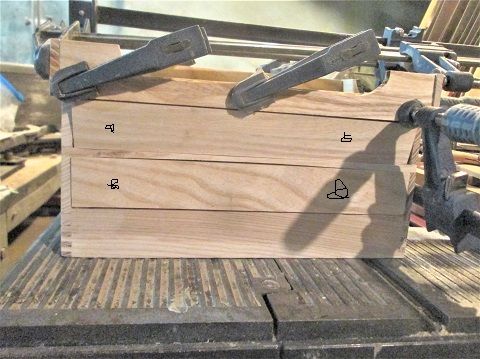

had a mark to make sure I didn't cut one too many...Dry fit?
One end done, then do the other end....then a dry fit with clamps...
And, you can see all the grooves.   This is how the case will sit on a base...

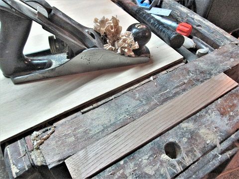

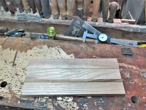

Cut the plywood to make a drawer divider....needed to joint the sawn edges a bit..:OldManSmiley:
Then a dry fit...then cut another plywood piece to almost the right size, for the floor board..
Which also got planed square, and to size..B)
And a test fit....then take all of this apart, clean a few spots up...:ph34r:

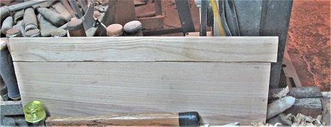

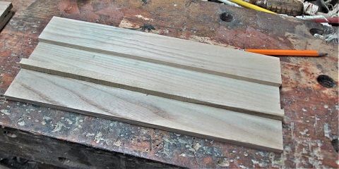

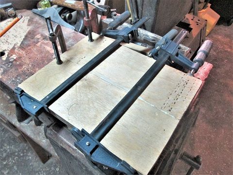

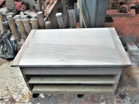

Lid came out of the clamps yesterday...Have it rough cut for length, now.   Needed to joint an edge, on it...and an add-on piece....as the lid is not wide enough..then do a rubbed glue joint:ChinScratch:

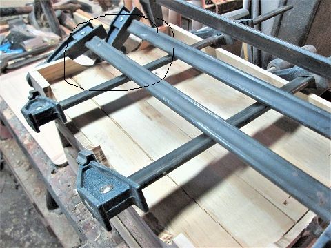

Yep, there IS a glue joint there...look where the arrow is.   Decided to add some clamps...:WonderScratch:
About all the clamps I had left..Sandpaper is folded over, because that clamp likes to wander off, while I am trying to tighten it down...Vise as a 3rd hand, and a caul..
bench is now filled up with glue ups...guess I'll have to stop for the day..:ChinScratch:

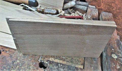

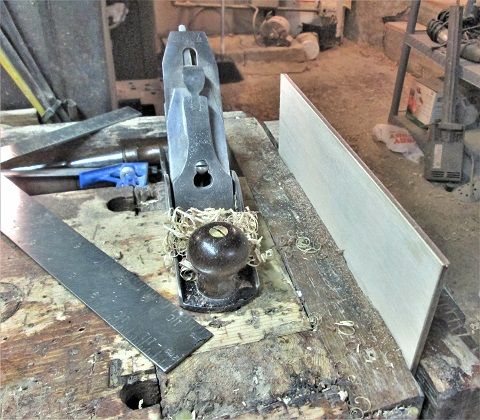

Then the front...the divider for the drawers was a bit too fat....thinned it down a bit with a block plane, and cleaned up all the joints..:OldManSmiley:

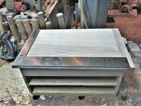

Then that lid....for right now..
I'll clean this up, tomorrow....wanted to make sure it was big enough...:JawDrop:
Will trim it down a bit.   Still debating using bread board ends....Drawer blanks were set out, too:ChinScratch:

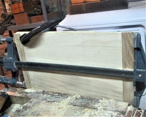

Then set aside...then that lid..:BangingHead:  Out of the clamps, and then try to trim it to size AND square..:DevilLaughing:
Sanded and planed flat, because it will get bread board ends.....tablesaw to rough the tongues to size....then a wee bit of Routah work..:JawDrop:
Oh look, a cordless one!  :TwoThumbsUp:  Not a whole lot of room for error, either...B)
As that lid is barely  5/16" thick.   Then a test fit for the ends...
had one spot, that was too thick, and split the groove apart...more router work, and make a new end piece  :ArguingSmileys:  Holding this lid in place on the bench was a bit..tricky:DevilLaughing:
Finally...got things to fit...so a glue up was done...:TwoThumbsUp:
With the vise acting as a caul, too...C Clamp on the top is another caul...let this sit til tomorrow. :Tapping:

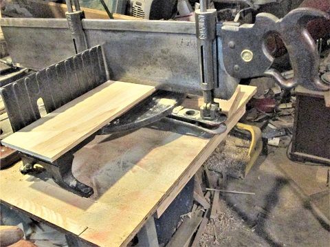

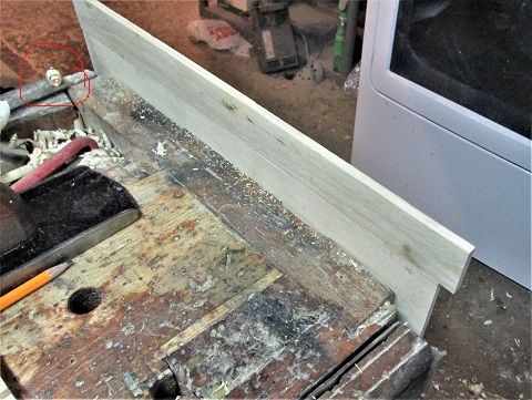

Used the #358 Mitre Box, to trim two drawer front for length...:ChinScratch:
Doe to the clamps, case is sitting on it's top....May switch around the fronts.....working for the best grain details...also,,dug out some blanks...:ph34r:
Once I get the 2 skinny ones cut to size, I can rip two more for the ends of the case..Moldings...:WonderScratch:

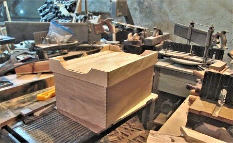

Got the lid all cleaned up...:OldManSmiley:
There was a slight problemsky....:BangingHead:
Not square.   Buzzed the excess off, to make it square....then rounded the corners a smidge..:ChinScratch:
And figured out which hinge to use... Then worked on the case itself,,,as areas were NOT too square, either..:BangingHead:

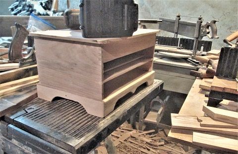

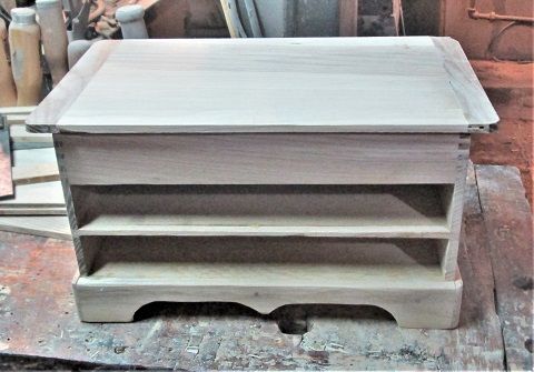

Needed the sides and the plywood to be flush with each other....so the "molding" would fit
Front gets a fancy cut out, the back does not...once these are all dry, will be rounding the corners where they meet....B)
Ends also got a cut out....I will be adding a glue block in each corner, later....Set this aside. to where I could work at the bench( hate getting cramps in the toes.:o.OW!)

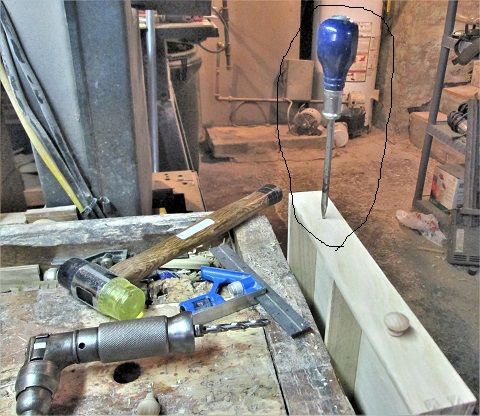

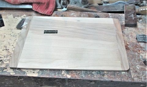

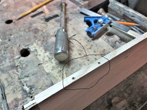

Time to install the hinges?   Pilot drill was in the shop..:TwoThumbsUp:
About 6 turns per hole. hinges are 2" in from the ends of the lid....screwdriver to drive them TINY screws...was upstairs..:DevilLaughing:...toe cramps made THAT a fun trip..:ArguingSmileys:

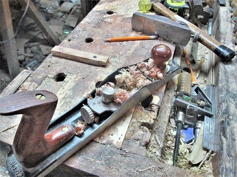

Clean up time...and shape the corners a bit,,,and remove a few lines of dried glue..
had a squeeze-out, or two...needed to plane one area flush...
Molding was higher than the plywood floor, can't have that.:BangingHead:.so:ph34r:
Now flush.   Molding corners are all rounded.  Plane added a slight champfer to the top edge of the molding. Time to add the lid?:ChinScratch:
I found out the 6 turns of the push drill is just enough, as 7 was too deep....oops :o close the lid..:OldManSmiley:
Set this aside.  2 out of three tasks are done.  It's that third one that's a royal.....:ArguingSmileys:

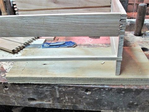

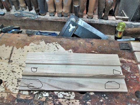

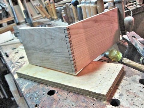

Drawer fronts needed a rebate, to house the drawer's bottom....test fit..
Next, front needed fingers laid out..
Sawn, and then chopped, with some "finger tools"..:WonderScratch:
Then repeat where needed, to connect the front to the sides..

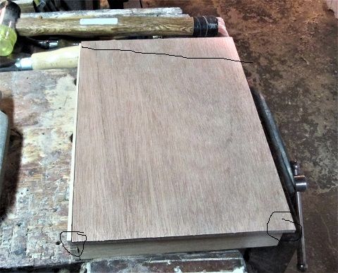

So I can size the plywood panel to the drawer...
One edge out of square, too long, too wide...about normal, lately...:BangingHead:

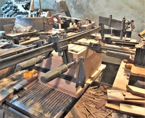

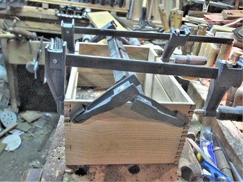

Got that fitted to the drawer..spread some glue.....

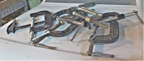

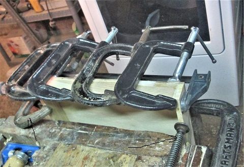

Was just going to use nails..the Ash vetoed that idea...so a few clamps and the vise were used...
Turned out, I needed 2 more clamps...even a Craftsman clamp was put to work...
Well, that end the shop time...just over 2 hours, again..set the case aside, out of the way...
Doesn't even rock....must have the feet just right..for a change.:DevilLaughing:

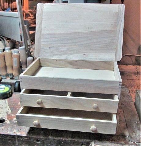

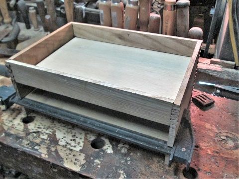

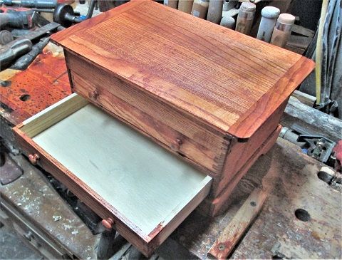

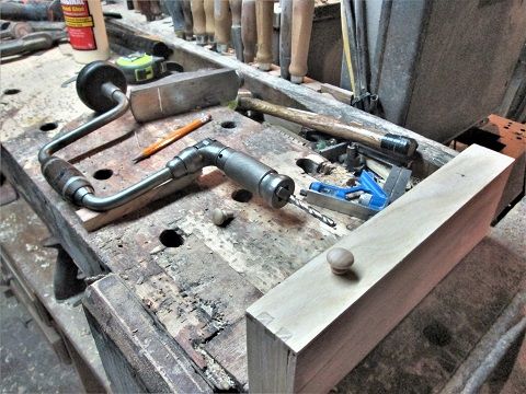

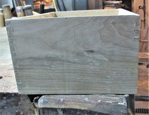

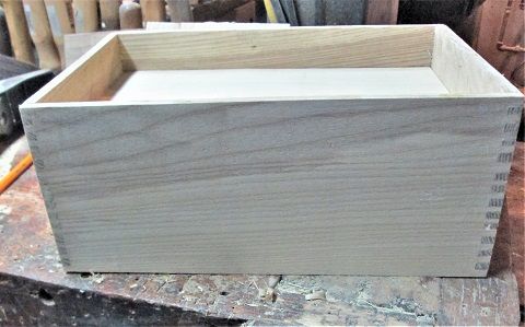

Ok...here we go...Clamps came off the drawer glue up, today ( Started @ 1415Hrs, end at 1625hrs)
Have no doubt these will so been back in use...Drawer was then cleaned up..:TwoThumbsUp:
Glue joints sanded smooth and flush, test fits ( a LOT of them) showed where to plane or sand to get a decent fit...:ChinScratch:
Once the drawer did slide in, without any binding, decided to add the knobs...B)
That drill bit is just a smidge too big. :BangingHead:  Glue into the hole, glue around the knob's tenon, roll the glue smeared tenon into the bit of sawdust..
And clamp in place....was the only "clamp" I could spare....set this aside, for now..:TwoThumbsUp:
Other drawer:  :ChinScratch:
same as before...seem to be getting better at these things? :TwoThumbsUp:  I also used the finger joints to attach the back of the drawer..all four corners are done..
Next?  Well, it involves these two items..:ChinScratch:
Glue and the bottom of the drawer...and a whole LOT of these things..
Even needed a few more..:o
Might have missed a spot..:WonderScratch:..was about done for the day, not pushing my luck.:ph34r:...removed the clamp from the knobs, and slid the drawer closed..:TwoThumbsUp:
One more drawer to do...Stay tuned..:cowboy:

The other drawer came out of the clamps today....had some handplane work to do..:ChinScratch:
1603873233_2drawerchestfancyplaneandshavings.JPG.8b988ee5c0c6bc9d2b06c1f9a8a57ec2.JPG
Used both planes...other spots needed sanded flat.   And a few test fits to find where things would bind a bit...added a middle divider in the drawer, to correct a bow from a clamp, the time for the handles/knobs....
find a centered spot 2-1/4" in from the edge.   Brace has a "normal" twist drill bit
To get the drill bit to start in the right spot..
A few good taps does the trick...holes fit better..
Just the idiot that added the glue..used too much on the first one...:BangingHead:
So, how does this project look?:WonderScratch:
And..:TwoThumbsUp:
Remember this few...as a coat of stain was soon applied...
Not sure IF I'll stain the inside of the drawers, takes forever to get the smell out..
May call this a PIP?:TwoThumbsUp:
Not sure what that line is...seems to be a part of the grain?:ChinScratch:
Top drawer, and..
Bottom drawer...and..
Let this sit and dry a while....before a coat or two of clear gloss poly goes on...:ChinScratch:
Almost done...:TwoThumbsUp:
