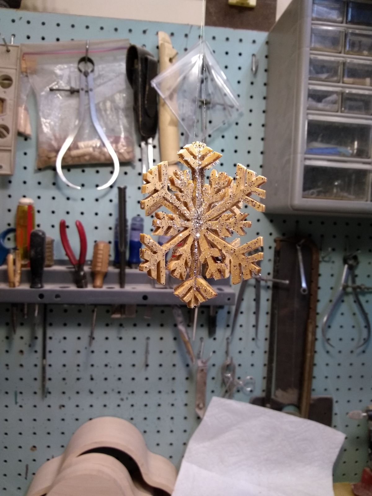

This one has 4 sides epoxied together then sprayed some clear then sprinkled some silver or chrome glitter. Not much just enough to make it sparkle a little but still leaves the BB showing through...The picture don't capture the shine but it does.IMG_20191107_153057187.jpg.e4e3d1b0cd0f1673bbc6db87b10b7977.jpg

Very nicely done...

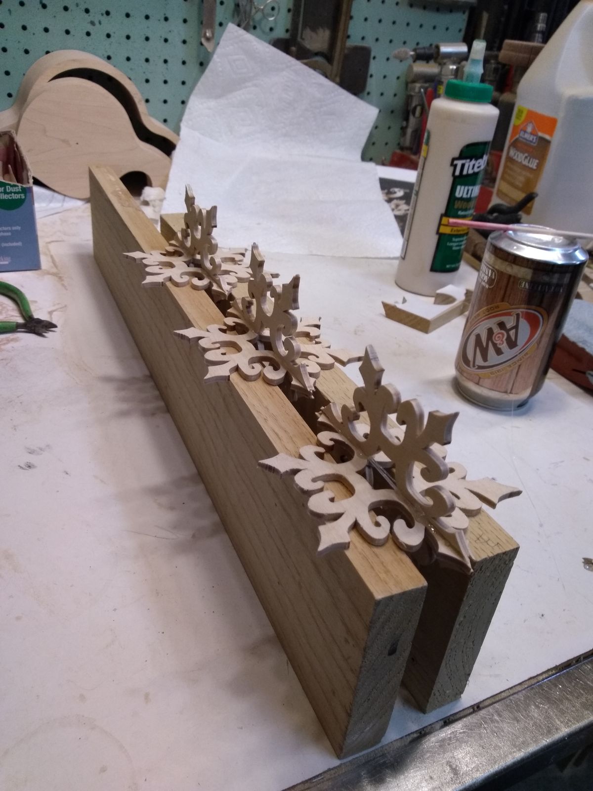

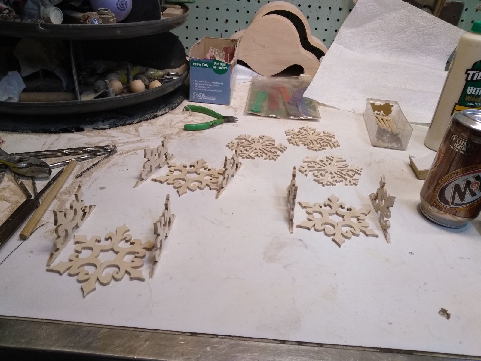

Here is anotherIMG_20191108_103205991.jpg.d82b9da879798d02df2f98e95d969218.jpgIMG_20191108_111304391.jpg.c010a51c21059bdd3f0d08412ef87516.jpg

Wow!  These look really nice.  I have a couple,of small projects going right now, but when I’m done, I’m going to make an attempt to make some of these.  Nice job.

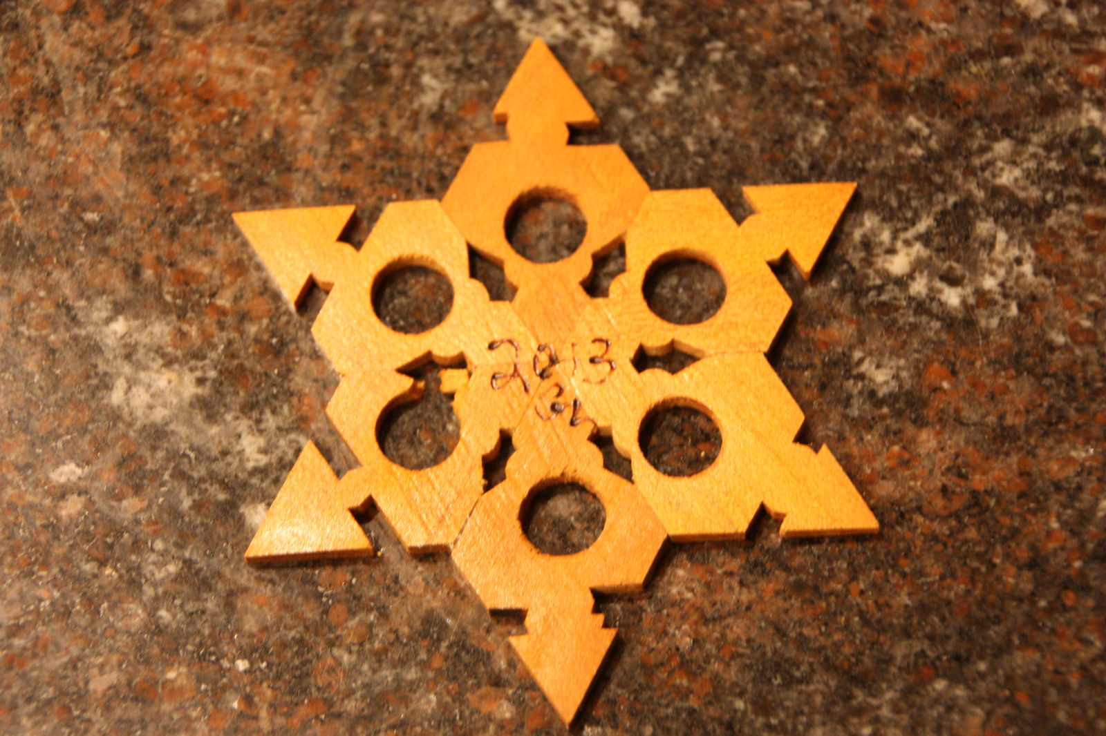

My wife and I alternate making ornaments for the grandchildren every year.    A few years ago, I made some of these.  You need to cut two pieces to shape, then cut in thirds, glue them up, then slice off the flakes.   Very easy.
