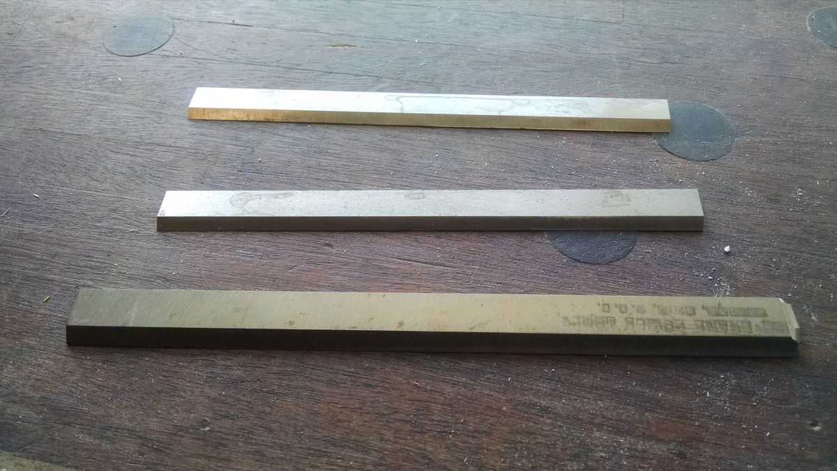

John Morris Posted April 28, 2019 Report Posted April 28, 2019 Larry what a nest find my friend. You know, that manual feed is actually a great idea, you have built in variable speed, slow it down for figured lumber and shove it through for lumber that don't matter. Much better than my 745 Dewalt with two speeds. Heck you could have 400 cuts per second just slow it down. Whatcha got planned? Artie and Grandpadave52 2 Quote

John Morris Posted April 28, 2019 Report Posted April 28, 2019 15 minutes ago, Larry Buskirk said: These machines are heavier than they appear due to being Cast Iron. It looks like a bulldog. Can you give me the dimensions of the blades? I have a stash of NOS planer blades that date waaaay back. Grandpadave52, Gunny and HARO50 3 Quote
John Morris Posted April 28, 2019 Report Posted April 28, 2019 Just now, John Morris said: Can you give me the dimensions of the blades? Or link to the manual. HARO50 and Grandpadave52 2 Quote
Larry Buskirk Posted April 28, 2019 Author Report Posted April 28, 2019 (edited) 1 hour ago, John Morris said: Or link to the manual. Alien Planer 103.1801.pdf Sears part # 10921 Edited April 28, 2019 by Larry Buskirk Grandpadave52 1 Quote
John Morris Posted April 28, 2019 Report Posted April 28, 2019 Hmm, that doesn't give a whole lot of info on blade size, I can take a picture for ya and give you dimensions of the blades, if you can use them you are more than welcome to them. Grandpadave52 and HARO50 2 Quote
Larry Buskirk Posted April 28, 2019 Author Report Posted April 28, 2019 @John Morris I'll see if I can cross reference the blades to their 6" jointer/planer machines. They are 6" long blades, so suspect they may have used the same blades. Grandpadave52 1 Quote
Larry Buskirk Posted April 28, 2019 Author Report Posted April 28, 2019 (edited) It appears my suspicions may be correct! Sears catalog part number 9-2293, or Manual part number 11812 are all 6 1/8" long blades. Almost all of the 103 prefex (Made by Central Specialty) model number 6 inch jointers use the same blades. Edit: I just checked the manual for the later model 103.23700 planer and the blade part numbers are the same as the 103 series jointers. Edited April 28, 2019 by Larry Buskirk Artie, Gunny and Grandpadave52 3 Quote
John Morris Posted April 28, 2019 Report Posted April 28, 2019 Larry, I thought I had more 6" lengths, it appears the sixes I do have are cut from 12's. If you can use these I'll drop em in the mail. The 6's are 9/16" wide. If there not what you had in mind, no hard feeling! HARO50 and Grandpadave52 2 Quote
Larry Buskirk Posted April 30, 2019 Author Report Posted April 30, 2019 @John Morris, Sorry I didn't get back sooner, had to go retrieve one of the vehicles yesterday. I found the specs for the blades, 6 1/8" X 3/4" X 1/8" with the recommendation that the blades be replaced when they reach a width of 9/16" . Grandpadave52 1 Quote
John Morris Posted May 1, 2019 Report Posted May 1, 2019 21 hours ago, Larry Buskirk said: width of 9/16 Looks like the ones I have then already met their end of life. I have a bunch of 12" ones too at that same width, the gent I got them from made his own shaves and wood cutting hand tools from those plane blades, so I wonder if he was using blades that were end of life, or re-purposing in other words. Grandpadave52 and HARO50 2 Quote
Larry Buskirk Posted May 1, 2019 Author Report Posted May 1, 2019 4 hours ago, John Morris said: Looks like the ones I have then already met their end of life. I have a bunch of 12" ones too at that same width, the gent I got them from made his own shaves and wood cutting hand tools from those plane blades, so I wonder if he was using blades that were end of life, or re-purposing in other words. That's quite possible, they're good quality steel. John Morris, HARO50 and Grandpadave52 3 Quote
