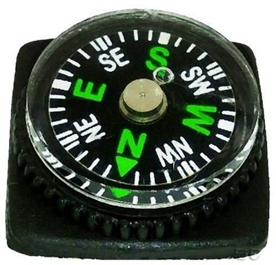

Scuba divers often wear watchband compasses like this one-
https://www.piratediver.com/Marine-Sports-Watch-Band-Scuba-Diver-Compass-p/2568.htm?gclid=EAIaIQobChMIz5-Ak6vQ4QIVxZCfCh3oxQ2jEAQYAyABEgL_APD_BwE&site=google_base
Some are pretty small and might be adaptable to what you are making

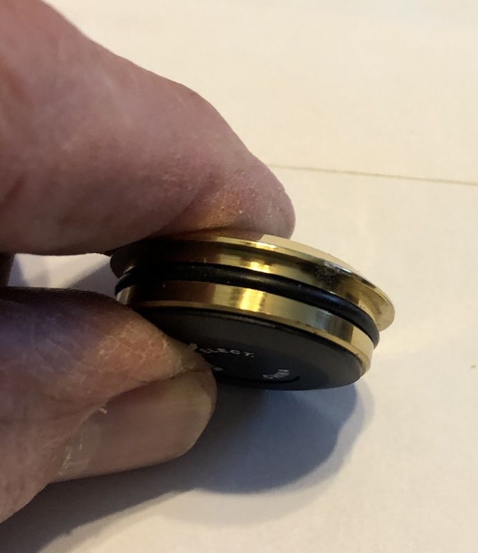

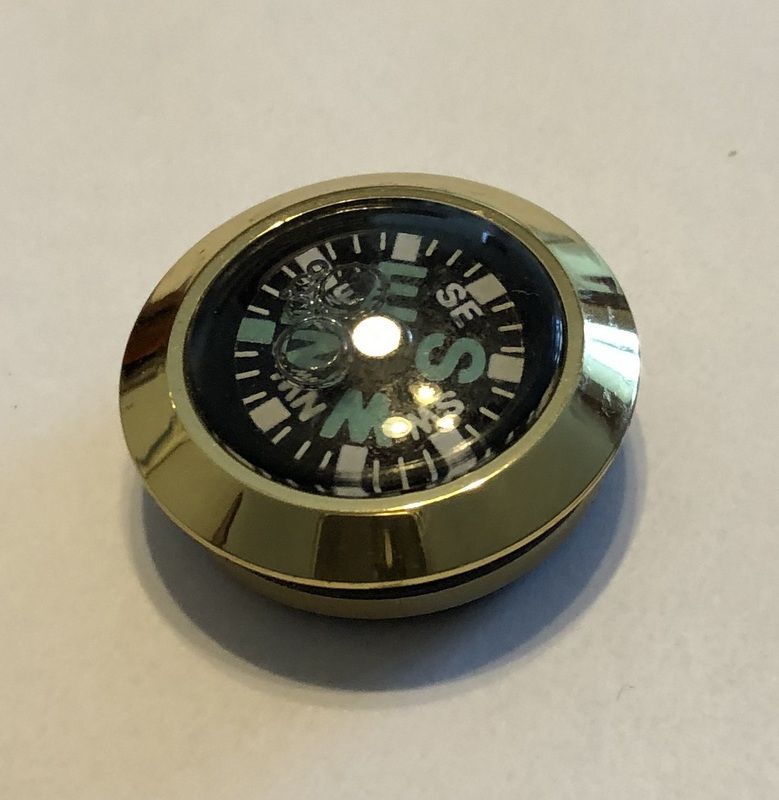

Thanks Lew but this was a pretty specialized little compass. It was designed to be let into a 1" cavity. It had a nice bezel and an O-ring for a press fit. Have searched several times using every description I can think of and haven't found anything remotely similar.
I ordered several and actually have two that I haven't used yet but I have people in mind for those.
Edited by Steve Krumanaker
I see now, the ones I thought about were nowhere near that nice.
