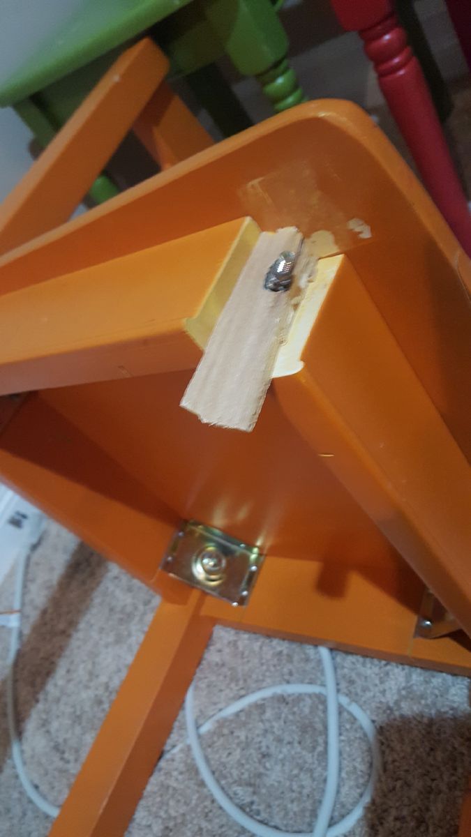

I received a message from a friend asking for advise on how to repair this broken child chair.  It appears from the pic that the chair stretchers do not have tenons.  Looking for suggestions to make the joint stronger than just doing the obvious of gluing the broken piece back on.  In the 2nd pic the broken leg is being held in place.  Thanks  Danl

I'd disassemble it, reglue the broken pieces then add a dowel(s) from the back for extra strength. Reassemble.
I agree with lew.
If you got a lathe you can make a new one.
Get yourself a handful of 16 penny nails and a couple lag screws and go to town on that thing.:BugEyeSmiley:  Seriously though.  Since they were smart enough to bring it to you before some hack got to it I would follow Lew's instructions.  If there is room to drill it deeper and switch to a longer hanger bolt that would help too.
https://www.rockler.com/steel-hanger-bolts-steel-hanger-bolts?sid=V9146?utm_source=google&utm_medium=cpc&utm_term=&utm_content=pla&utm_campaign=PL&gclid=EAIaIQobChMIgqrj14Xz4AIVELbACh2vFwi_EAYYBCABEgJLhfD_BwE
Dowels into the broken part may be the only feasible way to fix what may be a bad grain situation because I see a dark area at the back of the break. Also I would put no more than two dowels as more will not leave enough good wood.

I believe the dark spot is the tip of an anchor bolt.  I asked my friend for more info and a pic of the bottom of the seat.  My friend's son broke the chair and he is upset for his actions.  So, some kind of repair will have to be attempted.  Danl

There is a dark area that runs down beside the bolt. Could be stain or different grain in wood IMHO
I would put 1 dowel each at differing heights into the side skirt from the leg.  (But then how do you get them in?)  Then epoxy where the steel is from the threaded bolt then yellow glue for the dowles and to put the leg back on. You could also introduce more steel and replace the dowels with screws from the outside of the leg into the skirts.  Hide and plug the heads and paint to match.  The screws create less of a bending plane and should help prevent further breakage.  Why the skirts were never M & T into the legs is another matter.

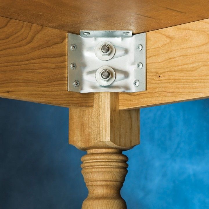

glue the joint back up..
add an apron bracket to the inside of the of the chair...

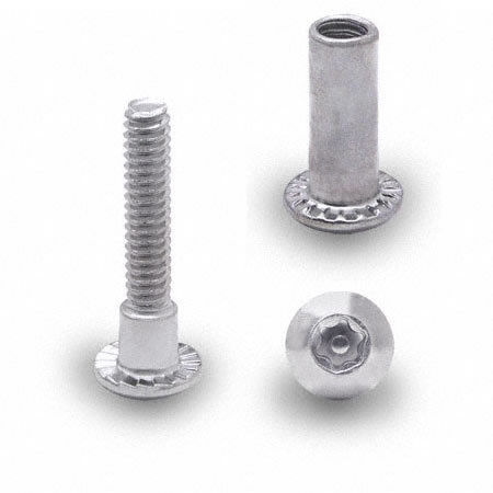

through bolt it w/ 1 or 2 sex bolts..
leave as is or camo cap/paint the heads of the bolts to make them look like thy are part of the design...
856643002_LEGAPRON1.jpg.0e5b36ae4424b55eeaa68fce6d441cee.jpg  821841642_APRON-LEGCONNECTION1.jpg.b297ec3af872dfdcb1976a8c9ffd726e.jpg  sexBolt__71152.1417716949.1280.1280.jpg?c=2

I'd try simple first:  remove the anchor, see if the top of the leg will come off.  Glue the two pieces together, put some glue and toothpicks into the anchor hole, re-insert the anchor bolt.  Most important:  tell Dad to keep the kid off the table, or get the tyke a ladder.  It probably broke cause the kid stood on it.  (Mine do!)  The wood broke at the weakest part.  The new glue joint makes the former weakest part the strongest (as long as you do a good glue repair:  strong rubber bands to clamp the pieces?).  To break it again will require more stress than before.  While the table is in repair, might remove the other legs, examine the upper post grain, see if other splits are there.  One way to repair such splits:  mix 50/50 yellow glue, inject into the crack with a syringe, then clamp.  The dilute glue also acts as a wood hardener.

since you already have the apron/leg plate...
glean off the old glue...
glue everything up...
through bolt the leg to the plate..
the through bolt will also act as the clamp as the glue dries...
I have repaired a bunch of these on tables and chairs.   Remove the threaded insert.  Glue the pieces back together and clamp.   If there's room put a screw above and/or below the hole, with an appropriate sized pilot hole.   Let the glue cure.   Drill the hole for the threaded insert a little deeper if possible.  Run the threaded insert in as far as possible.   If you have it, use a longer threaded insert.   Re-assemble.   The problem is usually that there's an inch and a half of wood and the threaded insert is only in half an inch.

I'd take it apart, reglue that piece back to the leg.
Then I'd put it back together.
I'd take a long pilot bit and drill through the right and left faces of the leg and
into the skirt boards (offset them a little so the right screws don't hit the left screws).
use a countersink bit in the pilot holes to clean them out and countersink them.
Make sure you use the right length screw to screw through the face of the legs and into the skirt boards.
Some bondo, primer and paint will finish it.
