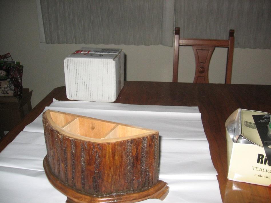

01.JPG.f79bb7e144fd195d51a4ebefa25e46e5.JPG02.JPG.f6bccdcadfa17b5b2224b5b4132984e5.JPG03.JPG.e2885d8f2899f30bb85d789de6f07032.JPG04.JPG.eb71b236f35e2d8332e665909ac24684.JPG05.JPG.c13b56ae3828c96757e75c39c1803a78.JPG06.JPG.a6244c0e419d73f086ca624631f570b6.JPG06.JPG.a6244c0e419d73f086ca624631f570b6.JPG07.JPG.c89858c866a5c3d6618acb88d04d08a7.JPG08.JPG.b1a8951083c9847aacc3f130a6196f99.JPG09.JPG.09171282336818e71a4b46b4649c8650.JPGIMG_5158.JPG.c085e03628f1abe182c26c407f832224.JPGIMG_5159.JPG.705915670e0b2cf4250b54b918889296.JPGIMG_5160.JPG.ef8ef2f6ece4f659fea7d283977a2d35.JPGThe story behind this little "What is it", is that I had this 1/2 log piece that came with the lumber stash,pic1. I didn't know what kind of wood it was so I cut a about 6" off the end to clean up and see what I had. It turned out to be Maple. I didn't want to just throw away the piece so thought I would make a band saw box out of it.
So I cut the bottom off, cut out the center, glued up the sides and reattached the bottom. The cut on the bottom looked ugly so I made a molding and then made some feet for it and called it a desktop pencil holder.
The finish is 2 coats of spray shellac, and 6 coats of water based poly thinned 50/50 with water. I did stained the base/feet ,because it looked better next to the bark.
Herb
Nicely done and very imaginative.
You did that 'ole chunk of wood quite proud.
Thanks Herb.
A band saw box less the drawer.  I like it.  Where's the pencils.
Quite creative.

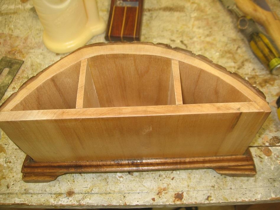

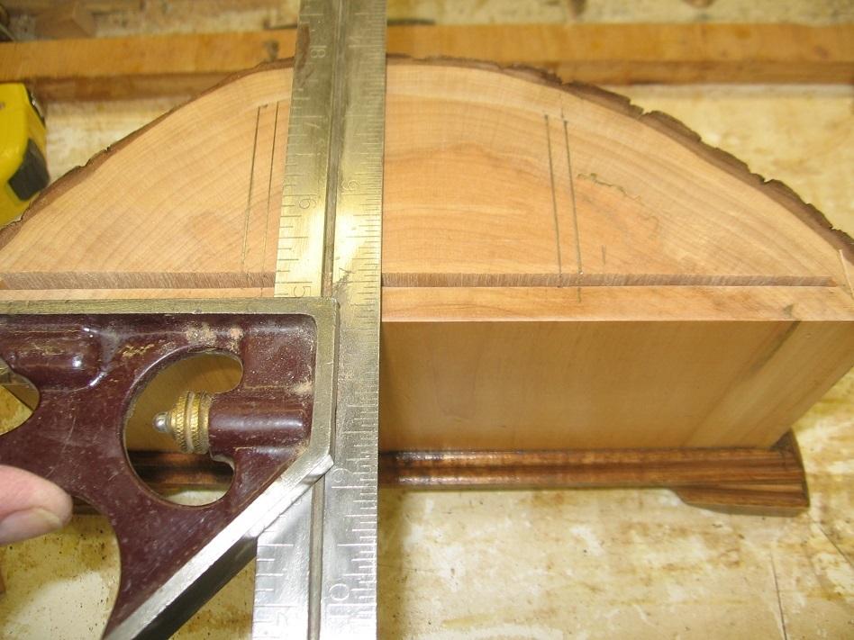

Since there has been some concern about the Pencils /Pens falling over I put some partitions in it.PH4.JPG.0b5d13cb9ef962cadc826f4d16aa7f07.JPGPH3.JPG.ed4e198c6a98775a1a9cda272ae3da92.JPGPH2.JPG.8a8ff6770f7dfcad21b14d95d2dc8294.JPG
will you be putting in a lint trap and pencil sharpener???
Even more classy than before Herb. Better give those little elves an extra cup of cocoa working OT.:rolleyes:
Edited by Grandpadave52
I'd gift you some pencils for it if I could find mine...not behind my ears either?:lol:
