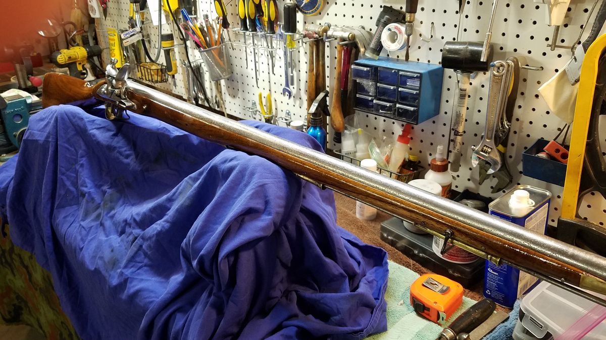

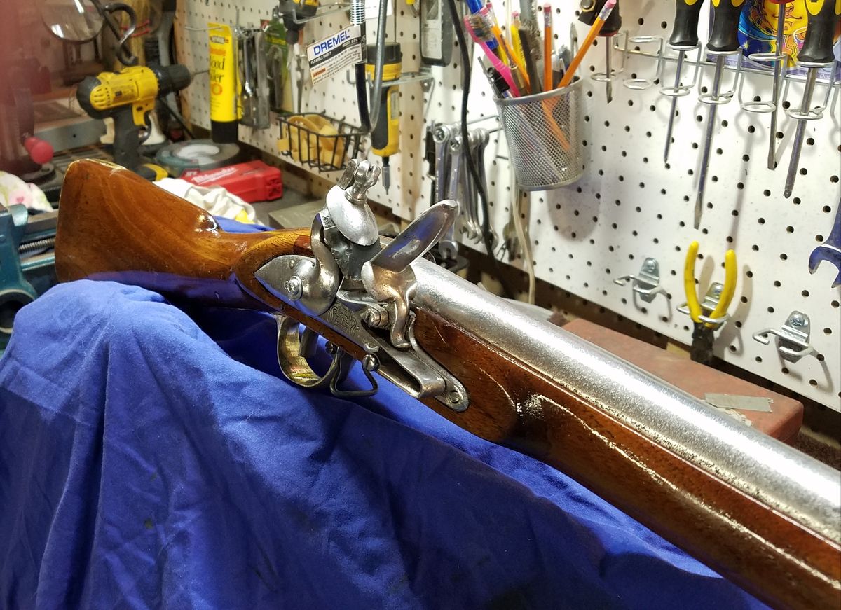

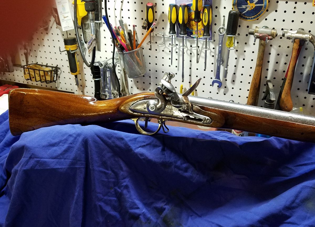

January 4, 20197 yr Author Popular Post comment_172624 Ok so I got some more work done on the Bess and she's about 80% complete. I still need to make the stock finish have a more satin look. 0000 steel wool and then apply a coat of Renaissance wax to give it a nice look. I used some homemade Alkanet wood stain to color the wood and the 6 coats of Tru Oil. Another job is to polish the brass furniture again plus give the ramrod a once over. I still need to proof test the barrel but I will wait until next week to do that. Now all I have to do is let the finish cure for about a week or so and then get back at it. Report
January 4, 20197 yr comment_172629 42 minutes ago, Gene Howe said: Wow, Bess sure cleaned up nice. She's a beaut. @Monkey Paws Wow! What a difference from what you started with at the onset. Kudos. Report
January 4, 20197 yr comment_172633 You nailed it on the stock color IMO. Once the sheen is rubbed down, gonna be something to behold. Pulling for you on the proof test. Loving every picture/story line of this restoration. Make sure your insurance policy is updated to cover this from loss (fire/theft). Report
