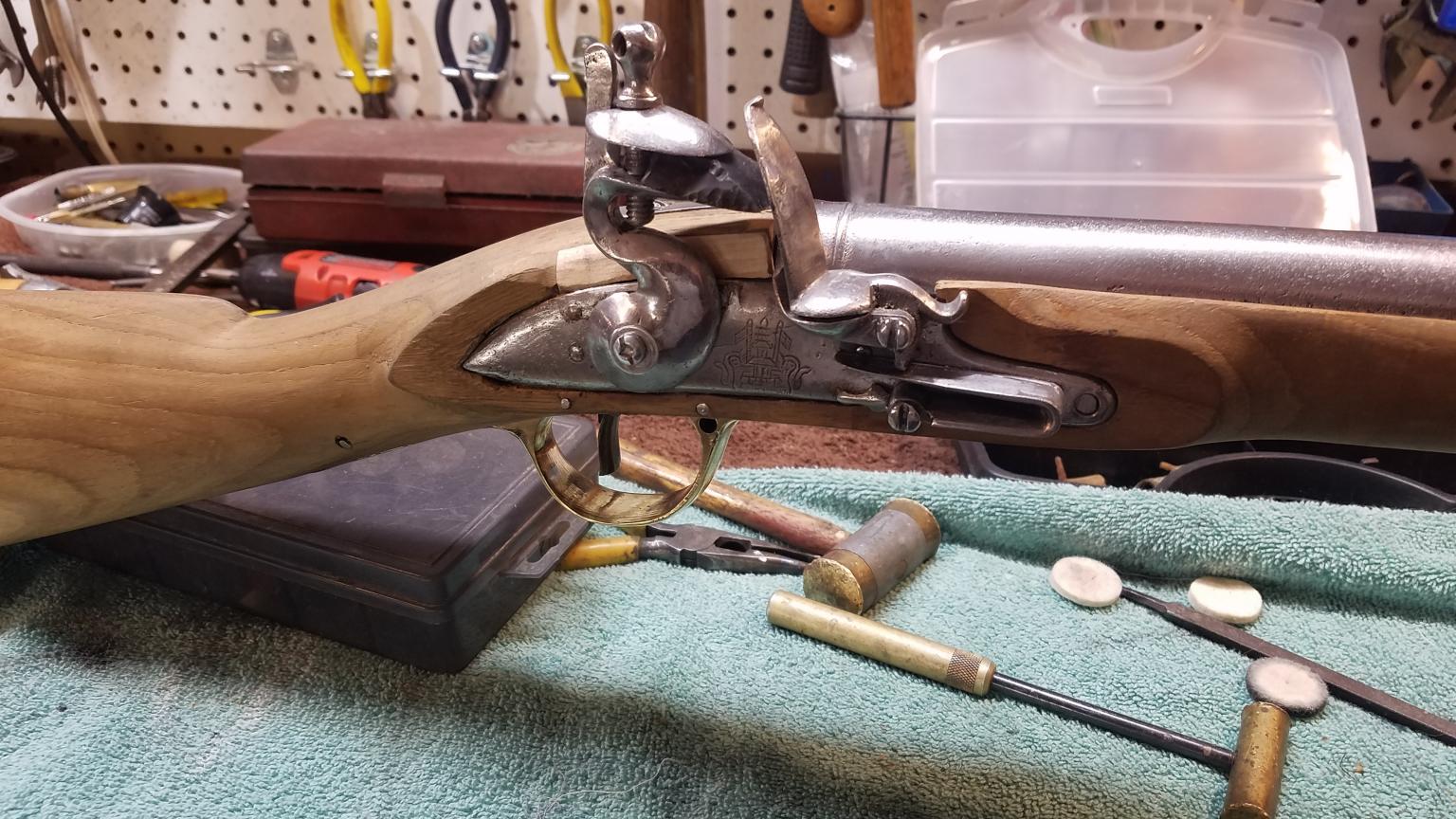

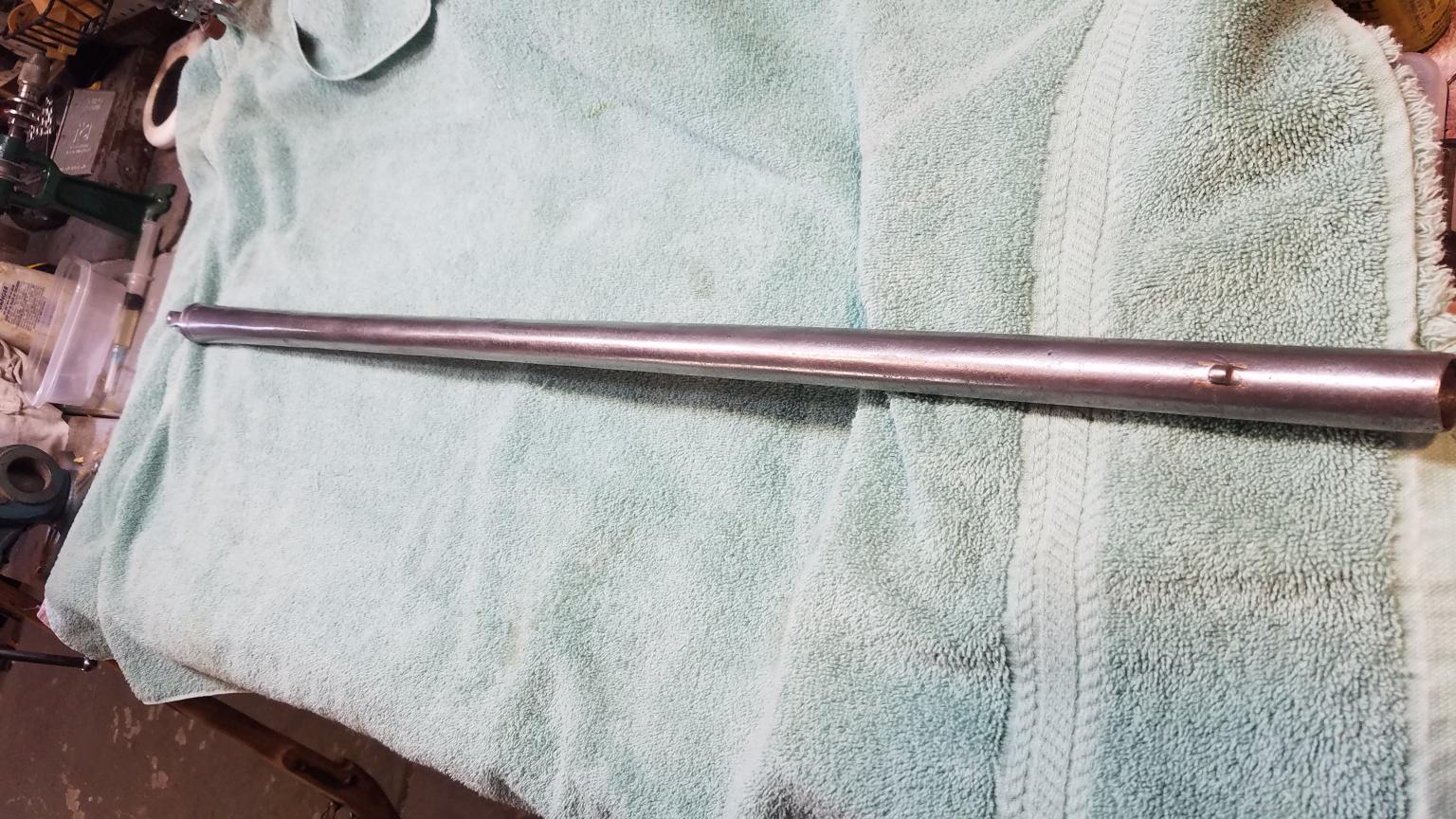

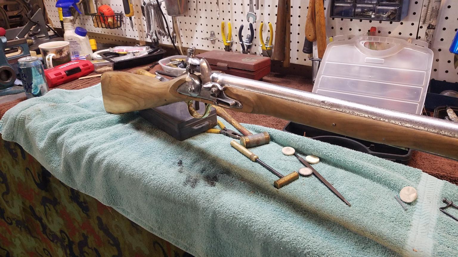

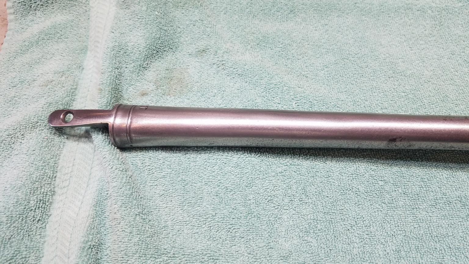

December 28, 20187 yr Author Popular Post comment_171567 So I had a chance to work on the Bess during the holidays so here is a little update. The barrel cleaned up well and I plan to proof test it next weekend. To proof a barrel you load a double powder charge and and two patched balls, light the fuse and see what happens. If it survives you do it again. If it survives the last proof you are good to shoot your normal service charge. I am very confident that the barrel will be just fine. I proof barrels because I am not a fan of rapid disassembly (i.e guns blowing up). I did a test assembly today to check for binding and function. The 200+ yr old flint lock works like new after a quick rebuild andyou can see the great spark in the pictures. I was telling you earlier that this rosewood can be a challenge to work with and you can see this in the pictures below. A large chunk shredded itself as I was inletting the lock. I patched a piece of hardwood in an will blend it later on to look like a natural blonde spot to match the others light areas on the stock. I worked the hardware to make it look good but you really need to be careful working this old brass because it will break on you without even trying. Heat and patience make all the difference in the world. Gene Howe I am going to use your suggestion and Tru-Oil the stock. I will post more pictures soon. Report
