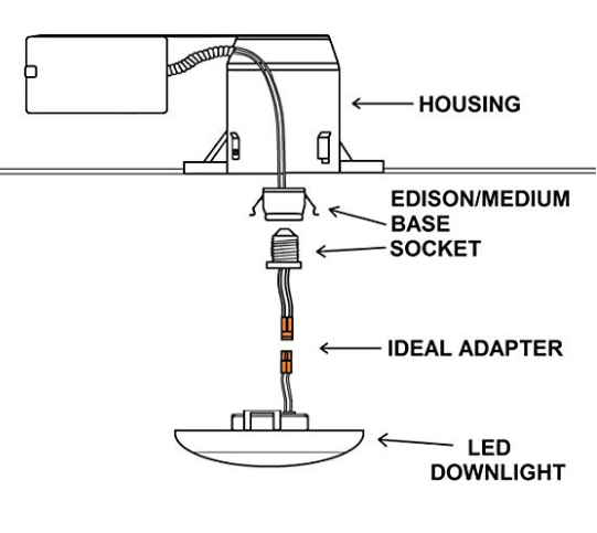

If you are adding new LED lighting, some mfg make them so that they can be screwed into the old can  base socket.
Danl
It's a whole new light (s) going in. Our old eyes can't see in the dark anymore so I'm afraid that someday I might get fed something that will knock the light out of me----accidently of course!!!!!
