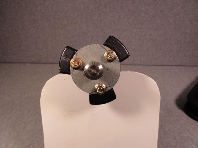

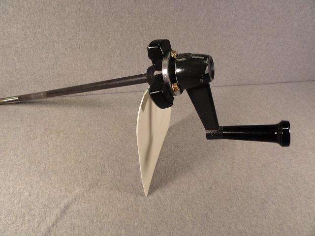

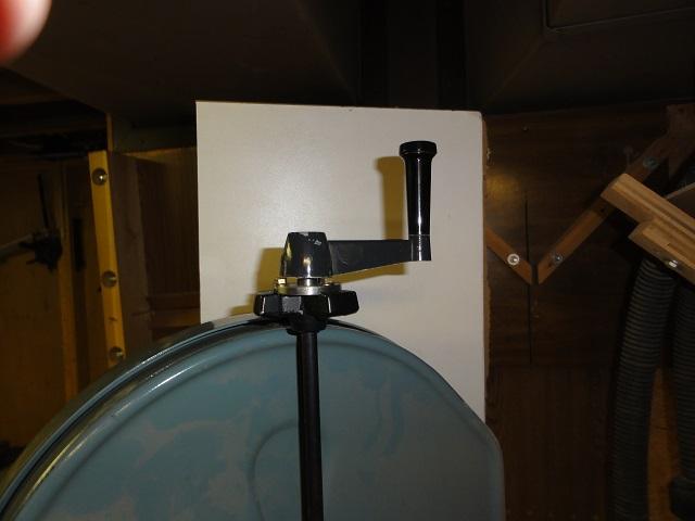

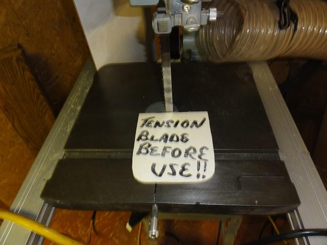

November 28, 20187 yr Popular Post comment_167820 I don't always release the tension on the band saw. Not sure if it is necessary or not but had an idea to add a crank handle on mine. I sent the motor from my radial saw and got the $100.00 rebate and saved a few items before tossing the carcass. The crank handle was one of them and I decided to add it to the tension knob of the Delta 14" band saw. I stuck a piece of 1/2" rod in the lathe and cut the end for a press fit into a thick washer. Took it out to the welder and tacked in for extra support and ended up with this after drilling three holes for mounting bolts. Removed the tensioner from the saw and mated the two together. Add the crank and tightened the set screw. Put it back in the saw and it worked flawlessly. I thought the crank might be too short but it cranks with little effort so I'm good. I got to thinking how fun it will be the first time I go to use the saw and forget to tension the blade so I made a sign to lay on the table. I have some flat magnetic strips so I double stick taped two pieces on to help keep it from being knocked or blown off. Report
November 28, 20187 yr comment_167824 Great repurposing, Dan. And the sign is a swell idea, too. I always release the tension and, some times forget. Report
November 28, 20187 yr comment_167837 I love the Tension Blade Before Use sign. I lost count how many times I fired mine up without the tension, man what a racket! It's probably good I am transitioning more to hand tools Report
November 28, 20187 yr comment_167838 Once I got in the habit its not so bad... But once I tighten it up before I turn it on I open the door and spin the wheel with my finger to make sure the blade is where it should be before I turn it on...I thought if it is half on and it get turned on it might somehow kink the blade as it comes off and a kinked blades might not be fun to run??? Report
November 28, 20187 yr comment_167839 And John all that racket it makes might be dulling the blade or else changing the set so it runs haywire...?? Report
November 28, 20187 yr comment_167841 Just a thought...maybe a fridge magnet. Tape over the ad and write on it. Report
November 28, 20187 yr comment_167849 1 hour ago, Smallpatch said: And John all that racket it makes might be dulling the blade or else changing the set so it runs haywire...?? I'm sure it had Jess, a couple times the danged blade slid off the wheels when I fired it up without tension. That bandsaw is gone though, now I have a Shopsmith BS to ruin, we'll see, I'm sure I can figure a way. Report
November 28, 20187 yr comment_167856 Great idea and re-purpose Dan. I've seen someone actually makes a conversion kit on this order for the Delta's...IIRC it was kind of pricey too so you did real good. I've only forgotten to re-tension once so far...after I went to the bathroom, I made a post-it-note with about the same verbiage as you...it's been reused several times now with painters tape. Both of mine have aluminum tables. Report
