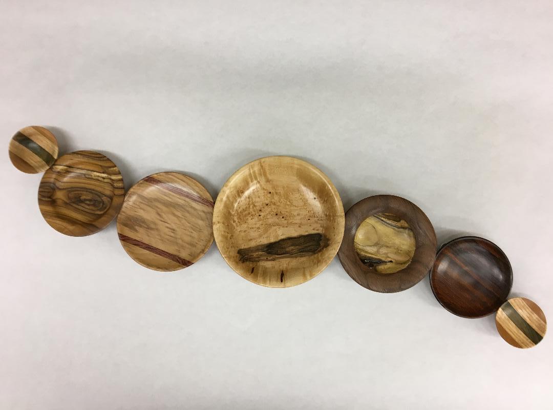

This is my entrance to more art than crafts.  Many people use their wood to demonstrate their skills. I use a minimum of skills to demonstrate the wood.  I am privileged to be the first one to peek inside what God made.  So, this is a wall hanging, mostly from scraps,and exploring various finishes.  Lignum vitae, red oak, walnut, sepele, hickory, cherry, lace wood, mulberry with finishes of Waterlox, poly, BLO, beeswax.
I will work on the framework to make it simpler. Right now, it is a bunch of aluminum wire and hot glue. Starting on Swoosh II today.  1420005105_beckysswoosh2.jpeg.451431d19c14006cfa871d358cddbefe.jpeg

Thanks for the affirmation of my attempt to be artsy.  Here is my second attempt.  I share it here not for more applause but to show the cool wood that goes into it.  The variety of colors and grains in wood, most from scraps, just blows me away - lignum vita, red oak, cherry, red bud - a little spalting, white oak with bubinga inserts. The middle is my favorite - birds-eye maple with a bark inclusion.  I learned the stain-sand, stain-sand, BLO technique here, making the bird's eyes dance before your eyes.  Then, a walnut frame around part of a yew bush root ball.  I won't try that again as I learned how root balls encapsulate rocks.  Then, a mystery wood from Mexico - oily stuff that I also learned how to finish on this group.
So, with good advice here and pieces donated from many friends, this is a group project.
