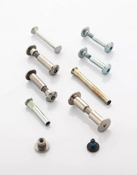

December 9, 20187 yr comment_169019 4 hours ago, schnewj said: You may have to search for a rivet source, sex screws/bolts aka binding posts or Chicago Screws would be a lot easier... classier too... or a double cap rivet... Edited December 9, 20187 yr by Stick486 Report

December 9, 20187 yr comment_169024 1 hour ago, Stick486 said: sex screws/bolts aka binding posts or Chicago Screws would be a lot easier... classier too... or a double cap rivet... Sex bolts are NOT what you want to use. They need to lock in permanently, have enough of a head to still hold when hafted to the contour. Double caps are the needed ones; steel or Brass, possibly Copper will work equally well. This is an example of what you want. You need a Report

December 9, 20187 yr comment_169027 2 minutes ago, schnewj said: Sex bolts are NOT what you want to use. SAY WHAT!!! all the better commercial door hardware and closures use them... they come in brass, bronze, steel, titanium, aluminum, copper, stainless (any grade) and coming loose is rarely an issue.. the heads can be had in trusshead dimensions, which are way larger than than any double capped rivet and are malleable.. when you haft them to the contour of the handle, they ain't gonna turn.. push come to shove... Locktite blue... Report
December 9, 20187 yr comment_169028 Just now, Stick486 said: SAY WHAT!!! all the better commercial door hardware and closures use them... they come in brass, bronze, steel, titanium, aluminum, copper, stainless (any grade) and coming loose is rarely an issue.. the heads can be had in trusshead dimensions, which are way larger than than any double capped rivet and are malleable.. when you haft them to the contour of the handle, they ain't gonna turn.. push come to shove... Locktite blue... Sorry, I have to disagree that Sex bolts are the way to go. Just my actual experience with making knives and how scales are attached commercially. Report
December 9, 20187 yr comment_169029 1 hour ago, schnewj said: Sorry, I have to disagree that Sex bolts are the way to go. Just my actual experience with making knives and how scales are attached commercially. Sorry, I have to disagree that Sex bolts aren't the way to go. Just my actual experience with installing exceptionally large quantities of hardware commercially for decades. Edited December 9, 20187 yr by Stick486 Report
December 9, 20187 yr comment_169030 7 minutes ago, Stick486 said: Sorry, I have to disagree that Sex bolts aren't the way to go. Just my actual experience with installing exceptionally large quantities of harware commercially. OK, I'll agree to disagree. Your experiences are in one direction and mine are in an other direction. Report
December 9, 20187 yr comment_169034 1 hour ago, schnewj said: Your experiences are in one direction and mine are in an other direction. @schnewj, so let's figure out why the different results... binding posts are: cheap.. generally have sockets on the male portion only... that's generally now, but not always... are machine screw threaded.. have a lower than normal thread cut percentage.. hate torque.. you can get them only so tight before they go fatal... they are designed to be hand operated w/o tools.. (office worker operated)... they were designed to hold stacks of paper together.. sex screws/bolts are: not cheap.. have sockets on the male and female portion and/or the female barrel is knurled, set like a carriage bolt on the shank near the head... the underside of the head of the male thread is faceted or toothed... are machine screw and bolt threaded.. have a higher than normal thread cut percentage.. the male and female threads are slightly misaligned so when they are tightened they are self locking... love torque.. often used as ''one way anti-tamper fasteners''... they are designed to be operated w/ tools.. missing any of the features and you have 2nd, 3rd rate not up to par or less than still yet, chinese... any failures are found to be that the sex bolts are not the real deal... Edited December 9, 20187 yr by Stick486 Report

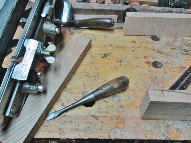

December 12, 20187 yr Popular Post comment_169400 What I have been using with the Stanley 45.. Handy little tool.. Report
