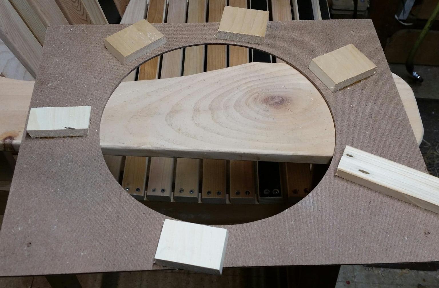

October 7, 20188 yr comment_161988 2 hours ago, Pat Meeuwissen said: Managed to route the rabbet, got the base made and glued in. Ya' did good Pat. What method did you end up using? Template similar to what Lew sketched up? Report
October 8, 20188 yr Author Popular Post comment_162006 11 hours ago, Grandpadave52 said: Ya' did good Pat. What method did you end up using? Template similar to what Lew sketched up? I did use Lew's idea. It work very well here's a pic to keep the build current. Report

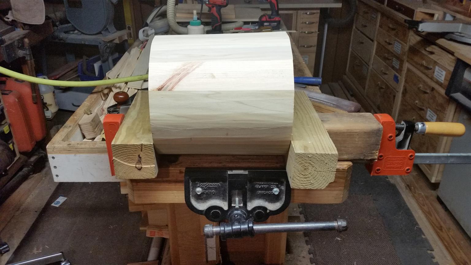

October 21, 20188 yr Author comment_163400 Good morning, I'm working on planing the sides of the firkin round and this is how I'm holding them. I have to hold one size with my hip so not as easy to get a good stance. Any suggestions for how to hold it better? Report
October 21, 20188 yr comment_163402 turn the firkin 90°.. use the vise to hold it.. use wedges/blocks/tapers to help control rock... stand it on end.. bar clamp it to the table w/ part of the firkin hanging in free space.... plane vertically.. Edited October 21, 20188 yr by Stick486 Report
October 21, 20188 yr comment_163426 You are doing a good job. When I do buckets, I put a dado in the bottom of the stave before I taper the stave. The dado is 3/4" up from the bottom, and I make the round for the bottom and install it as I put the bucket together, it helps keep everything round during assembly. The bottom basically floats in the dado,no glue. Herb Report
October 21, 20188 yr Author comment_163427 18 minutes ago, Dadio said: You are doing a good job. When I do buckets, I put a dado in the bottom of the stave before I taper the stave. The dado is 3/4" up from the bottom, and I make the round for the bottom and install it as I put the bucket together, it helps keep everything round during assembly. The bottom basically floats in the dado,no glue. Herb Herb, that is exactly what I'm planning to do in the future. I'm also going to try to cove the inside to make that round as well. I kind of like the look like this but its not what the originals would have been. Report
October 21, 20188 yr comment_163429 25 minutes ago, Pat Meeuwissen said: Herb, that is exactly what I'm planning to do in the future. I'm also going to try to cove the inside to make that round as well. I kind of like the look like this but its not what the originals would have been. Also I found that if I taper the edge of the bottom it fits into the dado better, kind of like a panel in panel doors. The tapered staves cause the dado to be slightly out of parallel with the plane of the bottom, unless you angle the dado slightly. By the way there are some good formulas on the web for calculating the dimensions of stave from you furnishing the diameter of the bottom and number of staves etc. Herb Report

October 21, 20188 yr Author comment_163437 Guys, this is what I used to complete my task.I clamped the clamp into my vice and then clamped the work into the clamp. Stick thanks for the point in that direction. Report
