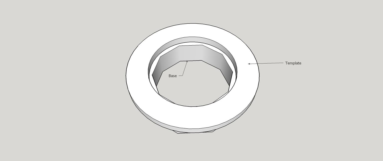

October 6, 20188 yr comment_161863 I'd make a circle template that looks like a donut. The hole of the donut would be the diameter of the rabbeted circle. Use a pattern bit with a top bearing. Something like this- Edited October 6, 20188 yr by lew Report

October 7, 20188 yr Author comment_161905 14 hours ago, lew said: I'd make a circle template that looks like a donut. The hole of the donut would be the diameter of the rabbeted circle. Use a pattern bit with a top bearing. Something like this- I like this Lew, I hope I have a short enough pattern bit. Report

October 7, 20188 yr comment_161922 2 hours ago, Pat Meeuwissen said: short enough pattern bit. or double up on the thickness of the template Report

October 7, 20188 yr Author Popular Post comment_161944 Guys, thanks for the info. I made a circle template and I'm waiting for the blocks I glued to the bottom to dry before routing the rabbet. As I go forward I'm going to route a groove in the staves b4 they are cut. Then I'll taper the circle bottom an glue it in as the firkin gets assembled. Thinking the bands around the exterior will go a long way to holding it all together. Edited October 7, 20188 yr by Pat Meeuwissen Report

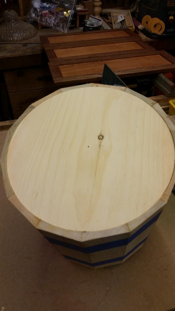

October 7, 20188 yr Author Popular Post comment_161974 Managed to route the rabbet, got the base made and glued in. Report
October 7, 20188 yr comment_161975 46 minutes ago, Pat Meeuwissen said: Managed to route the rabbet, got the base made and glued in. Cool! From the images I googled, that looks more authentic. Report
October 7, 20188 yr comment_161977 1 hour ago, Pat Meeuwissen said: Managed to route the rabbet, got the base made and glued in. AWESOME!!!!!!!!!!!!!!!!!!!!!! Report
