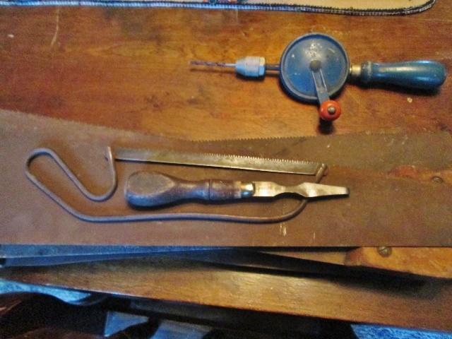

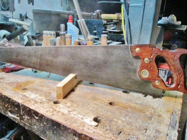

Back at the end of April of this year, went to an estate Auction.    Won a bundle of saws.....one was a bit strange looking...

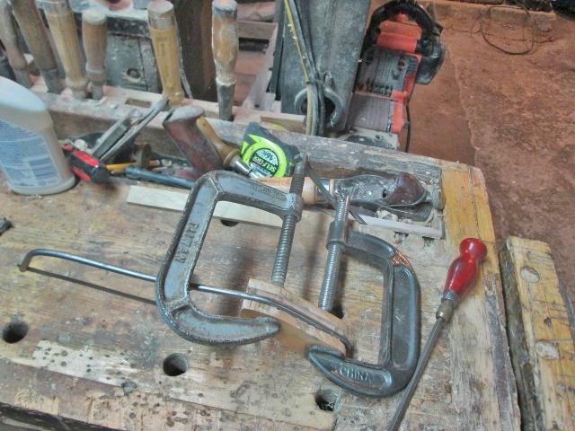

Finally got around to rehabbing it a bit.....Filed the teeth as rip.    Got a couple pieces of Cherry to make a blank for a handle..
Metal frame was wire wheeled until it was shiny.   Red handle holds the file I used to sharpen the blade. let this mess sit over night

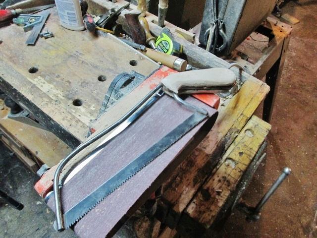

Clamps were removed, sander set up.   Shaped to fit my hands.

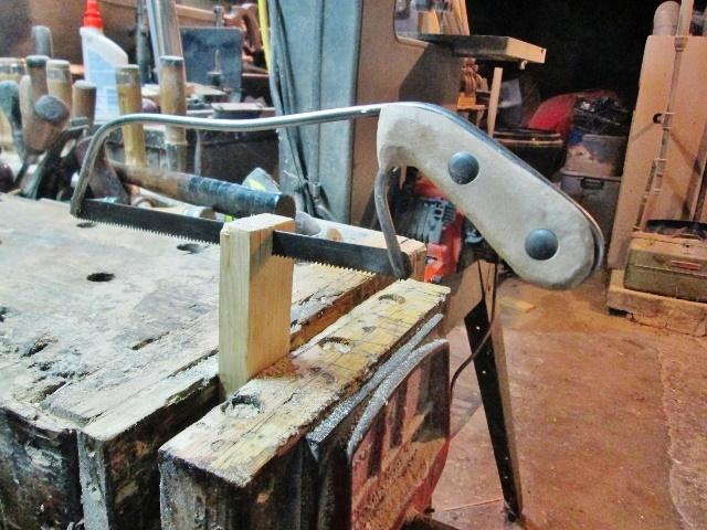

Drilled a couple holes, and installed a pair of saw bolts.   Steel frame, merits steel bolts, right:rolleyes:
Operator needs trained on a proper grip....

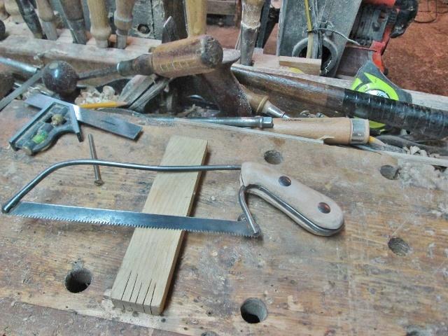

It starts easy, cuts fast, and IF I hold it just right, straight cuts occur, like magic.

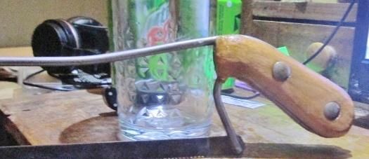

Shellac and the brush was still upstairs (yes, I am now cleared for stairs) so I took this up and added a Amber Shellac finish.
IF the sun should happen to reappear, I can let the Cherry soak up some rays, and get a "tan".
Might be a decent enough, little Tool Box Saw....it is not a "perfection" saw....
That's ok, I already have one....by Atkins.
