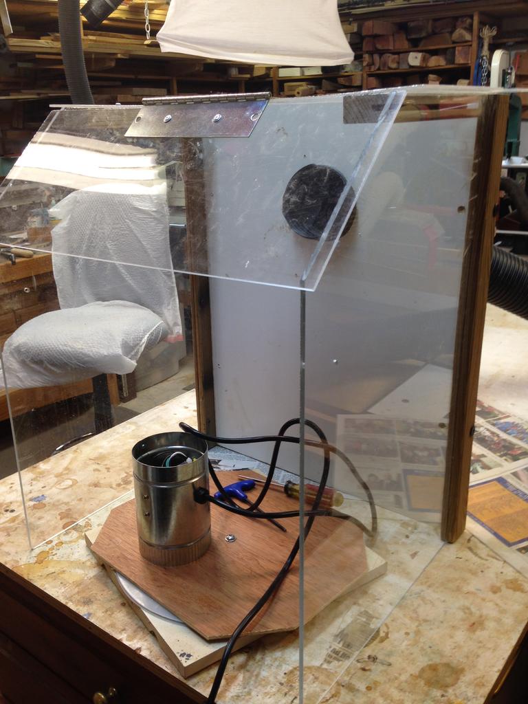

April 25, 20188 yr comment_147607 Lew here is one I made. That can is an inline fan to vent the booth out the window. Report
April 25, 20188 yr Author comment_147637 Many people make spray "booths" out of a cardboard box (small or refrigerator sized) or sheets of foam insulation with a fan at the back end. Edited April 25, 20188 yr by kmealy Report
April 27, 20188 yr comment_147792 Just make sure if spraying flammable materials that you change the motor to an explosion proof motor in the fan. Report
