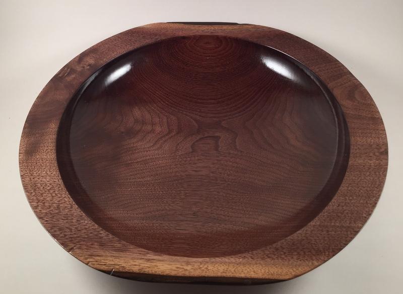

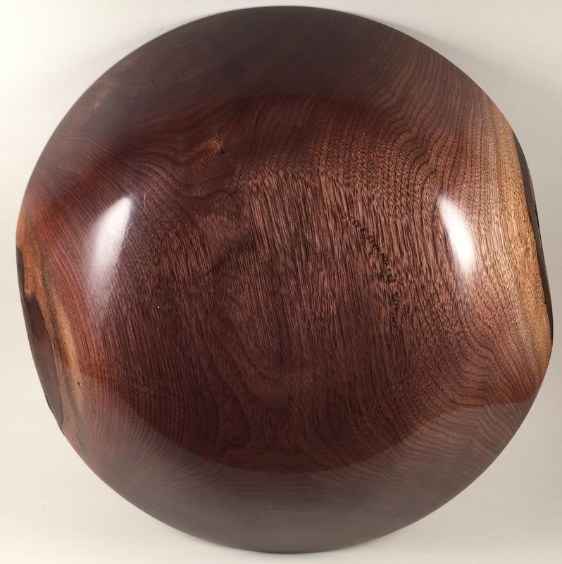

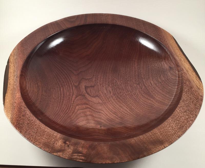

December 16, 20178 yr Popular Post comment_134214 I roughed this bowl a few years ago and left some bark on it. By the time I got around to finish turning it the bark was pretty well toast. Rather than reduce the diameter I sanded those areas flat. I kind of like it but not sure if I'd do it again. Finish is fast drying gloss poly applied while spinning slowly. Of course I had to drop it right after I took it off the lathe, oh well, adds character I guess. Steve Edited December 16, 20178 yr by Steve Krumanaker Report
December 16, 20178 yr comment_134241 Nice bowl. Maybe I will finish those 2 walnut bowls that have been on my shelf for several years. Report
December 16, 20178 yr comment_134243 Beautiful Steve, the shape is very nice. Is the finish brushed or sprayed? It is quite smooth and glossy. Report
December 17, 20178 yr Author comment_134262 Thank you gentlemen!! Dan it is applied with a foam brush, amazing technique I think. I'm going to plan on building a dedicated apparatus for it though, it ties my lathe up for a couple hours when I do one. That, and I'd like to get the rpms down to about 20 or so, lathe won't go any less than 48. Steve Report
