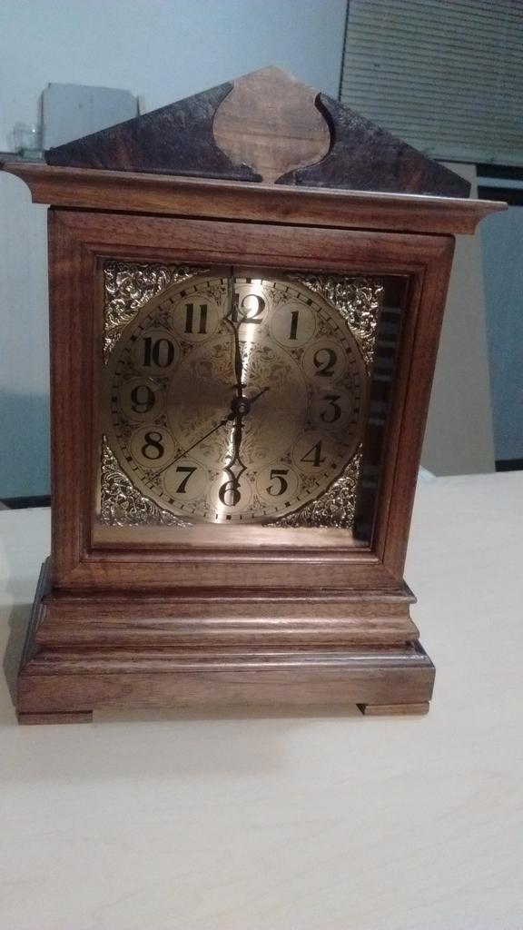

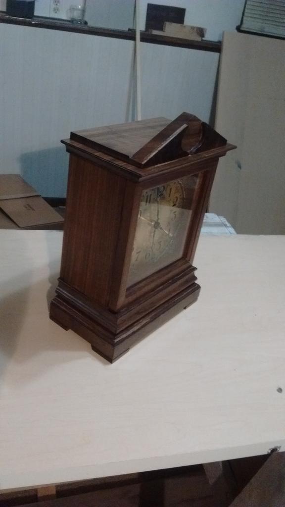

I finally finished the clock.

Looks great - share with us what finish schedule you used?

45 minutes ago, lew said:
That is Awesome!!!
Thanks Lew.  I appreciate that.
One coat of Watco Medium Walnut DO, and three coats of satin poly.  I tried the Dark Walnut, but it was too dark and we didn't care for it.
Very ,very nice!
I went back and looked over you bio and says you are a beginner...But after looking over your clock you might as well move out of the cellar...Looks good from over your shoulder...
  The one thing that will move you farther up the ladder is after the finish is dried check with the finish guys and see how they smooth their finishes out to look like those know it all guys do it...
