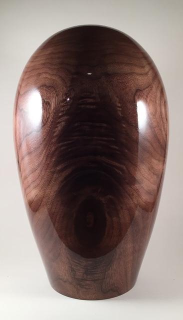

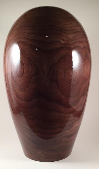

November 25, 20179 yr Popular Post comment_132427 Just pulled this off the lathe. Walnut is just the most amazing wood to me, the grain in walnut is always different and always spectacular IMO. Tried a new finishing technique(to me) on this piece. Left it spinning on the lathe and applied tung oil with a foam brush. That allows a wet heavy coat with no drips or sags. It's a technique I'll be using again I'm sure. This piece is 13" tall and about 7" major diameter. It's a pretty consistent 1/4" thick. Steve Just realized i didn't take a picture of the top, it's hollowed through 1-3/4" hole if I remember correctly. Report

November 25, 20179 yr Author comment_132453 2 hours ago, lew said: Absolutely Gorgeous! I agree about walnut. It is an awesome wood. Too bad folks around here use it for firewood! Many of our roads and farmer's fields are lined with walnut trees that have been planted by the squirrels. Did you use a grain/pore filler? I can never get my turnings that smooth or maybe I'm just not applying sufficient layers of finish. Lew, amazing to me too that people burn walnut, this piece definitely would have gone that way if I hadn't got lucky enough to get it. It is three coats of tung oil, period. I was pretty surprised it filled the grain like it did. It is a high quality oil, Sutherland Welles high luster, and not cheap. I really like the technique of applying the finish while spinning but I think my lathe is just a little fast at lowest speed which is 48rpm. I'm told 10-20 rpm is ideal. The other downside is, it ties the lathe up until the finish is set enough it won't run, about 3 hours. Steve Report

November 26, 20179 yr Author comment_132493 26 minutes ago, Grandpadave52 said: Did you rub out the TO between coats? Hi Dave, thanks. I sanded between coats with 1000 grit paper. I had some air bubbles that were giving me fits, on a hunch I hit it with a heat gun while it was spinning and that really seemed to help. Steve Report
