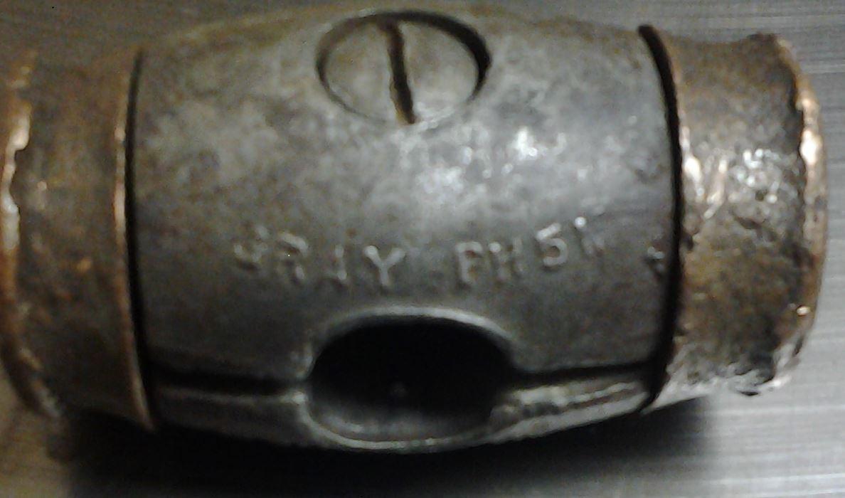

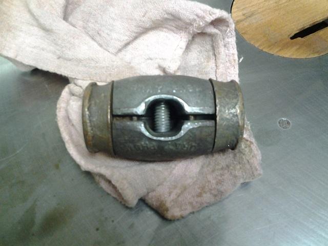

November 17, 20179 yr comment_131660 I have this old brass Gray Canada mallet that belonged to a beloved older machinist we worked with. It has been given to a coworker for remembrance. it has no handle , I cannot find any illustration of it anywhere and hope somebody can help me to reproduce a handle for it and pit it back in service. Does anyone know what the handle should look like? image:3618 image:3619 image:3620 image:3621 Report
November 17, 20179 yr comment_131664 I had and may still have one that looked like this. Yours seems to fasten together from the side. Report

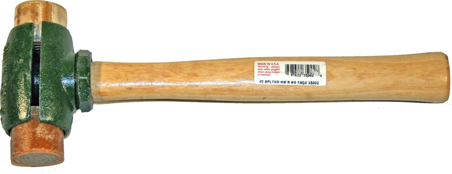

November 17, 20179 yr comment_131677 Dave's is a split head hammer just the same. His looks like a poor design and may have not sold well. I say poor design because I can't figure how they would have secured the handle to it. I took one of Dave's pictures and am posting it here as they will open in some browsers but not others. Here is a link to the hammer I pictured above. Scroll down the page and see the selection of faces which can be bought for it including copper and brass. http://www.hammersource.com/Iron-Solid-and-Split-Head-Hammers/ Here is one of Dave's pictures. Report

November 17, 20179 yr comment_131701 4 hours ago, John Morris said: A soft faced hammer as Stick has suggested is typically a mallet with a urethane striking surface. I may be wrong, but prove it! you no doubt looked to the two links and see that there are soft faces for the split head hammers/mallets.. and for good measure... http://www.carbideprocessors.com/wiha-83288-split-head-mallet-replacement-housing-3-1/ this style of a split head can have lead shot in it... that makes it a dead blow... install soft faces... and if you take the shot out of hammer, slit them w/ a knife, use the shot as split shot to fish w/ and then yur old man catches up w/ ya... ewww.... THOR SPH275 SPLIT HEAD HAMMER 7.1/2LB PLASTIC This Thor split head hammer is a heavy duty soft faced hammer which is suitable for assembly, maintenance and repair industries. The design allows for quick replacement of the handle or faces. The split cast iron head is secured by 2 socket head cap screws. Size: 5. Diameter: 70 mm (2 3/4 in). Weight: 3625g (7 1/2 lb). Stock CodeTHOSPH275 https://www.rjpryce.com/Products/thor-hammers-and-inserts/THOSPH275 Report
November 17, 20179 yr comment_131705 6 minutes ago, Stick486 said: you no doubt looked to the two links and see that there are soft faces for the split head hammers/mallets.. and for good measure... No, I remember dad's split head hammers he used for assembling bee hive boxes, I remember he had the rawhide inserts, hardly a dead blow hammer, but more of an assembly hammer as Dan's is. I guess it could be a dead blow if it had the shot inserts. But Dan's hammer as shown is not a dead blow. Report
November 17, 20179 yr comment_131709 @dave b First and most important, Welcome to the Patriot Woodworker. Glad you found us and even more happy you jumped right in with a tough question. Looking at your first picture, I would say any handle (preferably hickory, ash or oak) would be satisfactory as long as the engage end to the handle was turned close to round with the OD slightly larger than the ID opening of the fully closed head. Hard to tell w/o seeing the head ends opened. You should be able to do that by removing the screw. Likely the handle hand portion was more oval in shape and maybe up to 1-1/2X larger than the head clamp opening. The engage end may even have had a slight "ball" shape versus straight??? I would speculate the head inserts are bronze or copper versus brass looking at the way they are cast and the type of mushrooming. Bronze &/or copper were (still) more typical as machinist, tool maker, machine repair versus brass simply because they were less likely to splinter or chip. While all are considered non-marring and non sparking, we never allowed brass in our manufacturing environment for reasons mentioned. In your picture below, I surmised the tool was originally manufactured by Gray Tools based on the name/model number on the head. While Gray is still in business, I could not find a catalog listing for a hammer like this currently. Hope this helps some... Don't hesitate to ask follow up questions and let us know how the story ends. Lot of curious folks based on the responses. BTW...I think your picture files are missing the .jpeg extension on the files... Report

November 17, 20179 yr comment_131721 @dave b...if you look at @HandyDan's link at the hammer on page 69, it is an identical match... I would speculate the handle end which goes into the head was turned very similar to the replaceable face ends as shown. You should be able to use your current bronze ends as a pattern to turn/make a new handle end...dimensions may or may not be identical but at least you have a pattern. Report
November 18, 20179 yr Author comment_131804 Wow! Thank you so much! This has filled in the blanks for me. The hammer head has SO much sentimental value to us. We loved the guy who left it behind and want to honor it and him appropriately. That looks like an ash handle I think. I have some perfectly straight grained ash that would be great for this. I was concerned over just how thin the handle must become within the head where the screww goes through it and supppsed that it may have had a metal handle. But this puts that question to rest. Thanks all for your interest and help with my request. I appreciate all the time you all have given me! Dave Report
