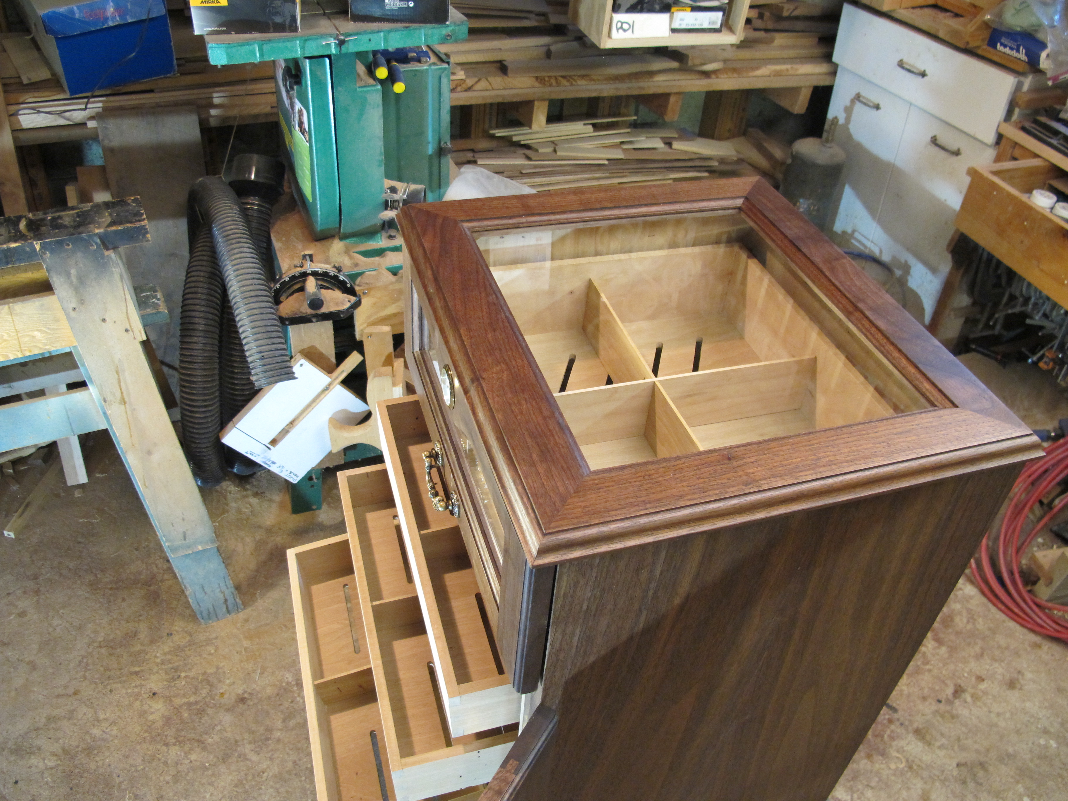

September 11, 20179 yr Popular Post comment_124176 I made a large humidor and used double strength plate glass for the top. It was almost .25" thick. Report
September 11, 20179 yr comment_124180 1 minute ago, Stick486 said: that is some serious nice Lew... Thanks Stick! That was a project from He**. After it was completed, the owner never added a humidification. I built the thing with wood that was a little higher in moisture content so it would not shrink when the internal humidity was kept high. A lot of work- wasted effort. Report
September 11, 20179 yr comment_124213 Keith, please use tempered. Or increase the limits of you liability coverage. Beautiful, Lew. We're not responsible for how our customers abuse our creations. Though, it may piss us off. Report
September 11, 20179 yr comment_124220 WOW @lew...too nice to even use let alone abuse. Way outta' my league... Report
September 11, 20179 yr comment_124243 when the check clears, you can do what you want with what i built for you. Report
September 11, 20179 yr comment_124248 17 minutes ago, DAB said: when the check clears, you can do what you want with what i built for you. Except this guy wanted me to "adjust" the alignments due to the shrinkage. Report
