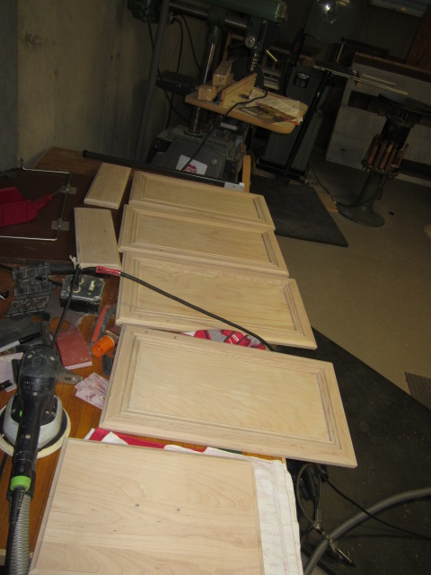

August 15, 20179 yr comment_120866 I put a DPDT switch on the wall next to the workbench that controls the circuit to the Dust Collector. We don't need no steeekin' remotes :-) I have an "extension cord' with a 120V duplex outlet controlled by a switch. Today I was using it -- the shop vac across the room was plugged into it and it sat on the work table where I was working. Pick up the sander, turn on the switch and sand away. Turn off the switch and set the sander down. Worked fine. Way less than $20 invested, especially since I re-purposed the wire on the extension cord. Another way to skin that there cat. Here's a picture of the switchable extension cord right in the middle of the photo. Edited August 15, 20179 yr by kmealy Report
