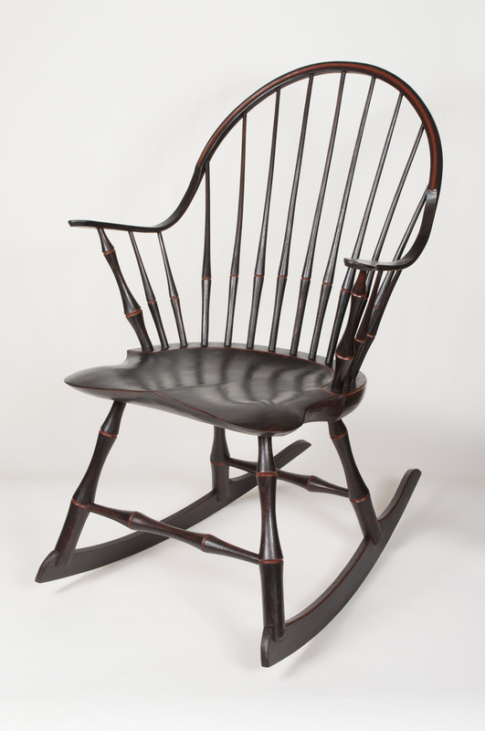

For me, this is a beautiful example of painted furniture by Curtis Buchanan Chair Maker. I love this!

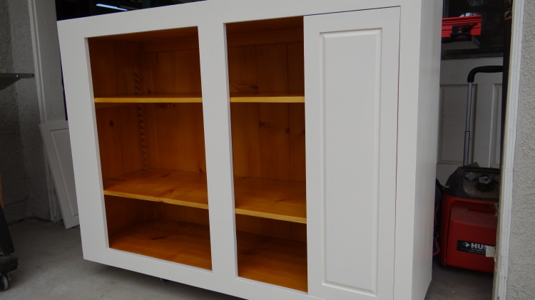

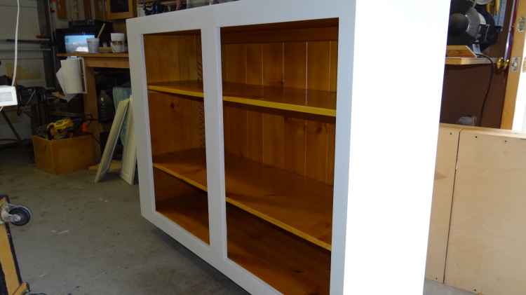

Here is my own pine cabinets I built for a customer, they look beautiful I think.
But I get it, we all have our preferences, there is no right or wrong answer or philosophy with this. Happy Woodworking!
