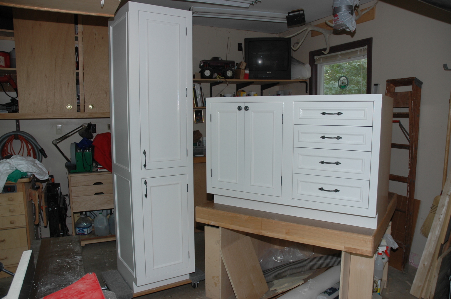

July 23, 20179 yr comment_117831 These cabinets are poplar with plywood panels, and there wasn't any bleedthrough at all. The finish is simply prime with Zinnser BIN, then spray paint with a 100% acrylic paint....Olympic brand in my case. Truthfully, any good primer will hide the wood stains. I love poplar for painted projects, it does very well with paint. The BIN is very easy to smooth out, has great sealing qualities, and dries very fast. Report
July 23, 20179 yr Author comment_117836 19 minutes ago, Fred W. Hargis Jr said: These cabinets are poplar with plywood panels, and there wasn't any bleedthrough at all. The finish is simply prime with Zinnser BIN, then spray paint with a 100% acrylic paint....Olympic brand in my case. Truthfully, any good primer will hide the wood stains. I love poplar for painted projects, it does very well with paint. The BIN is very easy to smooth out, has great sealing qualities, and dries very fast. Excellent! Thanks Fred for the great information. Appreciate it much. Report
